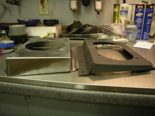

I thought to post this since I just went through the same.

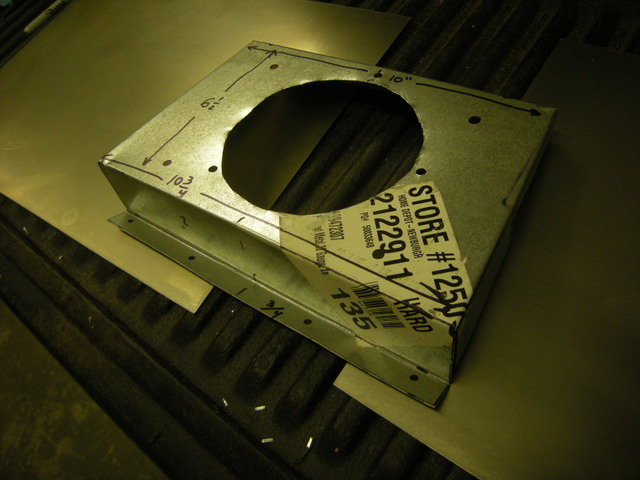

Today's newer speakers (with large magnets) won't work the the factory (cheap) cardboard mounts.
Simple enough to make a set out of sheet metal, so this is what I did...

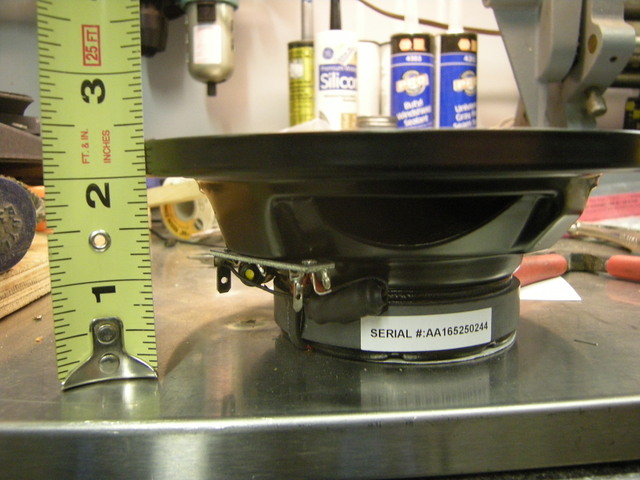

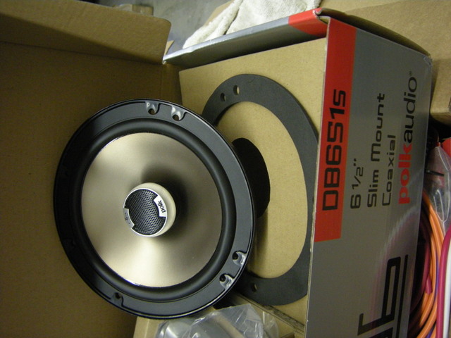

I went with these 6 1/2" Polk speakers since they have good ratings AND have a shallow (2") top mount.
...starting out...
Here is a finished housing, before paint
...a 'prototype' in case anyone is interested in measurements

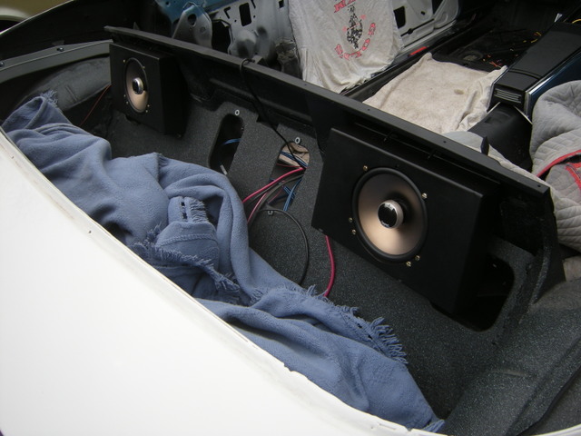

A photo showing the DEPTH change from the original cardboard to the sheetmetal mount
...speakers installed. (A factory 6x9 grill DOES cover the speaker, and will be used once the wellliner is in)
