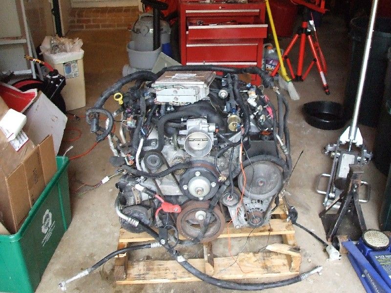

I'm using stock '99 Camaro brackets, accessories and belt, minus the AC compressor. When I get around to doing AC (probably Vintage Air GenIV), I'll probably have to make some brackets for the Sanden compressor. The stock AC compressor/bracket won't clear the subframe.
Here's a pic of the PS bracket. The bolts go thru the pump, under the pulley. It's not fun removing/installing it with the pully on, but it is possible.
Here's a view of the front of the engine with everything installed (before I removed the AC):
I've seen two different custom bracket/pulley setups for this swap. One is made by ATS, the other by S&P. The ATS kit is a hi-perf setup and includes new accessories. The S&P kit is all about chrome and bling. Both are expensive.

is it just me or does it look like the ls2 is shown with a carberated intake?
It's just you.
It is shown with the carbureted intake. EFI is coming this week.
