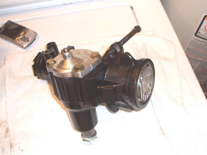

Anyone ever seen a power steering fluid leak at the output shaft on the steering box? I've got a huge leak somewhere dripping down from the pitman arm, and all of the hoses/fittings seem to be dry. Looks like it has to be coming from the output shaft. I'm going to call AGR tomorrow, but just wonder if anyone has seen this before...
AGR 12:1 billet box, about 250 street miles on it, one of the header tubes is sitting about 1/8" off the box near the output shaft and pitman arm.

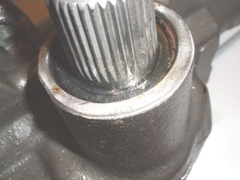

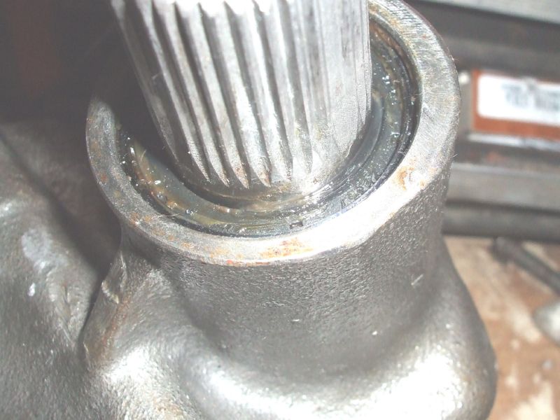

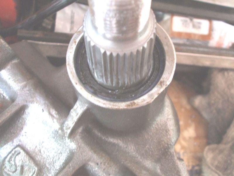

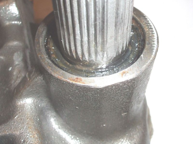

Finally got the box out this afternoon and can see part of the outer seal lookup blown out and flipped over.
It's boxed up to go back to AGR now.
