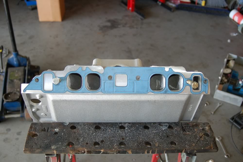

Bought an Dart hi-rise, but when it came, the directions said it needed machining for factory bb heads. Went with an Edelbrock and did some gasket matching
Before
After
Chevy High Performance magazine (Dec) had an article on a ZZ502 car with a vortec supercharger without an intercooler. The magazine claimed that on 8 lbs of boost it would make 800HP, so maybe the ZZ502 for this car with a intercooled procharger at 10 or 12 lbs will make a bit more.

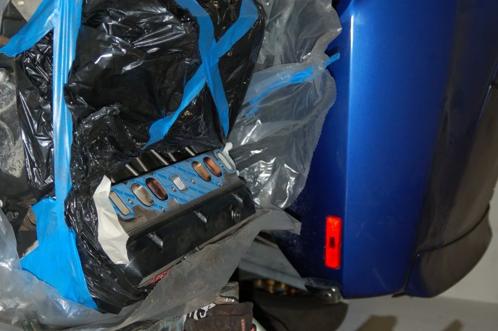

rtj..nice intake manifold gasket match.Can you show a picture of the same gasket applied to the Eddy roval port atop the zz502 and what you did there to gasket match.I only ask..because I did not gasket match my now retired performer rpm intake with the oem rectangular 840,s.I left the manifold alone..thinking the mismatch will act like a dam and aid in intake reversion issues that I had at the time.
Okay, I'll get a picture of the gasket on the heads this weekend if I'm not working. I put it on there a few weeks ago and it is a perfect match, head-to-gasket.

I was working in the garage tonight, so I pulled the plastic of the motor and took a couple of pics.
Is this what you wanted to see?
