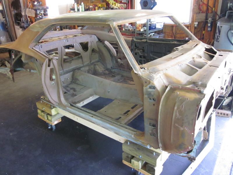

I bought this car about 5 weeks ago and I thought I would start a build thread. This may be a slow one to follow, I am not sure how fast it will go. I will do all the work myself. I had a 69 23 years ago, I cant believe it was that long ago. I drove that car for 11 years. It was garnet red. Me and my wife dated in that car. I have wanted another one for quite awhile, but they cost a lot. This one was for sale locally. When we went to look at it , I looked at the cowl tag and I said to my wife, guess what color it was, she said garnet red? I said yes. I really didn't want to work this hard on one, but I feel blessed to have it and can build it the way I want it. It didn't come with a sub frame or rear end but I have a 72 Nova 4 door parts car that I bought to use to design front spoilers for my business. I was going to get rid of it when I was done but now I will use the sub frame for the Camaro.
Today I cut the top off. It was not rusted but it was bent and warped.

Great start Randy - straight in with the cut-off wheel! What are your build plans - to recreate your "dating" car (), clone something or go pro-touring?
