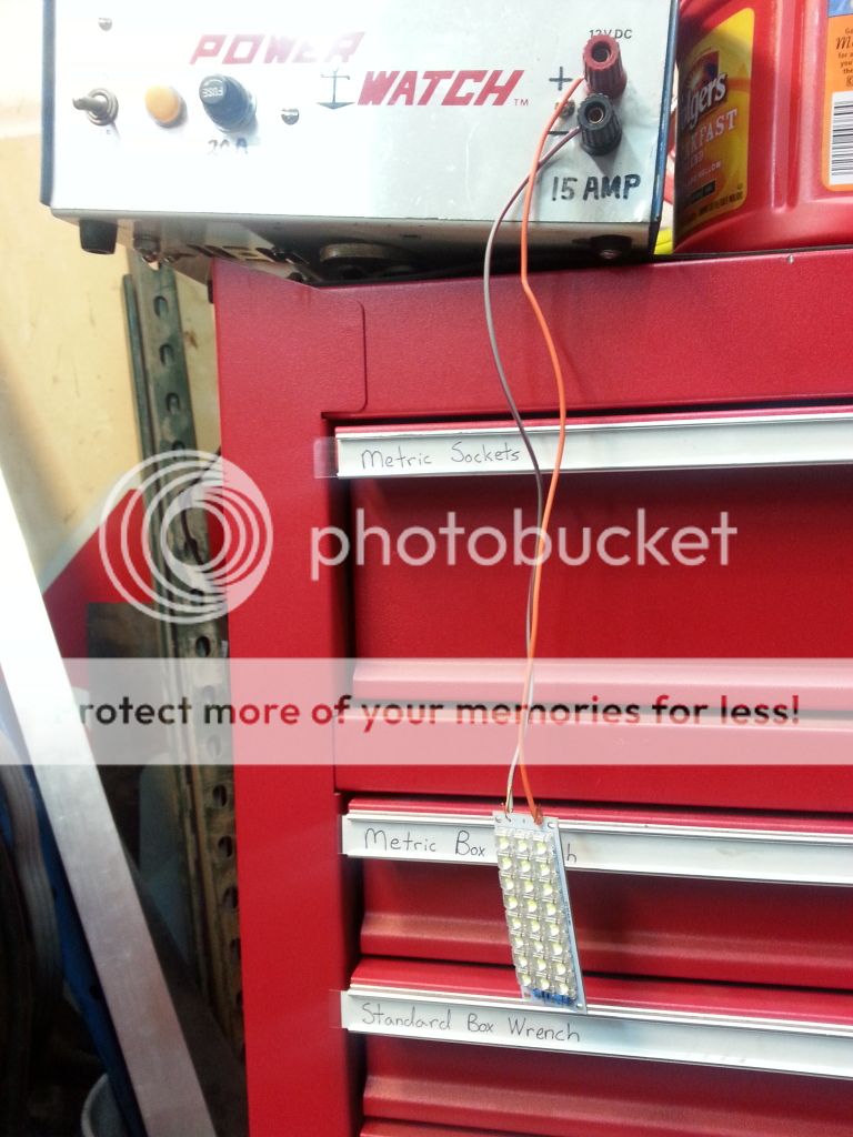

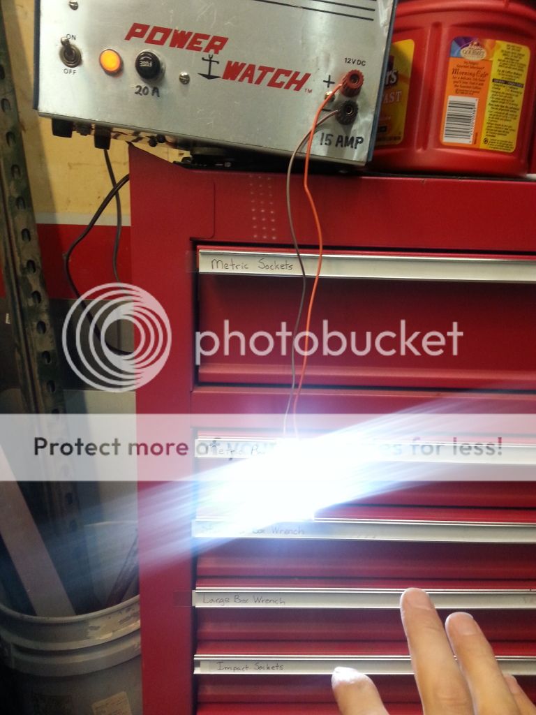

#21 ·
Still waiting on my diodes, but the housings are done..these panels are BRIGHT! I never got an answer on red or clear leds above, so I went with clear.

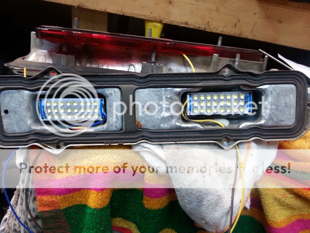

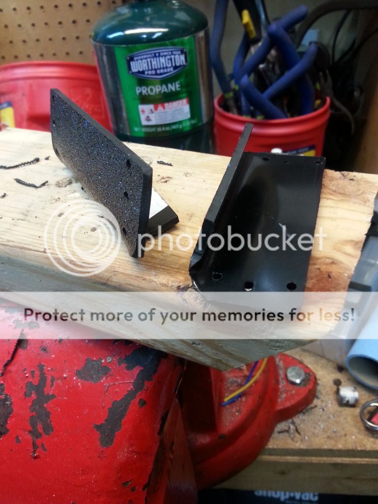

using a 12x12 sheet of ABS plastic off of amazon, I made brackets.
The panels were perfect size for the housing.
I used a hole saw to make grommets for the wires and to seal the housing
Winning.
I had initially made a panel that put the panels really close to the stock lens, and you could count the LEDS using bright spots, setting them back deeper in the housing gave it a much better look IMO

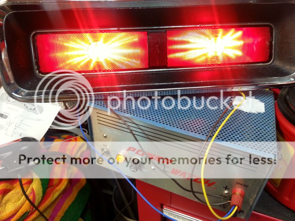

#24 ·
got everything installed today
http://youtu.be/HpxuV4kx45o
only one problem that I ran into was I cut loose the old tail light plugs and my car was a standard car at one point.
we when I resoldered the connections I hooked it up and could not get the passenger side to work tried everything possible
short version is I hooked up the wire to damn reverse light wire on that side
in my defense one wire is light green and the other is medium green
oh well live and learn
