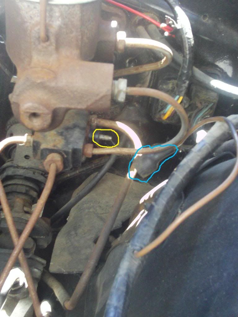

When i bought my Camaro, this Plug(blue) was not plugged in, the brake lights worked, the brakes themselves worked. So i decided to Plug it into the Inlet(yellow), i really didn't see a difference, i have a TH350 with lock-up torque convertor, i dont know if that would help.

Brake warning light, If you loose pressure in front or rear light on dash comes on.

Originally Posted by john68 View Post
brake warning light, if you loose pressure in front or rear light on dash comes on.
x2

o ok thanks so definitely plug it back in
