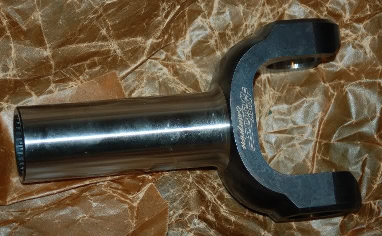

Expensive driveshaft yoke for the roller bearing in the Dedenbear tailhousing.

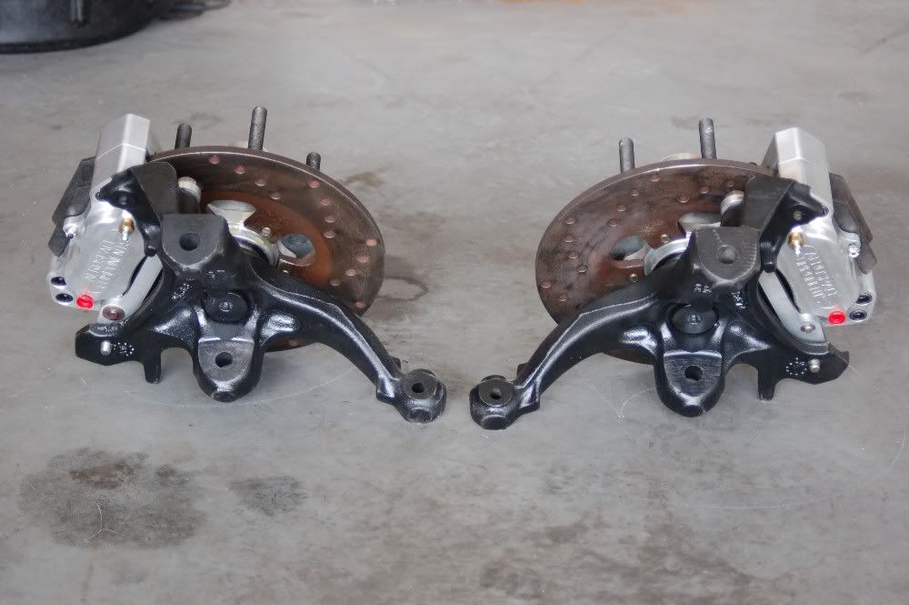

Rebuilt brakes, hubs, and new spindles.

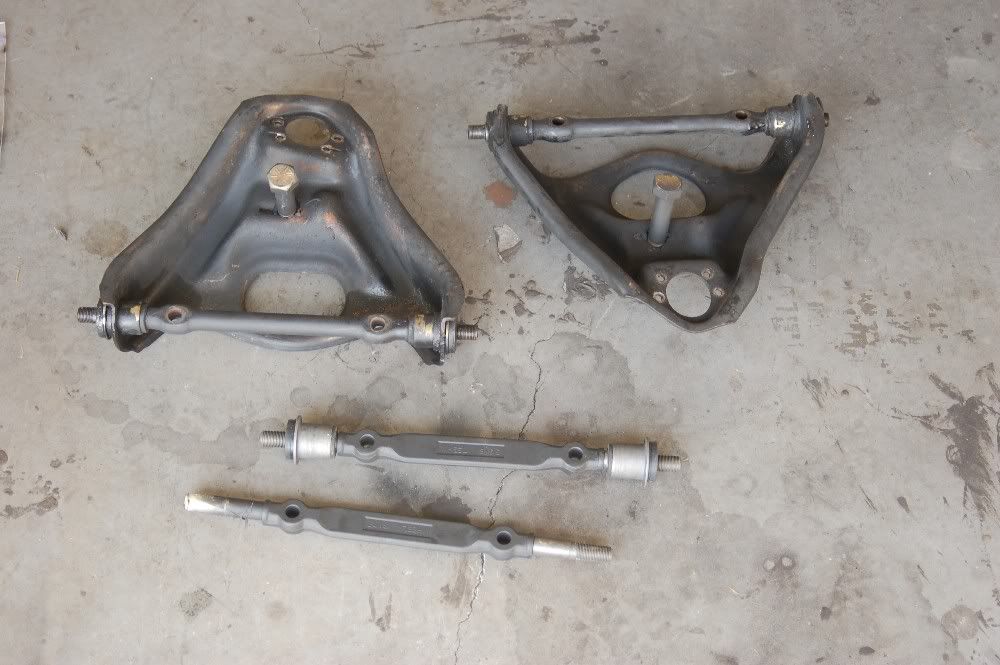

I ordered new a-arm cross shafts, but after inspection decided the ones on the car were heavier and in good shape, so they will stay.
I believe the stop-bolt is so the car picked up the front wheels early. Will probably have to remove it.

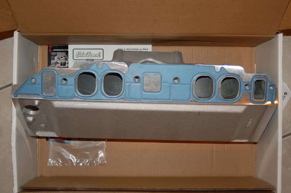

Bought an Dart hi-rise, but when it came, the directions said it needed machining for factory bb heads. Went with an Edelbrock and did some gasket matching

rtj..nice intake manifold gasket match.Can you show a picture of the same gasket applied to the Eddy roval port atop the zz502 and what you did there to gasket match.I only ask..because I did not gasket match my now retired performer rpm intake with the oem rectangular 840,s.I left the manifold alone..thinking the mismatch will act like a dam and aid in intake reversion issues that I had at the time.

Okay, I'll get a picture of the gasket on the heads this weekend if I'm not working. I put it on there a few weeks ago and it is a perfect match, head-to-gasket.
