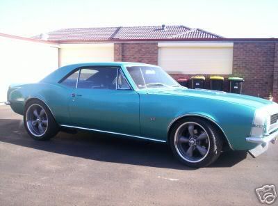

i have a 67 ss with coys 20 and 18 in wheels i would like to replace them
with a set of torque thrusts 15,s
i want the car to look like penske/yunnik cars of the day
any help would be app
here are a few pics of my ride,ps i should mention i live in melbourne australia
