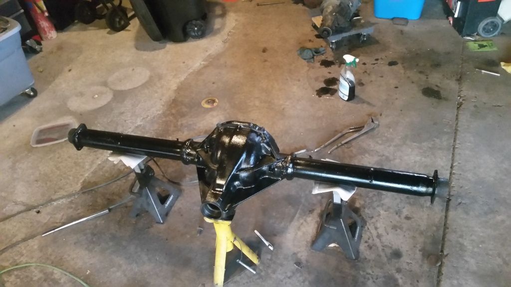

Dragged this out of a pole barn this summer in MI and brought it back to MN. This was my dads first car when he turned 16 in 1975 and hasn't been on the road since 1979. It will be a slow project but I am hoping to have it back on the road and drivable by next spring/summer. Anyways onto the pictures.
Just pulled out of the barn ready to go back to MN.
Passenger side rear quarter needs to be replaced.
Worst of the rust on the core support.
After grinding the rust off of the subframe I painted it and put new prothane bushings on.
Its starting to look like a car again as my wife says.
Front metal installed.
All new control arm bushings, ball joints, KYB shocks, and Hotchkis lower springs installed.
With wheels mocked up, new bearings installed, and O'Rileys was able to turn the original 2 piece rotors for the front.
Found the original distributor and intake in a box of parts that was with the car.
Underside in the rear of the car. Figure its worth cleaning up and undercoating before I put the rebuilt rear end back under it.
How she currently sits today.
