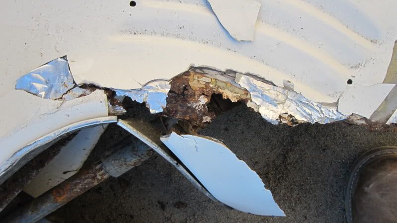

The repair that was done to this quarter by the previous shop was hysterical to say the least. It has this tinfoil type of tape all over it and bondo as thick as peanut butter, just slopped on all over the place on top of the tinfoil and rust. We got a real kick out of it.
I was actually surprised with the lack of rust on the outter wheel well as I was expecting to find hell inside the quarter. Also the rear drop off looks like it can be used, so overall happy with the results so far.

Well when it rains it pours. I just got back from the shop working on the car, only to know find out that I should have got full quarters. What else is new. I was concidering that. A full quarter will cost $300.00 more. Unfortunatly I have the 80% piece of crap already, that I wanted to send back right away. My body guy says he can make it work, and says to only replace part of the outer wheel well that is rusted around the edge not the entire piece. He is 72 and has been restoring Show cars all his life, not a repair shop. He said since I am building a driver he can make it look great with the 80%. I will discuss with him tomorrow as per the advice expressed here and see what he says. The only downside to getting AMD full quarters, Could be a few weeks for delivery to Canada, which would seriously affect the progress of the project. Also note that the drivers side quarter has already been changed and lap welded in place before I purchased the car. New outer wheel wells replaced as well. With that said, I am thinking it will be ok to have both 80% quarters. Don says he will but weld up a storm and I will never know the difference. He says if I was doing a serious resto on a serious car he would do the full quarter without question, but given the circumstances he says this is an acceptable plan. Obviously if I am smoking the pipe let me know before I make a fatal mistake!!!!
He are some pics from today.
Check out the old original quarter. I figure no matter what I do it will be a huge improvement over this disaster.
Trunk drop off, he says does not need to be replaced.
Outer Wheel Well rust
New Piece of Crap. I was told that all skins are crap and there is no difference really between all of them. I was told that full quarters are better quality. IS that true?

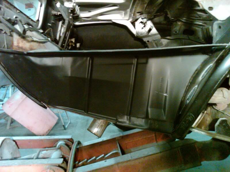

DAY THREE PROGRESS

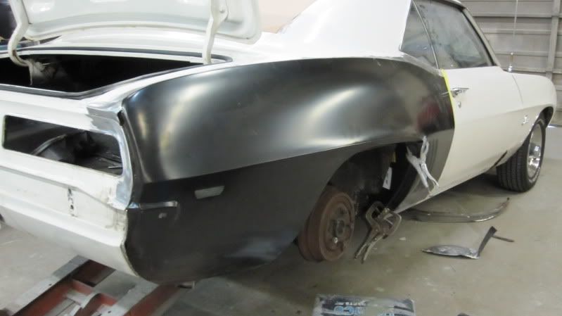

Well as luck would have it when I got to the shop this morning Don already had both the quarter and outter wheel well mocked up and cut up, so I am stuck with the crappy quarter. But I am not worried I think Don will do me well.
Here is the rough mock up. It is going to need a lot of work. Now I finally know what everyone has been talking about the whole time. Look at how high the top of the quarter sits. Dons says no problem. I guess I will see how he works his magic.
Cleaning up inner wheel well before covering in gravel guard.
Removed the factory undercoating. The only way I could remove it was to heat with a torch and scrape it off with a putty knife. With out heating it, it is like solid magma and will not budge, event with a grinder. Another trick I learned from Don today. The inside and outside of the inner wheel wells as well as the inside of the Quarter will be sprayed with gravel guard. It will act as a rust prevetative and sound deadner. I hope! The good news is that so far everywhere I have removed the factory under coating, the metal underneath is like brand new. Too bad about the other rust areas.
Salvaging the original rear drop off
Cut the outter wheel well in half for the mating
Here is a surprise I was not wishing for, but Don is calm and says it is no problem. I am learning a lot from Don and only three days into it.
Cleaning up the rear quarter seams
My new home for the next little while. A simple Goal... To Finish!

It looks like he does nice quality work. Great progress so far, and the quarter skin looks like it lines up nicely (from the pics). Always easier to judge in person ya know... but it looks great! Wish mine was that fast of a repair. Consider yourself lucky with such a solid car (comparitively speaking). It is 41 years old, so it's to be expected. I think you'll be happier than a Happy Gilmore with it in the end. (great movie by the way) :D
Thanks Todd you can live Vicariously through me if you want. Not sure if that applies to me driving my car or having a six banger, and I can live through you knowing that you are doing it the right way, we all dream of!
I am sure there will be more surprises as well as I go, as you know only to well. I hope Jeff finds a car that he can drive and be happy with. I know exactly where he is coming from. Dang, theres that damn parallel planet thang happening again!
Can't wait to see your car roasting over the coals on that fancy Roto/SS. Drool, drool... It's BBQ season!
