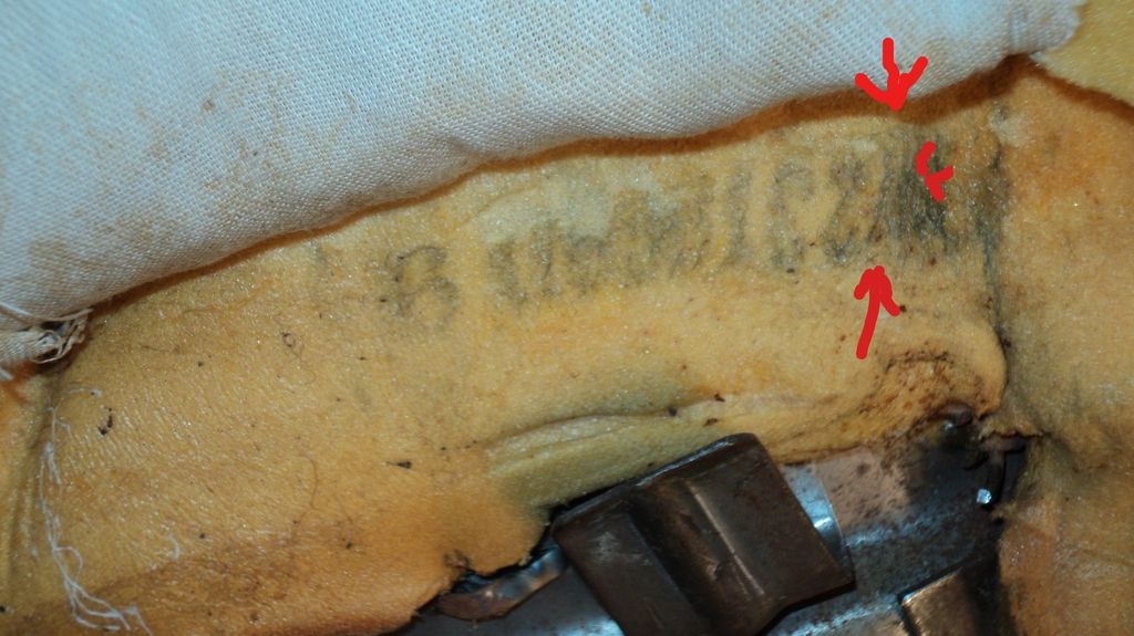

I just wanted to update the topic involving 69 GM Buckets seats with #8738440 that appear to be one off or used in design car. Heres some data based on facts. The seats with #8738440 were molded from HR(high Resillency) and were first used in GM in the middle of 1969 in Fbodys only . So far we know the only pair we have seen have been in 69 firebird although data I found said used in Camaro/Firebirds.

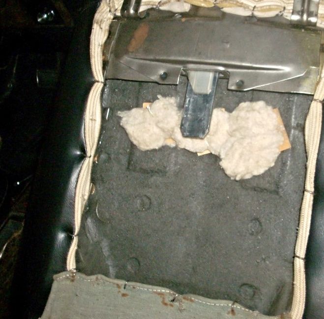

--- Gone was the burlap-cotton batting/padding and many of the small support wires and springs. These springs were now incorporated in the HR Foam seat backs in at least 1 Fbody we are aware of that has GM# 8738440 which appeared in GM July 1969 Parts Catalog.

All sorts of components could be molded in place and frames were targeted for incorporation (PICS BELOW 8738440 springs molded into seat back ).
