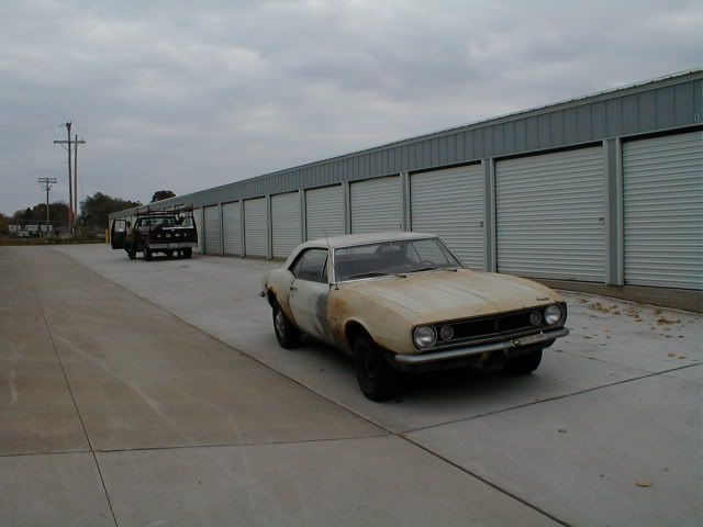

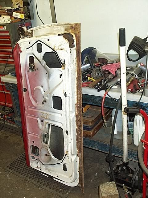

This is what I started with. The gentleman in the pics is the previous owner. I used a tow dolly to get it to
a friends shop. After a quick tune up and some brake work, I actually drove it home !! About 5 miles.

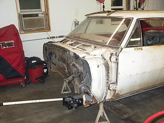

Sub frame removed

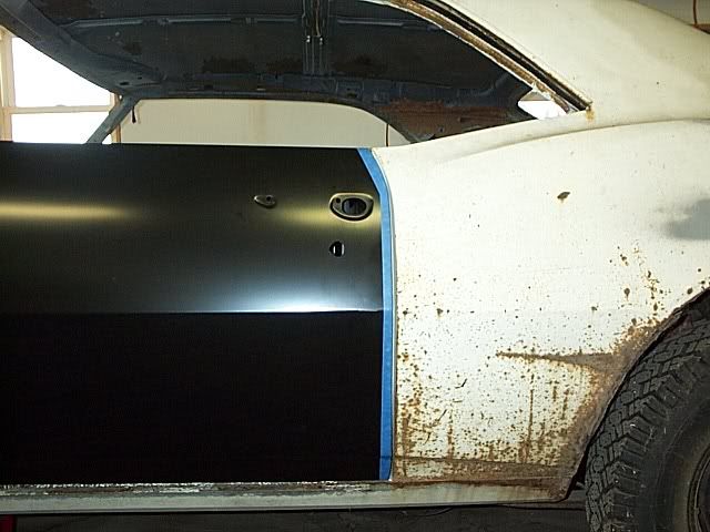

Original drivers door
New door shell installed

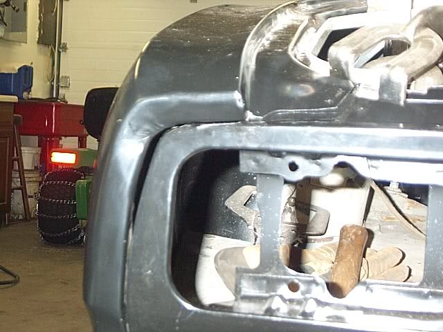

Left side tail panel current. Notice the missalignment in the weather
strip channel. Nice huh. Hooray for repops. I can push the tail panel in to
meet the weather strip channel but then the tail panel is in too far under the quarter panel
and the trunk lid (original for now) does not fit the tail panel correctly.

Wow !! Am I glad I didn't start cutting last night. I just figured out
most of the quarter to tail fitment problem is in the tail panel itself.
The damn thing is 3/8" short !!! I plain hate these lousy after market
panels. I probably should have caught it sooner. Something just kept
telling me to keep looking. So, the tail panel is going back to the
supplier. I set the original tail panel back on the car. It fits much closer.
Not perfect, but it has some damage and that's the whole reason I
decided to change it out. Geez !! Can a guy catch a break ??
Here's a pic so you see what I'm talking about and maybe help
someone out in a similar situation. Supposedly there is a company in
Michigan stamping some (not sure what) parts for 1st gen's.
Does anyone have any info on them ? The measurement I'm trying to
show is from the weather channel outer edge, to the outside edge
of the panel overhang.
Al
