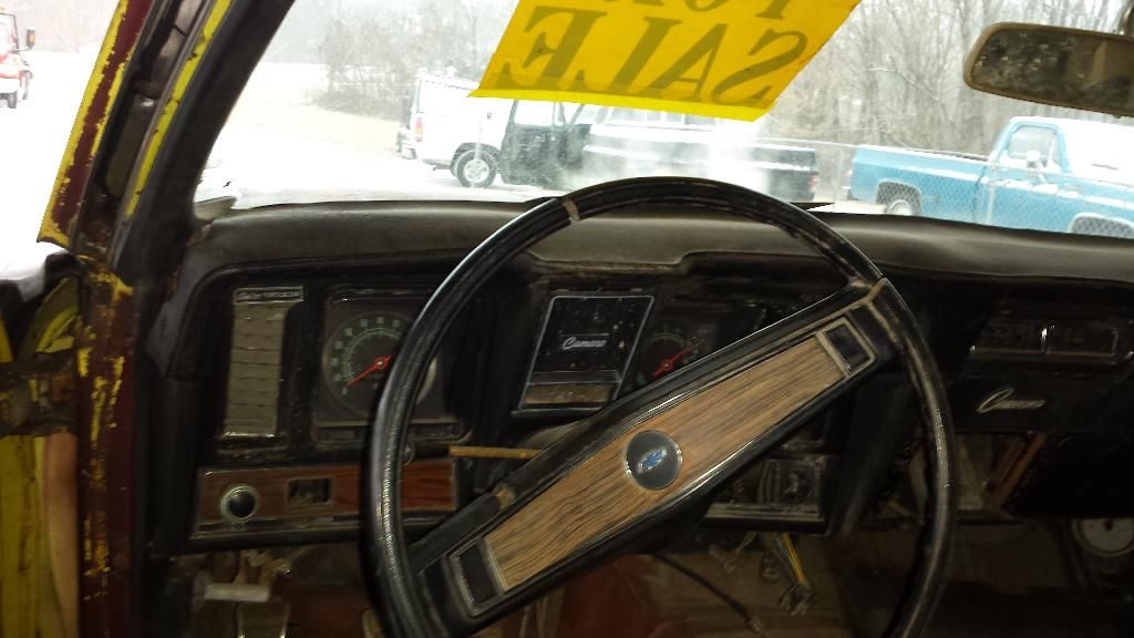

69' camaro project that's been in a barn for past 30 years (last registered in '82 in indiana), 71,xxx original miles, originally daytona yellow with black vinyl top/ strato black interior, matching number car with original 350/power glide trans (column shift), 12bolt rear with 331 gear, original a/c car, ps, pwr drum brake. came as a complete car, and tested the motor and it will still turn over. unsure with what direction i am going to take this build, but i will figure all that out once i get done with the metal replacement.

Andrew, looks like a nice project, and matching numbers too! :thumbsup:
Interesting engine compartment wiring.

yea, not sure is up with all that to be honest. since the car has sat, someone along the way has tried to "do some work to it", but was better off leaving it alone. they tried doing everything they could to just put the ignition on a switch. but as you can see, it is haggard as all get out.
Yeah good save and if an LM1 worth bringing back as born IMHO.
2,311 Posts
Good start. I agree to look into the LM1 possibility. If you need another opinion drop me a PM. I'm 15 minutes up the road and been messing with this old junk since the early 70s. PS.. the jack hook is wrong... lol :beers:

Andrew, you might want to check out this article: http://www.camaros.org/lm1.shtml
From your pics, I think this car is an LM1. It should be a 350/255 with a q-jet. Looks like power drums too. Kinda rare :) good score!
it is an lm1 car.

literally brought it home and started taking pictures to start the build documentation. didnt even bother with taking writing off the glass. its already in my shop being torn apart.
Welcome, Andrew! If the drivetrain is all original, it sure sounds like a LM1. What part of Indiana did it come from? Check here for how to decode everything: http://www.camaros.org/drivetrain.shtml
