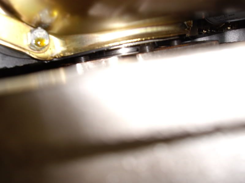

Got an update on the engine noise. Looks like those of you who suspected the flywheel bolts are correct. I took the dust plate of the bell housing and sure enough atleast one of the flywheel bolts are longer then the other and are poking the rear main seal. So this would explain the oil leak in the rear of the engine in a brand new engine as well. I feel bad not checking this clearence when I put the fly wheel on, just figured the guy who built my engine, sold me the new flywheel and the bolts to go with it would have sold me the correct stuff.
So looks like Im going to pull the engine and tranny again to replace this bolts as well as replace the rear main seal and inspect the oil plan to make sure nothing else is damaged. I took a pic from under neath the car, its hard to tell in the pic but the bolt on the right of the screen is clearly larger then the other two that you can see.

I wonder - do those bolts use washers and the one bolt doesn't have one? I used the ARP bolts. Good luck. We get good at doing some of these jobs more than once!
FLywheel bolts are "special", big thin heads and no washers. (automatic trans flexplate bolts have star washers I think, been quite a few years) Factory bolts have a glob of red threadlocker on them so they don't come loose. Get a new set form your dealer.

Also you might want to double check your flywheel bolts,from the photo it looks like they stick out about a 1/4 in., thats longer than I've ever seen.
