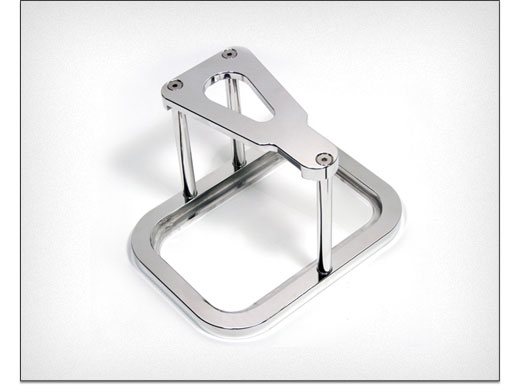

I am in the process of getting the car ready for the strip, and I need a battery hold down. The battery is in the stock location. I have been told to use a flat steel bar with 3/8 inch threaded rod, but I am looking for something that will look better.
Will something like this be legal?
I am not sure if the bolts need to be 3/8 inch or if the rods on this will meet the requirement. I have looked at JEGS, and they seem to offer stuff similar to this one (like billet specialties). Any advice would be appreciated!!

Contact the tech official at your local track and see what he/she says. looks good to me.

If in stock location...I think that'll be fine. But as always, check with your local track.

The first sentence (of the rules) is why I asked if you were keeping it in the stock location, if so it just has to be securely mounted, meaning not loose. The stock hold down is fine so the one you have pictured would be more than enough. If putting it in the trunk then things get a little more complex.

Thanks so much for all the replies, I read the rules several times and it seemed to me like OEM hold down would be allowed, otherwise 3/8 rod is required. I emaild my local track at Doug's suggestion they got right back to me and said that hold down would not pass, 3/8 rod or bolts are required.
Thanks to Al and Royce for the pictures. I am going to make something like BPOS and have it powder coated so I will have no question. Thanks again for the replies and help. I hope to get this car going and get my first 1/4 mile in before the summer is over.

4,274 Posts
I tried to get this version to fit in the stock location in my '69....the base was too big and interfered with the inner fender.
I sold it to a friend of mine and he installed it in the trunk of his '67 Camaro alcohol injected drag racecar.

1 Posts
Just got that same exact one, base is too big. Hits on fender. You'd need to fabricate a piece to secure it to also. I was misinformed before I bought it.
