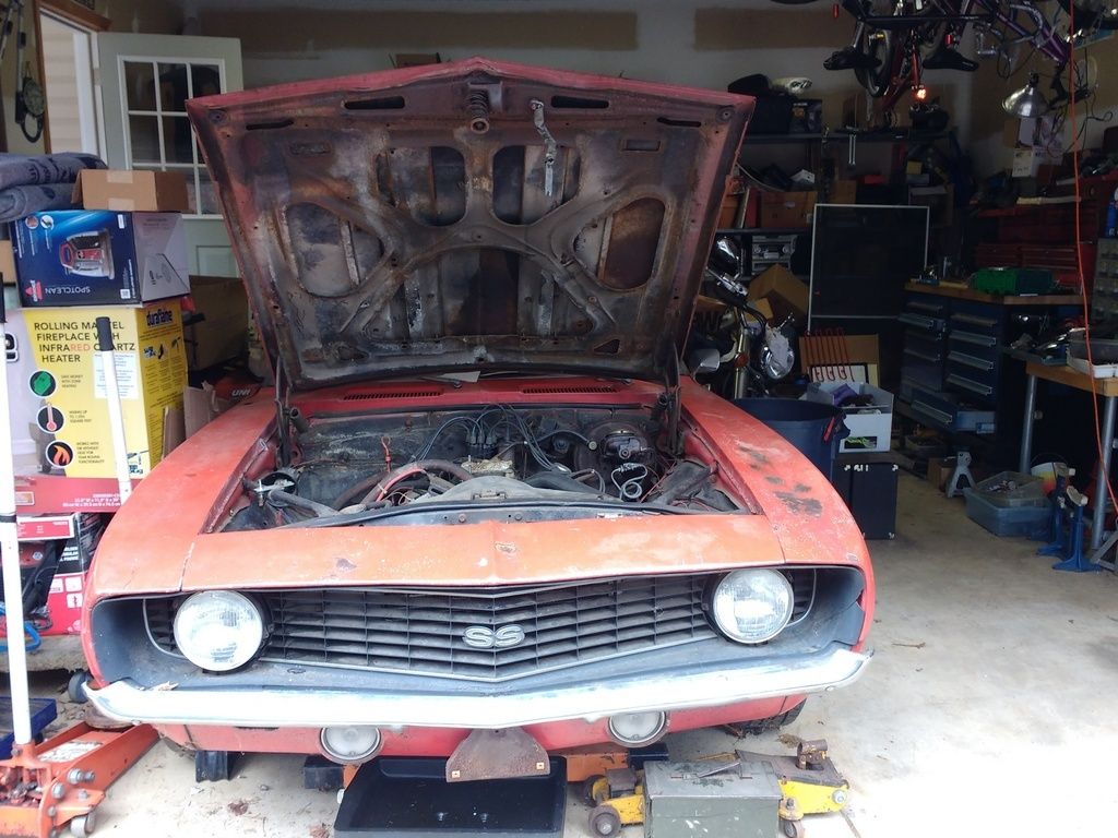

I'm happy with the progress this weekend. The holes on the subframe under the radiator support look great. Tabs on the support, not so much. After this pic was taken the nose came apart. Most of what I am doing is mental. How am I going to pull this off? There is so much to do. I keep trying to think it through.
