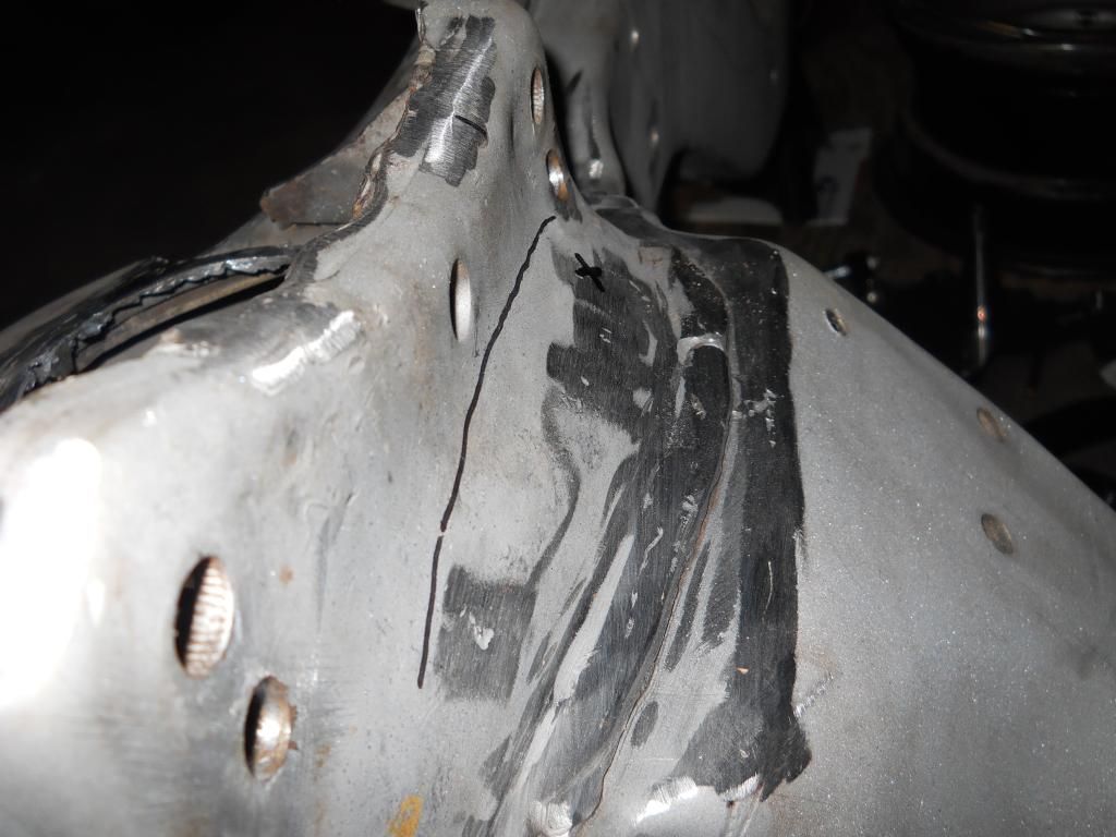

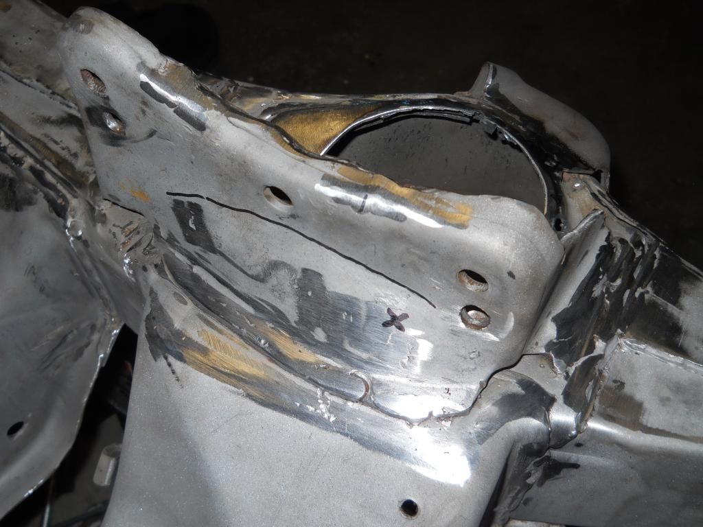

I have a question about the Guldstrand Mod for those that have done it. I am still not 100% sure if I'm doing the G Mod yet, but I'm drilling the holes so I have the option. When I mock up the upper A arm in the G Mod holes, my A arm hits on the mount and won't mount flush. My question is, do the shims installed during alignment take up enough space to prevent it from hitting the mount or do I have to dimple the mount where it curves out? In the pictures you can see it hits where the "X" mark is and I marked where it curves out.

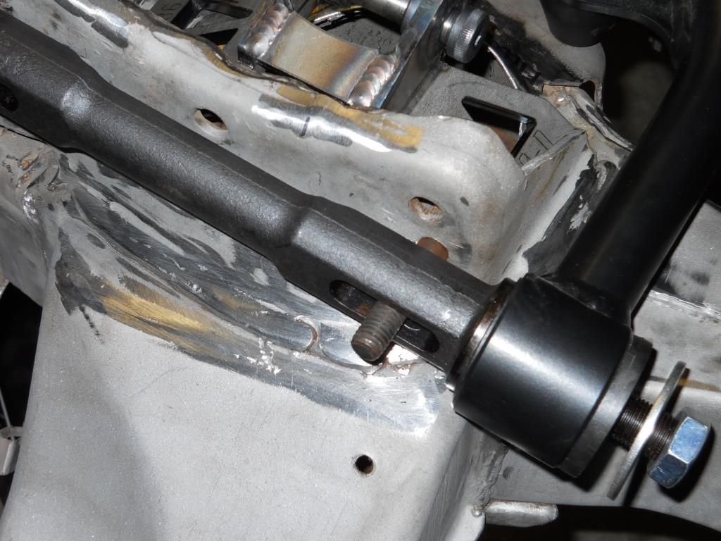

Question 2, what side of the Ridetech A arm shaft faces the mount? Do I have the A arm shaft in the correct position in the picture?

Fit there varies a lot car to car. Usually you can take a 1/8" shim, trim the length down and just leave it up against the bracket. Your bracket looks worse and I'd heat and flatten below the hole a bit to help it out.

Thanks for your replies. I scoured the net for info on this and only came up with one picture where someone flattened the mount bracket. I was starting to think I had done something wrong. I've done hours of research on this so I don't mess it up, but nobody said they had to do this. Right now I would need about 3/8" of shims on the back bolt to fill the gap. Right now it's only hitting where the "X" is in my picture, so I'm hoping I won't have to dimple it too much.
