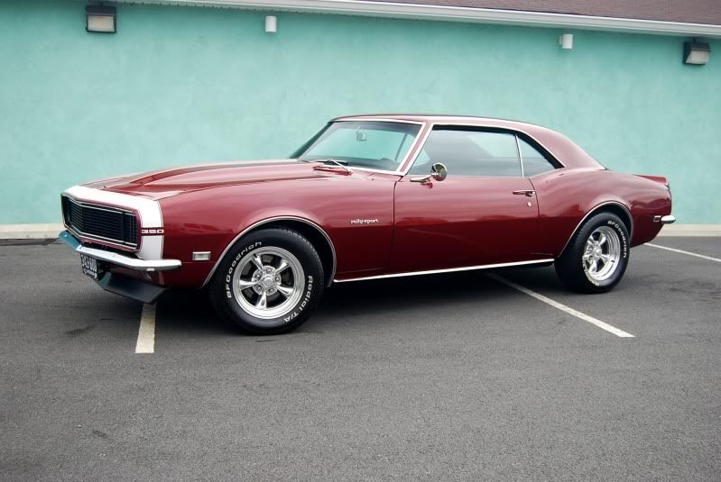

Hello everybody, I've been lurking on this site for some time and after some searching, I decided to buy this car from Virginia. I'm currently awaiting its arrival to Finland where I live, so I haven't seen the car myself yet. You can also get prepared to hear many questions from me in the future as I'm new to the Camaro scene (have played with Corvettes mostly) :)
I already have a few questions about '68 RS' trim. I was wondering which car's came with the wide molding below side windows that my car apparently doesn't have? I've seen many cars with them, and some without.. And did all RS camaros come with the three piece lower panel moldings?
Style Trim option Z21 and Rally Sport option Z22 both came with the wide belt moldings below the side windows.
Only the Rally Sport option Z22 came with the 3 piece lower moldings.
Your car is missing the molding below the windows, and has the non-RS rocker moldings, so there is a strong possibility that is not a factory RS.
