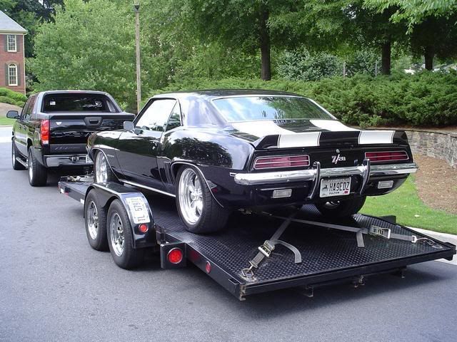

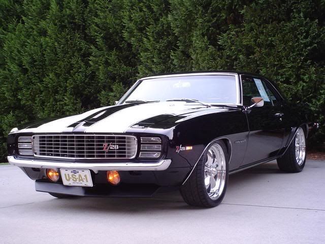

I like the look of this car & wanted to run a similar set-up. Please give me your best guessimates. I finally learned how to post pictures!

My guess is 19s on the rear and 18s on the front.

I'll guess 18s front and rear. Now the hard part (the black trailer does not make this any easier) 7s in the front with 225/45s and 8s in the rear with 245/45s. This does not look like a max package to me. It looks conservative but there is really not a good picture to go by. As stated above no TTIIs in 19s.
26,644 Posts
From the side view (1st pic) in paintshop the wheels are 2 different sizes. My guess is 17's up front with 40 series tires and 18's out back with 45 series. Anything 17" and 35 series is too short IMO. I'm thinking 245/45-18's out back and 235/40-17 in the front..
If they are 17's up front that car is about 2 inches lower than my car which would amount to a 4" drop up front and 3.5" drop out back.

I got in touch with the former owner of this car & found out the sizes.
Front: 18 x 7 235-40-18
Rear: 18 x 8 255-45-18
(Dennis, I guess the front tire is a little turned so that could account for the paintshop difference)
Thanks all for your help. One more question, isn't a 235 tire a bit tight on a 7" rim? Does this have any adverse effects?
Jack you were really close!

235 on a 7" is not a stretch at all... I bet 80% of the '69s running 15"x7" rallys have 235s on the them.
I should have caught the wheels being turned some Kelvin, when I zoomed in on the wheels in paint shop I couldn't explain to myself why the trailing side of the front tire had a larger sidewall than the leading side. I wrote it off as distoration from zooming in...
Sounds like you know what to run now, your car will look killer with that combo...
