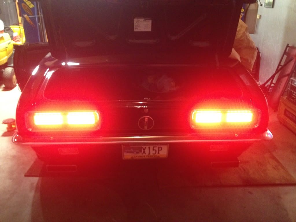

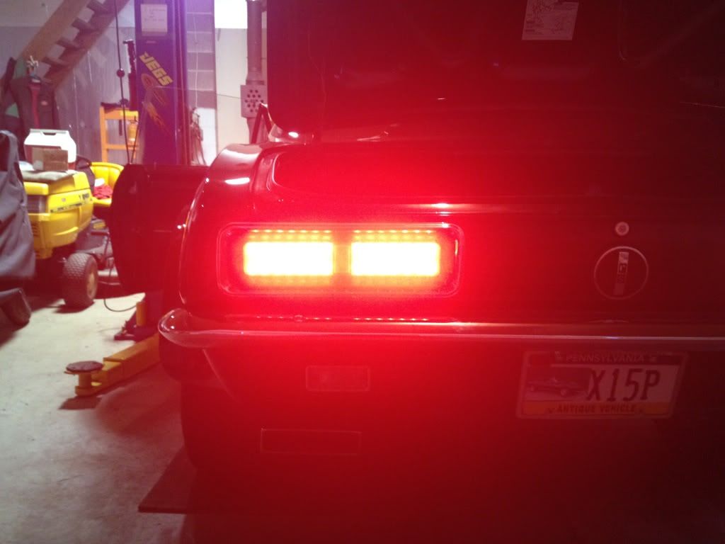

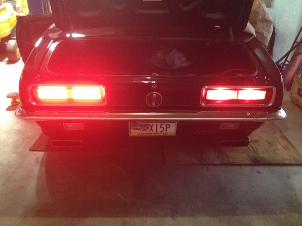

I purchased LED style lights for my 67, not the bulbs but the ones that replace the whole lens. They were a great fit and went perfectly into my new bezels. After securing them in place using the existing cover it's as easy as plugging the lights into the stock harness. I did need to change the flasher with a replacement EL12 electronic flasher from Advance Auto ($12.99) however. I was looking around to see what people did and figured I'd put it into one simple thread. Here are some pics (not super quality, they are from my phone):
With only left side in:
Both:
:beers:
