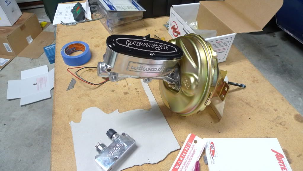

Here is the Hurst Line Loc

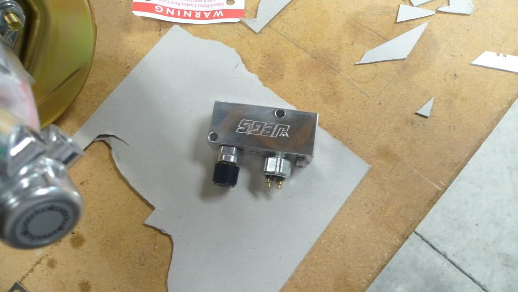

Adjustable Valve with integrated brake light switch

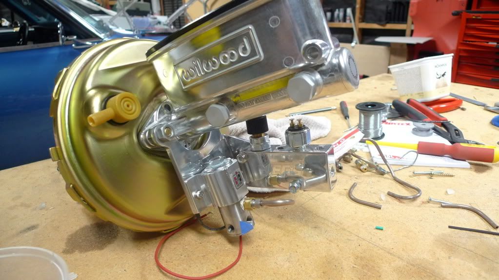

Here is the new Booster and Wilwood cylinder

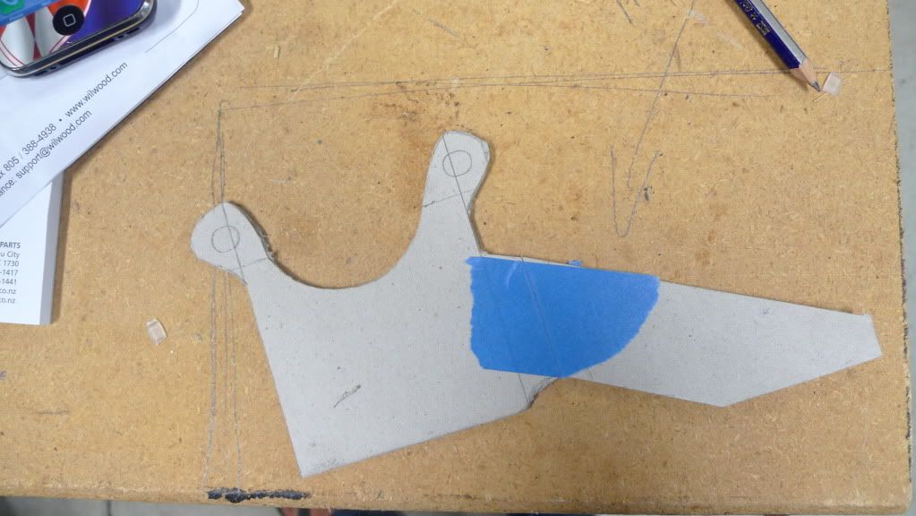

First I made a cardboard template to gauge what I can fir without running interference from the inner guard

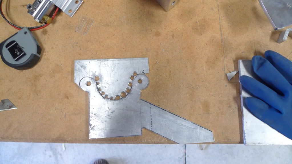

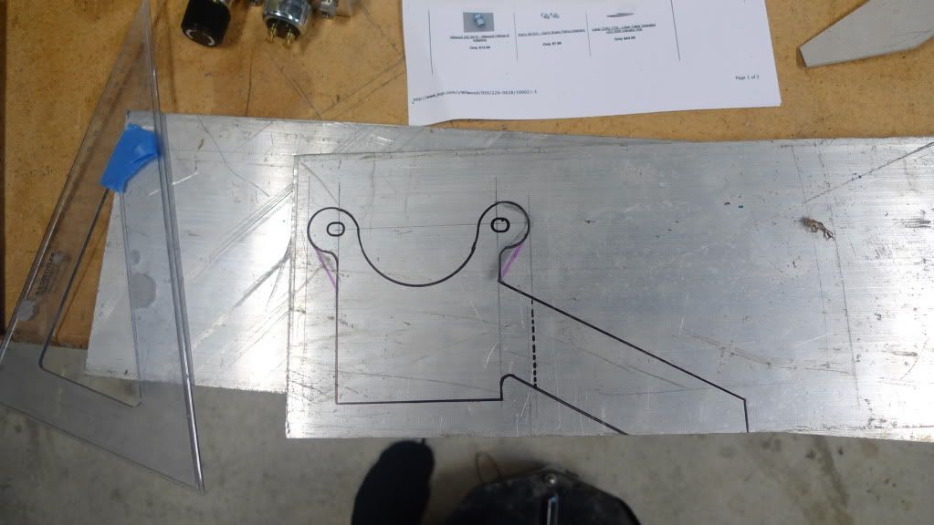

Transfer basic shape to 6mm Aluminum
Using a drill and a Jig saw I cut out the basic shape

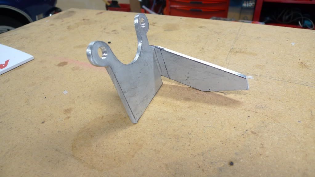

After a little work with the file I put it in the vice and bent the vale support

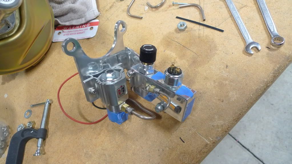

Bolting up the units for a test fit before polishing the bracket

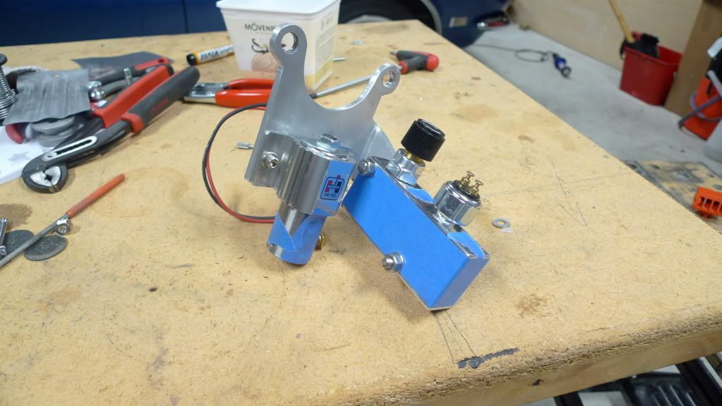

Bolted together and starting to make the brake lines

What bore size did you go with.Dont let any one talk you into DOT-5 fluid Wilwood doesn't recomend it at all.I found this out the hard way.
Thanks, I ended up going with the 1" bore after recommendation from the brake specialist, I suppose time will tell if his calculations were correct, I can swap it out if I'm not happy, Thanks for the tip on the DOT-5 fluid, in New Zealand most if not all fluid is DOT-5 so would have probably put it, not knowing.
