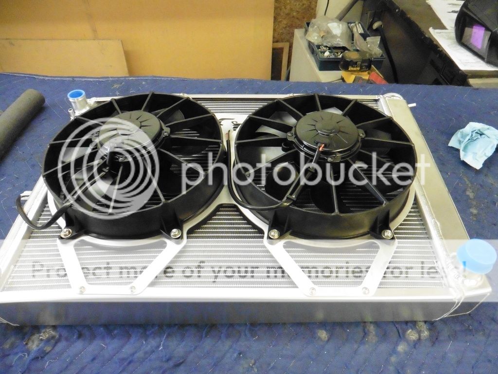

I bought a radiator for my car. It was made by C and R racing and its model number is 15-11010. They advertise that it is for a first generation Camaro/Firebird that has an LS engine.
This is my problem. The hose inlet and outlet are not on the same side. :surprise: I guess that I could run the top hose from the driver side over to the passenger side. I am afraid that I could run into some interference problems and it would look cobbled together.
Has anyone on this website run into this problem? How hard was it to fabricate something that would fit? The radiator does not have a shroud so the top hose could fit low. The second photo shows a piece of pipe insulation where the hose could be routed. Any help or suggestions would be greatly appreciated.:smile2:

If you are running an LS3 crate the water pump outlet is such that it really doesn't make a lot of difference which side it is on. C&R made a custom radiator for me with transmission, steering and oil coolers in it and the connections are the same as yours. I am not worried about it.
Don
14,272 Posts
Yes it will work. You'll need to take the hose routing into consideration when you do your cold air intake

Although not the prettiest idea.....it works just fine for me. I tried to keep it as easy as I could with off the shelf parts incase there were ever to be an issue on the road ;)

Personally, I would return it for the correct radiator. You will have construded angles and bends if you are using a CAI that will feed from the drivers side.
4,636 Posts
Without knowledge of what water pump the OP is using it is difficult to gauge the magnitude of this potential issue. Corvette LS3 water pump for example would be likely better than the truck water pump shown above...
I have an LSA and a similar radiator from C&R and I am confident it will work fine. The devil is in the details of the application.... These radiators are highly efficient racing radiators with extruded cores and are worth a little head scratching to implement.

C&R radiators are the best bar none. They build for NASCAR. Not cheap. The one is used in my LS7 car sells for $1800. I got a deal and took the display home at SEMA.
As stated the devil is in the details. CAI. Hose runs etc
14,272 Posts
I got a superior radiator off of Ebay. $540 + shipping. I am happy with it. Fans work great and seems to cool really well in the limited time I have used it.
I've used this radiator in at least 10 cars both LS and SBC with AC even with blowers. Here in the crazy hot desert they always keep cool, look great and never had a problem with a single one.
