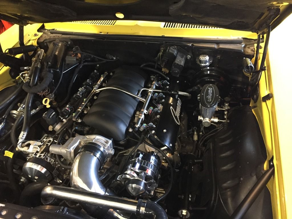

So I did finish my engine swap from a ramjet 350 to an LS3 480 / Tremec Magnum 6 speed. Overall with the Holley Ls3 /tremec swap kit: cross member, oil pain, engine mounts etc. I had only a tiny bit of trimming of the hole to the tunnel. I know what everyone has said that I ABSOLUTELY WILL HAVE TO CUT UP THE TUNNEL to get the Tremec 6 speed in place, but I really didn't. It fit right in and I used my stock center console and everything. I did go to a Dakota Digital Dash. I have to say it went pretty smoothly. I used the clutch and hydraulic kit from American Powertrain. I did have to have my driveshaft cut and balanced. I also put Wilwood brakes all around and Ride Tech front end. It came with a 2 inch drop spindle and I'll be curious as to how it handles differently.
Overall not a cheap mod but I'm excite to see how it runs in a month or so when it warms up. I have been out briefly breaking the engine in and it is/will be a monster!!

The old engine taken out and gave to a friend!
Tangled mess of wires, some are now rerouted
Here are the mounts for the new engine in place
New wiring harness with some wires tucked away now
There She is: March Performance accessory system
right before engine placement
right after she was shoehorned in
ended up taking the quarter panel off for access and placement of the computer

Bottom view with the tranny installed
Hole in the same place as prior, just sealed it up
Wilwood brakes
Dakota Digital dash and console
custom fan mount
tried the flexible stainless hose at first but looked like a vacuum hose :{
I'm now putting together a custom logo on some Eddie Motorsports coil covers.
I made the radiator hose from exhaust tubing and 90 degree hose
