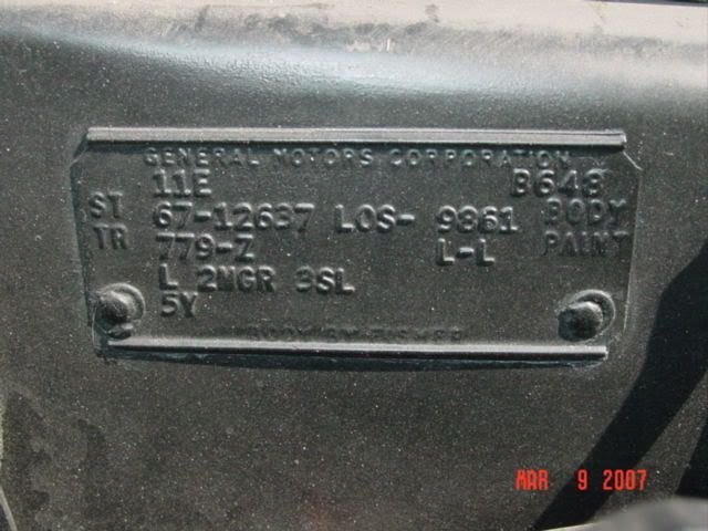

Decode please. Vin reads as follows:
124377L123xxx

It looks like a well optioned 67.
The trim tag indicates it started as a Tahoe turquoise rally sport with a deluxe turquoise interior, deluxe seat belts, fold down rear seat, powerglide with console, rear seat speaker, and Z23 interior trim.
My 67 is also an 11E LOS car. There were only 3 working days the fifth week of November 1966. The bodies on our 67’s were built during those three days. They could have been built on the same day!
Would they have also put 11E on the cars built on the 1st and 2nd of dec.
Then start 12 A on the first full week. I'm not shure how they did the split weeks the is the first time I saw any mention of something like this.

What a pile !
1 = Chevrolet
2 = Camaro
4 = 8-cylinder engine
37 = coupe body
7 = 1967 model year
L = Los Angeles, CA assembly plant (Van Nuys)
1123XXX - this the wrong length. Should be 6 digits.
Decode for body number: 009861
11E = Built the Fifth week of November.
67-12637 = Custom Interior Coupe.
LOS = Built in Van Nuys California.
779 = Custom Turquoise Bucket Seats.
Z = (A50) Strato Bucket Seats (without headrests).
L-L = Car Color is Tahoe Turquoise
B648 = internal plant scheduling code.
Options:
1L = (A67) Fold-down rear seat
2M = (M35) Powerglide Transmission
2G = (D55) Console front compartment
2R = (U80) Speaker rear
3S = (Z23) Interior Decor group
3L = (Z22) Rally Sport Package
5Y = (A39) Belts All Deluxe

Sorry ... my bad... it's 123xxx --- 6 digits. Turns out my car was born on December 7, 1966... Pearl Harbor Day. so, does this mean its a "bomber" lol. It's 40 cars away from Farmboy's. His decipher is that this car was in the plant at the same time his was. He's might be coming over Saturday. If he brings his car, we'll just lock them up in the quiet of the shop together so they can catch up on the good ole days :)
