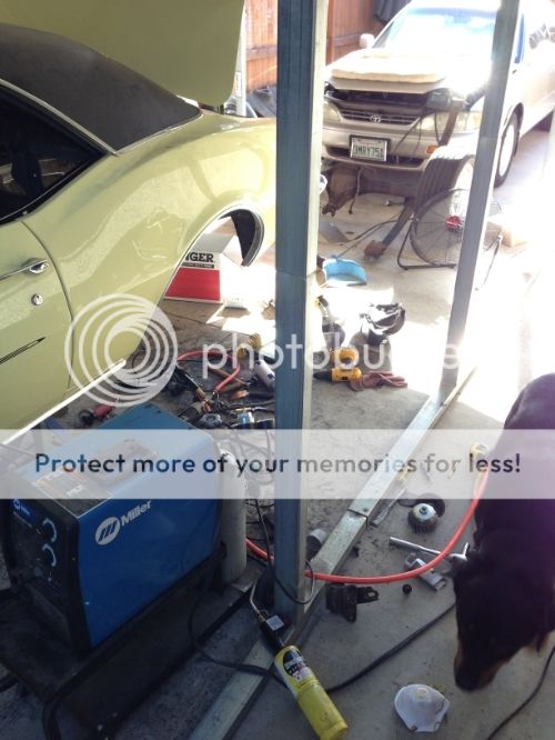

I didn't document as well as most of you did with pictures,but I have a few.
This car was originally a powerglide car and was a 4spd conversion.

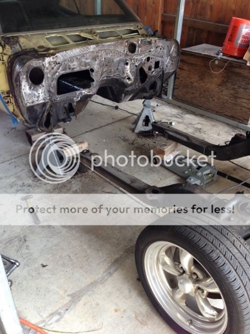

I started by selling the 327, clutch, M-20,10 bolt rear end, driveshaft, subframe with GM discs.

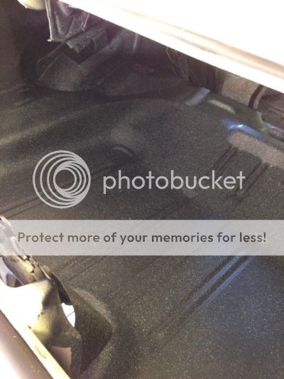

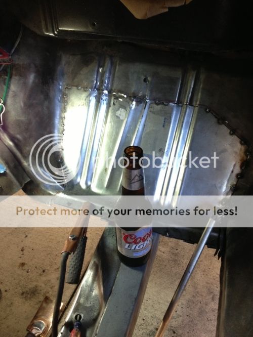

I fixed some floor and trunk rot, passenger side shock tower,cut and patch some areas on the rear inner fenders.
It's floors are now solid and rust free, I used the silver POR15,seam sealed and put the fat mat sound deadener down.

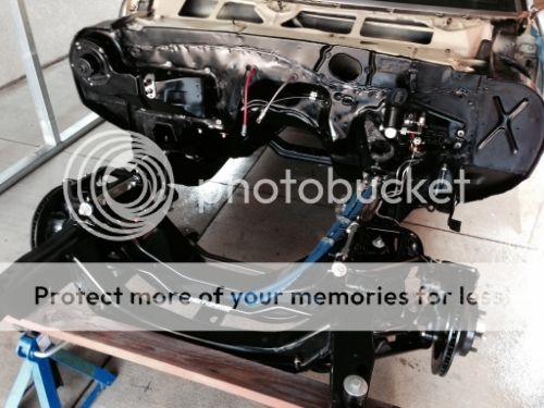

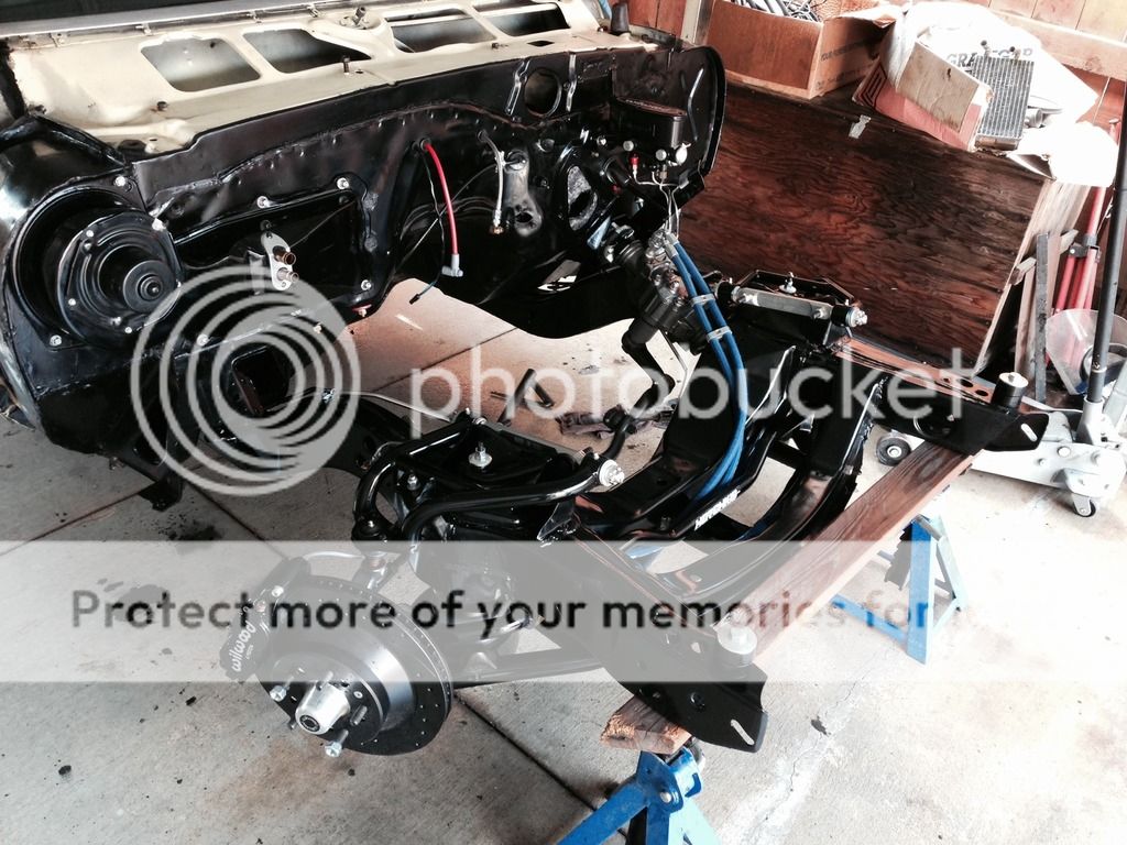

Powdercoated 9" rear with 3.50 gears, 3" narrower. with disc brakes.

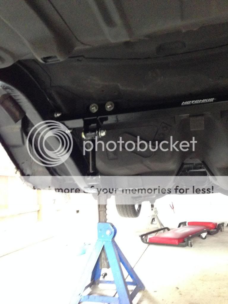

Hotchkis TVS system and frame connectors, 3" drop all around.
Global west A arms with tall upper ball joint, global solid body mounts.
Front willwood 12.88" 6 piston discs, manual master w/ 7/8" bore
Rebuilt and powdercoated the subframe

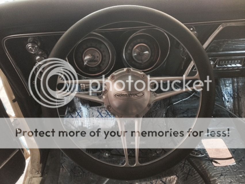

GM tilt steering column from GM Tilt. Budnik wheel
Newer late model power steering unit "iroc"
New fuel tank
Stainless fuel and brake lines.

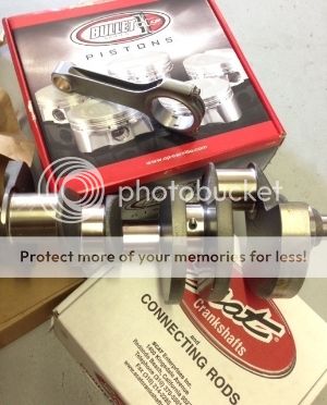

Working on the old school 421" engine build now, built on a Dart SHP block.
Scat forged rotator, H beam cleranced rods. Hyd roller.

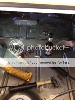

I doesn't take long to make a mess
I did'nt cut back too much on the beer I guess.

Are you going to run a radio? Might get some "noise" through it with the MSD being that close by
I definitely thought of that while installing the ignition stuff, the stereo is way down on the priority list as far as function,I'm sure It would rarely be used if at all, I did run all wiring as best I could to minimize any buzz or rpm whine.
Even though I have some nice audio gear laying around that I planned on installing,JL 12" W-6, ARC Audio amps... Using the glove box for electronics is more important to me, also have a tach adapter mounted in there.
