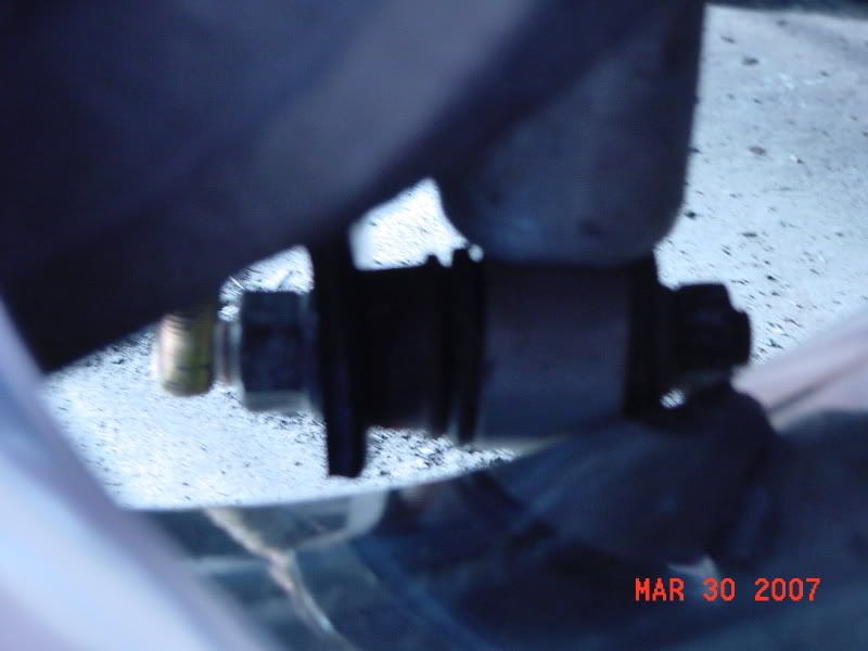

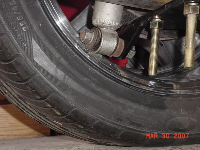

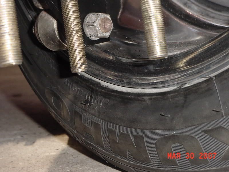

First I think the block is too big and it looks to me like you have the wrong shocks for the multi-leaf shock plate. My shocks have a stud that is built into and through the bottom eye that is flush with the eye on the wheel side, nothing protudes out towards the wheel.
I cut them down 1/2 inch and still have the problem If my shock was mounted without that little spacer I would be cool. Does anyone have some pic's of the proper shock on and off the mount. Thank you

Discussion Starter · #17 ·
Thank you.... I think I will need to go with 1 inch blocks because even with that correct setup I can tell they will still hit.... Thank you for the Pics that helps me a lot
