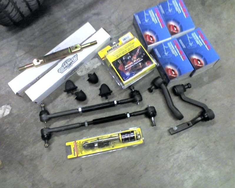

I have just piled everything except my new springs in front of my Newly Powder coated Subframe. What I want to know is when my Drag link comes back from the Media Blaster, Should I paint it, or leave it natural. Would it look tacky to paint it and the tie rod ends black to protect them from the weather? The Calipers are back from being sleeved and rebuilt, and I was thinking about using the VHT Caliper paint on them also. They are Factory four piston calipers. I intend to drive my car on the road. Not use it as a trailer queen. It won’t see the snow, but it may see the rain. I am not really worried about keeping everything factory, I really want it to last better than factory. By the time it is done, I will have more in it by many times what it cost new. I am looking for opinions, and for the devils advocate. I welcome all and any opinions.
