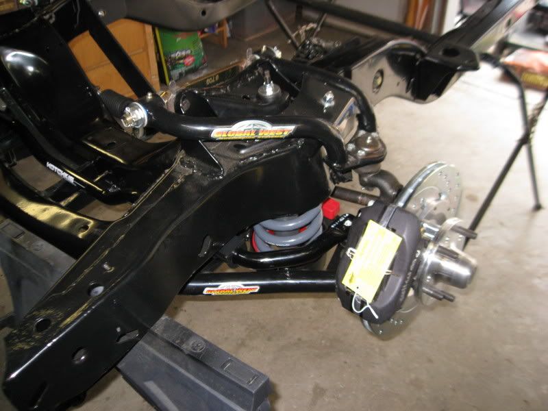

While it was out I worked on the subframe:
