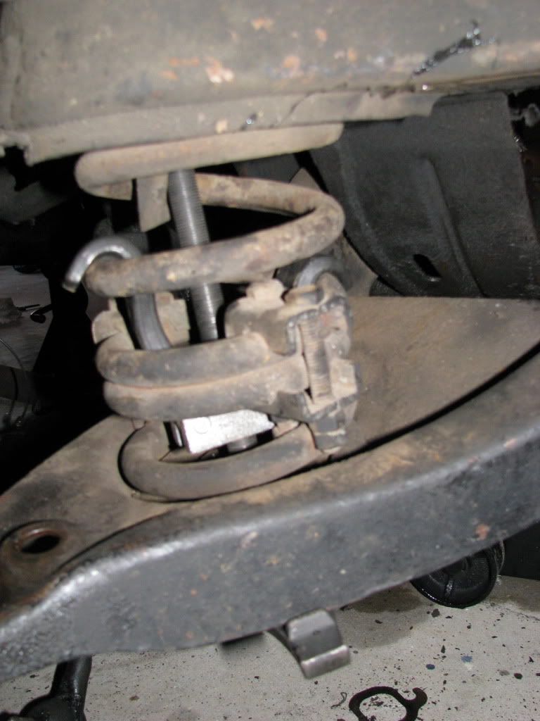

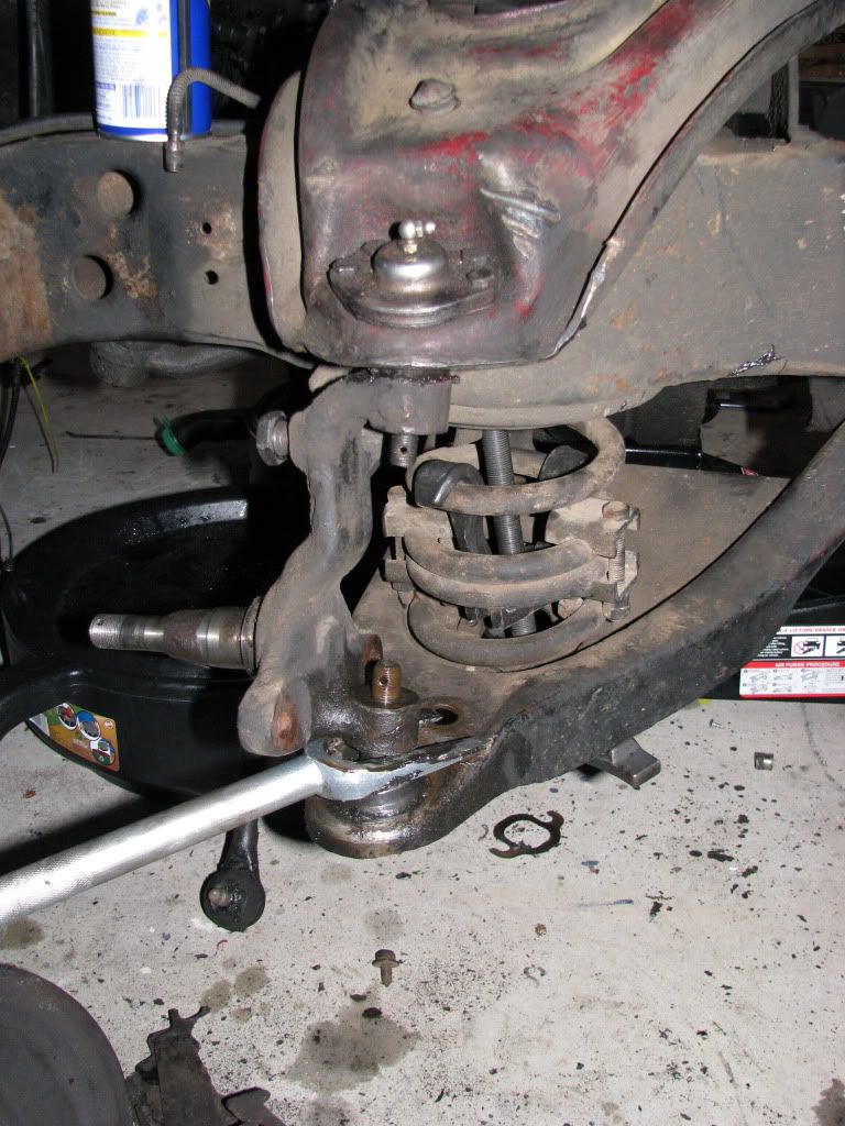

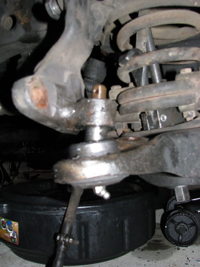

I am currently attempting to remove my front suspension....no, I have never done this before or anything else related to classic restoration. Here are some pictures of my current status. I have removed all but the UCA/LCA, springs, & spindles. I have a spring compressor in place. I cannot seperate the LCA ball joint from the spindle. Other than brute force, is there anything else you can recommend.
My new Hotchkis front suspension should be here this coming weekend!:hurray:
Thanks in advance for any help you can provide,
-Dan

Try going at it from a different angle. The direction your pic shows has the fork going in with the greatest gap between the joint and spindle so it might get all the way in without actually putting real force on the joint. What always works for me is to cut the wheel all the way back and come in from the front corner with the pickle fork, like come straight in at it like in your second picture. Get the fork started so it wedges, then a two hand grip on the 5 pound persuader and batter up.

From the marks on the side of the ball-joint stud, it looks like your 'pickle-fork' opening is to narrow - bottoming on the stud before going in far enough to separate the spindle ... you might be able to grind it open a slight bit more to clear stud ... or get a BFPF :D
Try the technique of installing the nut a few turns, backing off the spring compression a little and wackin' the side of the spindle where the ball joint stud goes through - it should pop in a couple good blows :thumbsup:
