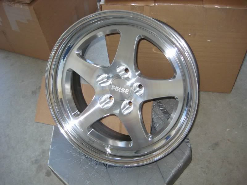

Fikse Classic FM5 wheels 18x12 rears 5.375" BS 18x8.5 fronts - technipolished

New wheels and rubber:
18 x 12's
18 x 8.5's
