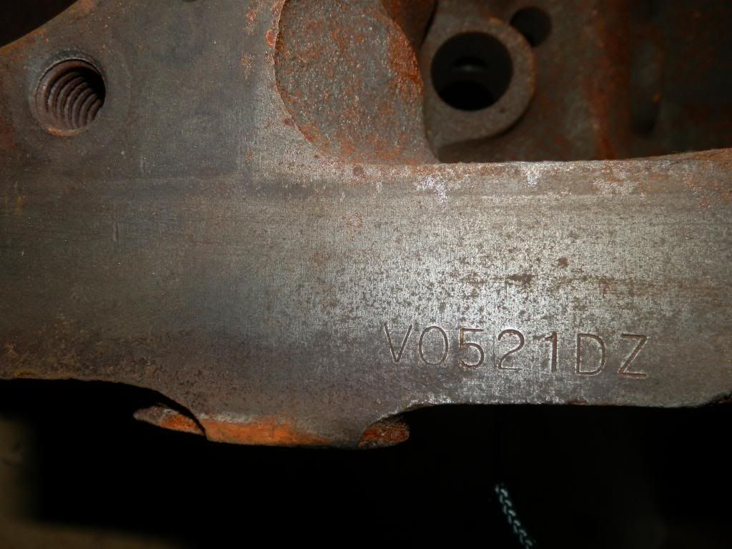

Im a little rusty but i think its a good one.....
Does have faint shadows though.:confused: Looks like a partial VIN just above the stamping.
Hi
Any more opinions, I have one yes and one no
Thanks
Jimmy
Its Real, my Stamp is VO527DZ and they are the same except for the 7, and location looks Good.
It shouldnt have a vin above, it would be by the filter for this late of a block, I think those are just rust pits IMO.
Whats the casting Date? I am guessing E-12-9 to E-15-9 or very close.
Jimmy, post the blocks info (assy stamp, partial VIN, block casting number, and casting date) here: http://www.camaros.org/forum/index.php?board=13.0 The owner of it's original car may be looking for it. It is worth more to him than anyone else. Even if someone isn't looking for it right now, it will be there in the future in case the car pops up.
