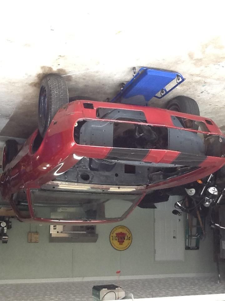

My 68 roller finally arrived today. I'm sure it will need tons of hours of long work but I'm nothing but excited for it. I will continue this thread for as long as it takes to restore this future beauty. I just need y'all's expert advice on the steps in a logical order to go about restoring it. I'm very new to this! The car cams with original steering column, front and rear bumpers and AC components. It also came with a new quarter panel. I'll upload many more photos so y'all can provide me with the first thing I should start doing! All help will be completely appreciated!

First decode the VIN and Trim tag on the firewall. Check the hidden VINs to make sure they match.... http://camaros.org/numbers.shtml#VIN
Do you have any documentation with the car, Protect-o-Plate, dealer invoice etc. ? Does it have the original engine ? If not, first thing before disassembly is to look it over closely, checking for major options the car may have originally had. Check this chart ....http://camaros.org/diffs68.shtml
Take plenty of pics while disassembling to help document the cars originality. From the looks of it, it needs to be taken down to the bare bones and the body shell needs to be sand blasted. I'm afraid you're gonna find some unpleasant surprises.....but then you know what you have and you can decide what's the best way proceed. Don't spend anymore $$$ than necessary until you get to this point.

First step is probably the easiest or maybe not but document what you have as far as vin, trim tag info, hidden vins, optons on car, any possible history, etc., and then an analysis of exactly what you have physically involving the car. Example, determine what sheet-metal will need to be replaced, and the extent of body work.
All of the above is needed no matter what direction you go with the car and that leads to the next step, what do you want? Restored to original, some type of pro-touring or resto-mod car, or?
That assists you to determine what would be needed to complete the goal in the way of interior, paint (different colors & paint can be very expensive) engine, trans. and rear, suspension, wheels & tires.
Many things add up quickly and many we do not consider like hardware (lots of scews, bolts, clips, washers, nuts), wiring, bezels, etc.. If one stays original and wants original parts it's going to cost more vs. repro parts in many cases but in many cases the repro parts have issues and one needs to do their homework/research. You stated you do that. Great:D
Once you know what you want that 68 to look like once it's done start to do your homework to understand the area of cost you might be into. It can be a real sticker shock to many, trust me.
