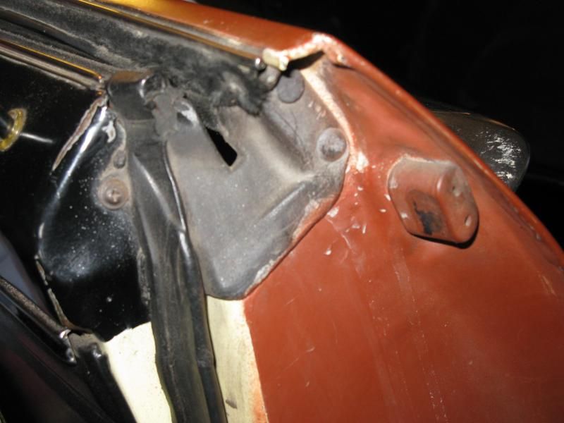

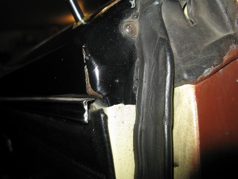

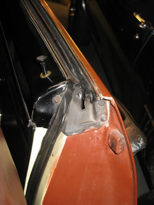

As I understand it, '67 with standard interior means black interior sheet metal on the top of the door and quarter. Does some one have a close up picture of the front and back corners of the door top? From distant pics it looks like body color inside the door gasket w/ black starting just above the corners of the interior panel.
I haven't been able to find this here or at CRG.
I believe the top of door,quarter and dash color depends on the rest of the interior color not all were black. Here's a couple pics of the area I believe your looking for, this door has never been off the car, it's all factory original, paint,weatherstrip and interior panel have never been removed to the best of my knowledge and it's been in my garage since 1977. The spray bomb primer in the pics is covering the factory butternut yellow in some of the jamb and the outside done by the previous owner, my older brother
