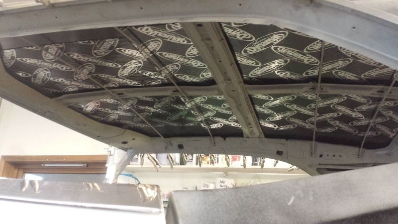

The plan for this winter was to pull the interior to install the Dynamats. As you can see things didn't go according to plan :hurray: Well...the interior is out though.
The new plan is a lot more fun...and expensive :sad:

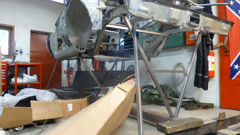

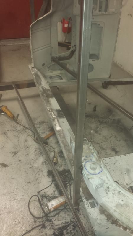

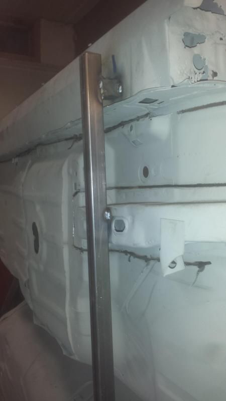

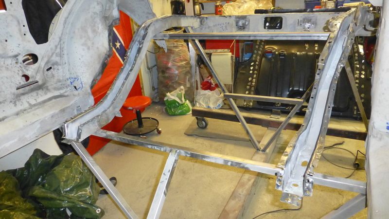

The car is now in the rotisserie, and I will weld in some braces before I start cutting anymore.
My plan is to cut out the main floor, and replace it. Just welding it at the rockers, and front. Leaving the trunk floor, and frame rails un-welded.
Then move the car on to the jig. Still have to build it though. Remove the trunk floor. Here is my first question. Is the frame rails good enough to repair, or would you replace them? I think I could repair them fairly easy. But maybe there is a good time to replace them when I'm out with the trunk floor and everything? But it would make a lot more work, because I would have to remove the inner valance panel. And the inner panel looks fairly good, still have to pull the tailpanel to check it out.

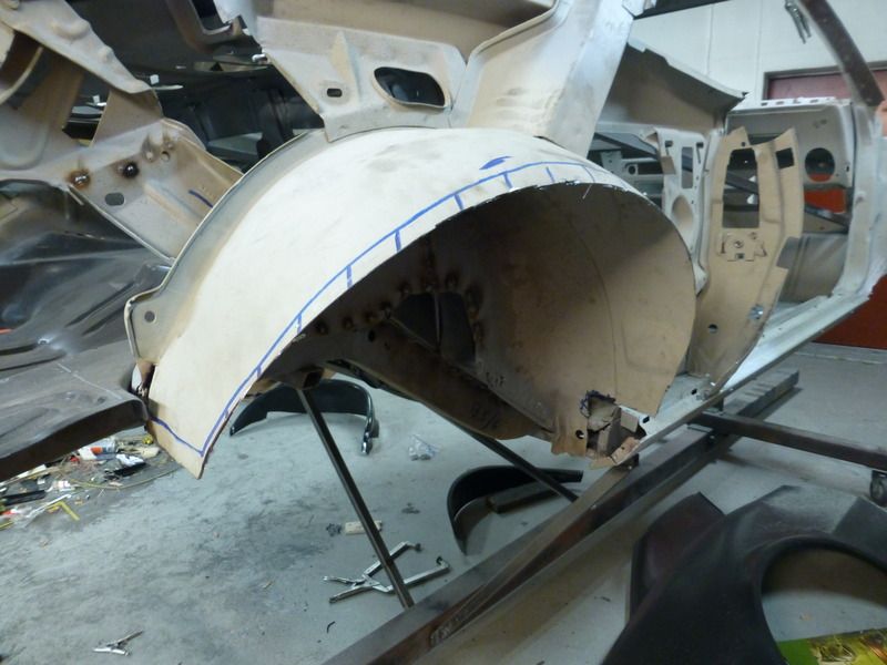

While the trunk floor is out, I will patch the inner fenders and cut the rust out of the outers and fit the new replacement parts.
Then install the trunk floor and weld it.
Then move forward and patch the tulips and upper cowl panel.

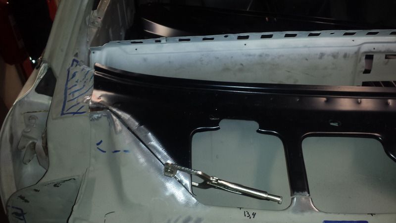

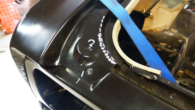

That is my second question. Would you replace the whole upper dash panel, or cut it like I have marked it, and install a new piece cut from a new part? The lower part of it looks good, but I guess you never know what is hiding underneath. Would you replace everything?? Not sure about that...since the rest look pretty good.
Then I will have to patch the roof bracing. Blablabla, I will post as I go :yes:

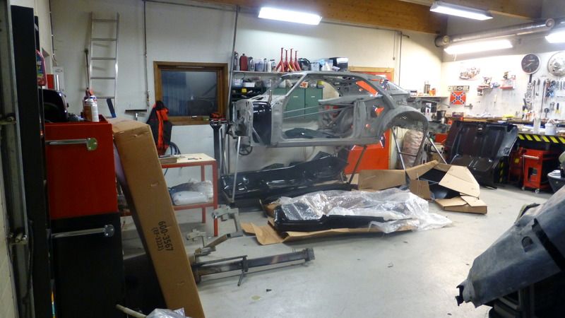

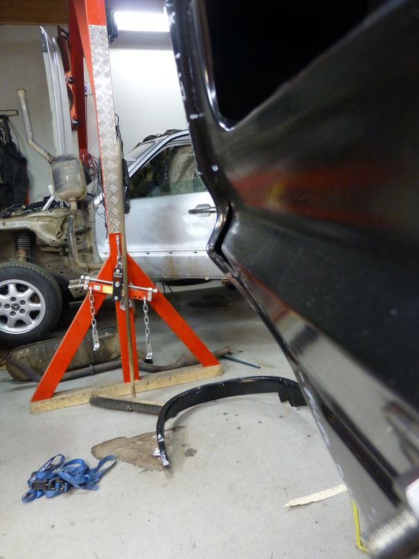

Okay...Still just organizing the workshop!
Since my last post me and my friend (who also works on his car in this garage) bought the ESAB 200A Mig welder. My first toolbox came in handy, as we welded on a stand for the gas bottle. Makes moving it around a charm!
And yesterday I just couldn't help myself. I bought a lot of tool-sets to fill up my new toolbox. I needed it to help with my OCD :D I'm not sure my wallet agrees though..:sad:
Today I went to my brothers house to pick up a worktable I made at school 5 years ago. Never used it, so I figured this was a good time to do just that.
Sorry about the crappy cellphone pics...I need to remember my camera :eek:

#8 · (Edited)
Finally some updates.

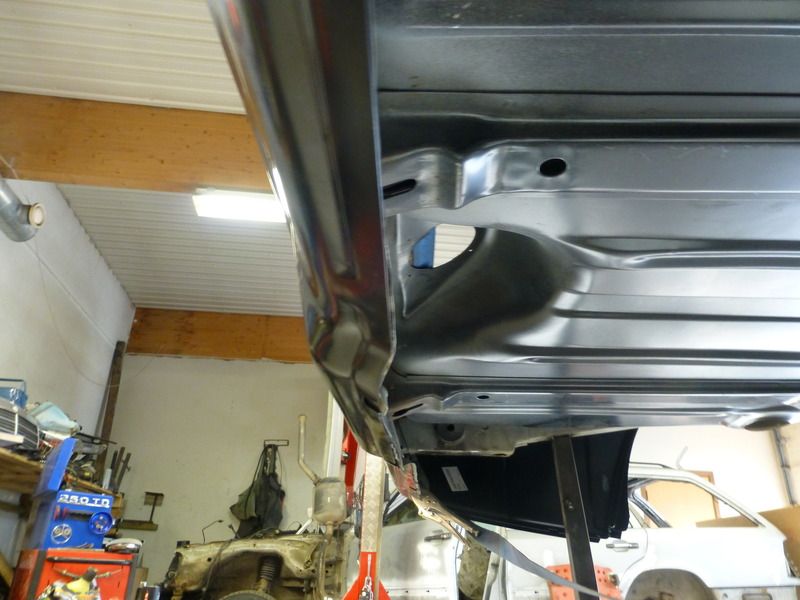

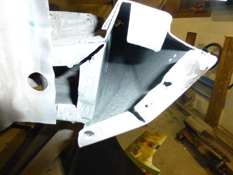

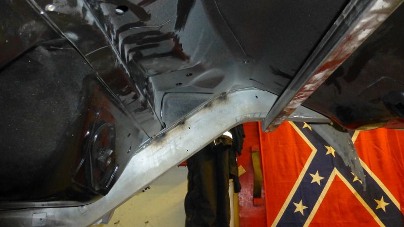

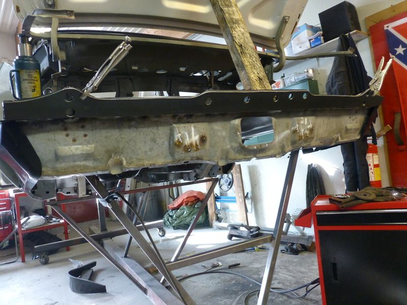

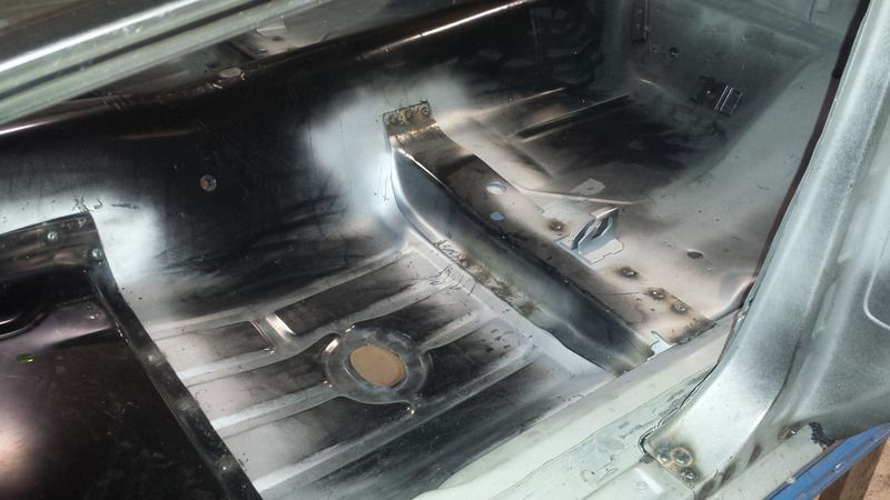

I got the floor out, and cleaned up the inner rockers and firewall flange. The inner rockers look really solid, like new. Pleasant surprise there :hurray:
I'm going to sandblast the inside of the frame rails, and spray them with epoxy primer, then some kind of undercoating before welding the new floor on. The car is now pretty much ready for the new floor to drop in.
Other than that I've just been grinding on some left overs and spot welds from the panels I've removed. It doesn't seem like much, but it has to be done anyways.

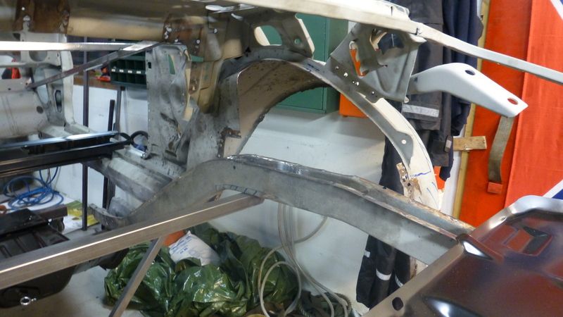

Oh, I want to show you why this project will take a while. My appartment/job :)

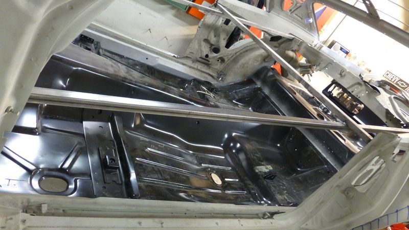

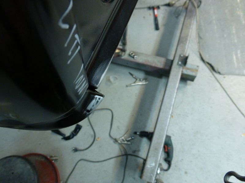

Finally some real updates!

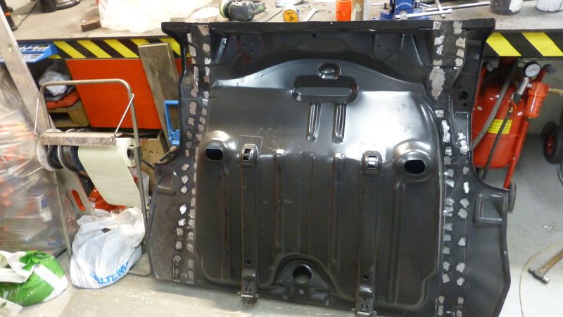

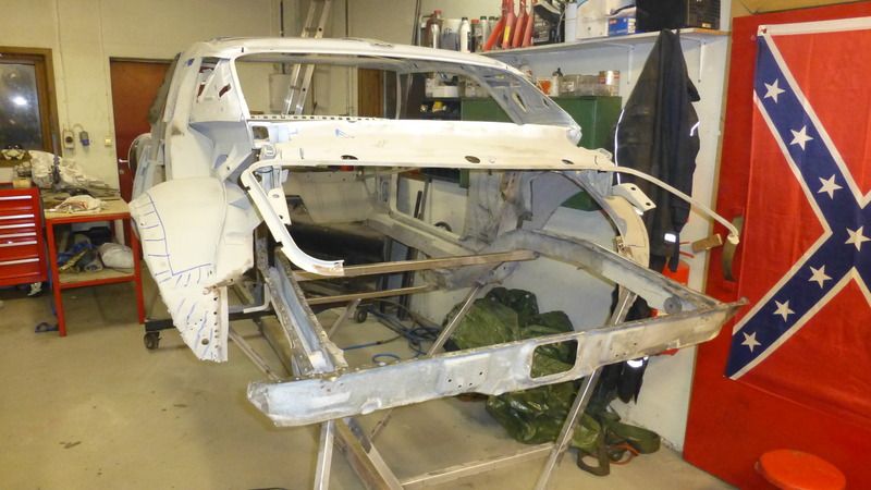

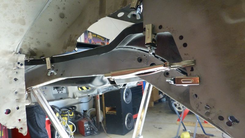

Got my parts this Friday, and I've been working through every night and every day! I've seriously slept for like 3 hours since 7am Friday morning, and until now 2am Sunday. Totally worth it :beers:
My first thought was to start with the main floors. But realized it was better to repair the trunk floors first. I thought I just needed to patch them, but quickly changed my mind. Started removing the old floor. Cut out the tail panel, and cut one inner wheelhouse, and bent the hinge support out of the way.

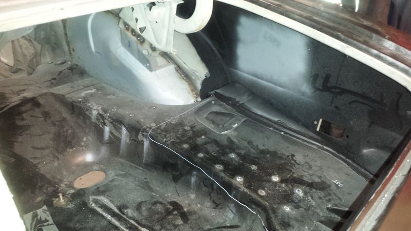

Got the trunk floor, and main floor in to place, just to check the fitment. The trunk floor was really good, and almost fell right in to place. The main floor was a little worse. It refused to sit flush to the frame rails. But with some hammering, pulling and self-tapping screws it turned out just fine. Not perfect, but good enough.

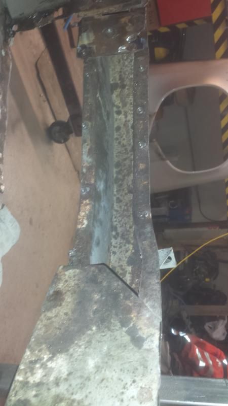

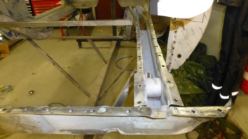

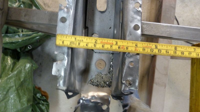

Today I've sandblasted the inside of the frame rails, and drilled holes for the plug-welds and grinded the primer off of the new trunk floor. Tomorrow I'll go get some weld-primer, and start fitting the trunk floor. Really nervous to be honest.

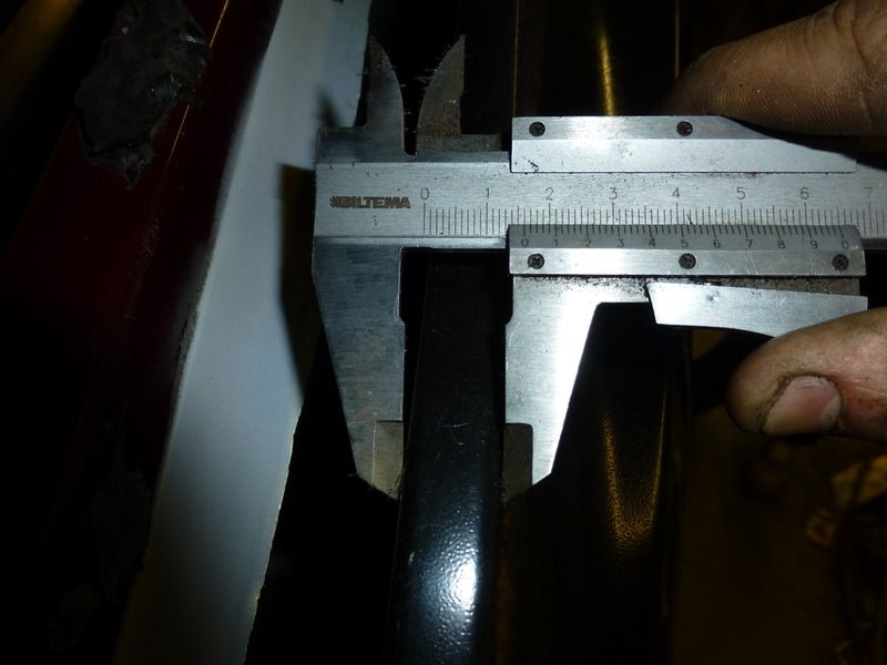

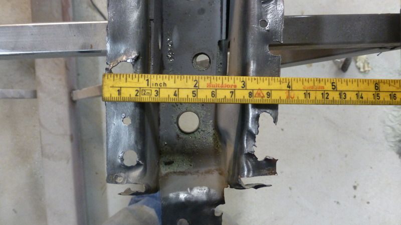

If you see something stupid, wrong, or crazy please let me know so I can fix it before it's to late :D

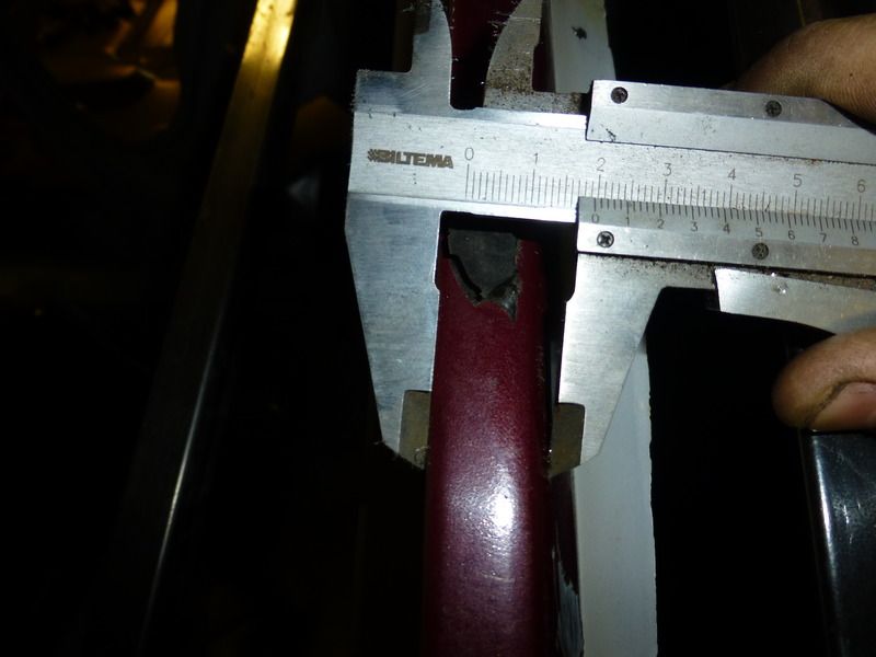

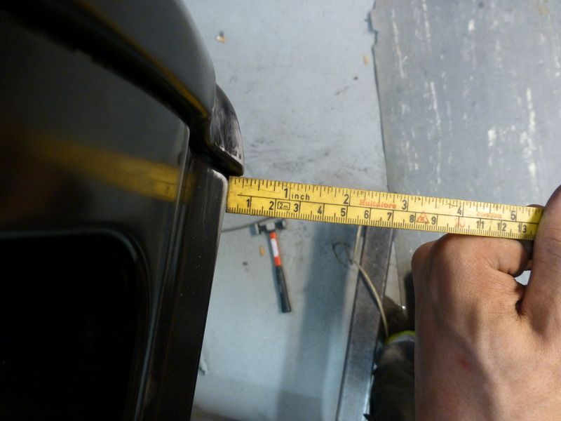

What is the correct width on the frame rails?? Mine is a little bent after all the hammering and drilling when removing them from the old floor. Is that an critical measurement?? Pictures below!

Jim Erlend - First my hat is off to you son. At 22 years old you are taking on a massive project and seem to be doing a very good job at it. Many a man your age would shrink at the amount of time, money, and pure sweat and hard work you are in for. But the reward will be immense and priceless.
And if you think that is a messy shop you have to look at a few build thread here more closely. You are a dangerous man, motivated, organized and own a Camaro!
Where in Norway? A very good friend of mine runs a few restaurant/bars in Norway. I've only been in Askar and Oslo myself but that was before you were born.
I'm glad your making progress and happy to see the update. As to the frame rails I'm not sure the correct width for 68. Maybe these will help until someone posts the actual dimensions.
and the dimensions below. I think the mounting position will tell you if your are too narrow or too wide but as long as they are in correct position center to center as shown in the pics below they are okay. Maybe new frame rails at Classic Industries will list the dimensions.

The original plan was to pull the interior to install some dynamat. I guess that'll have to wait :thumbsup:

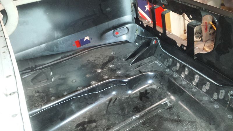

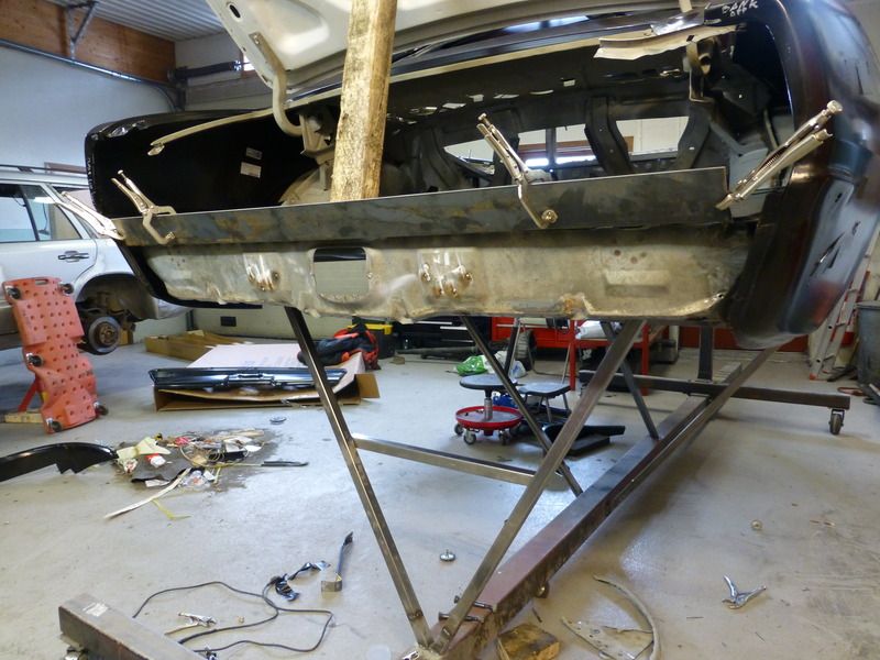

Okay, I can see this post is getting loooong. So let's fill you in on some updates.

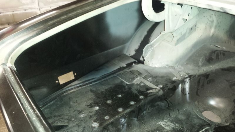

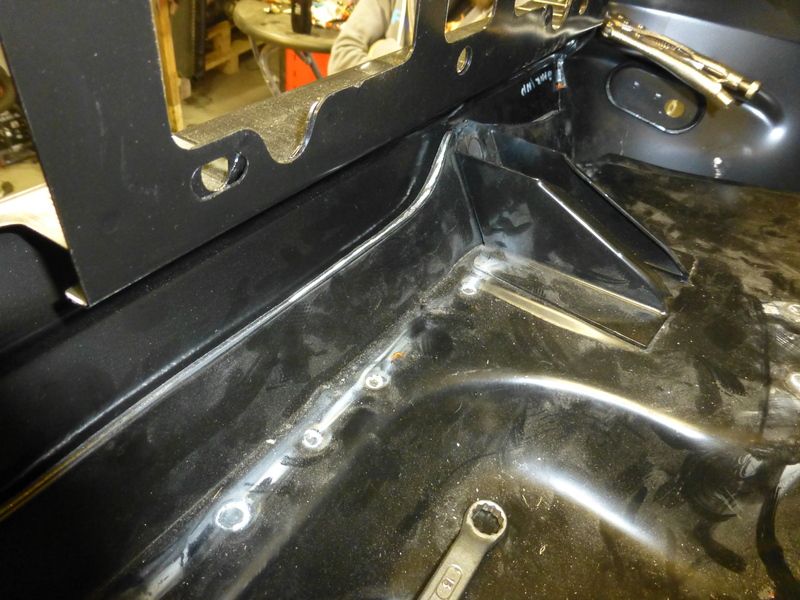

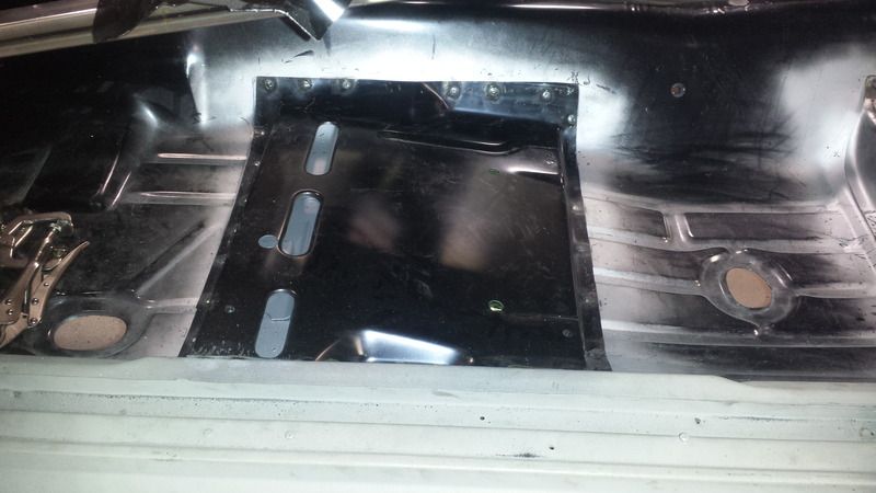

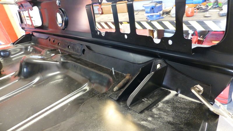

Got the trunk floor welded in, didn't do all the plug welds just in case something was wrong.
Also got the main floor ready for welding. But it got late, and I had to go home. But I will finish up this weekend. I get 10 days vacation when this Friday is over. AWESOME :beers:
Really happy about the gaps though! Pretty much non existing. I still have to tweak the driver side frame rail a little bit.
Feels really good to have solid floors! Feel like I'm really going somewhere :D

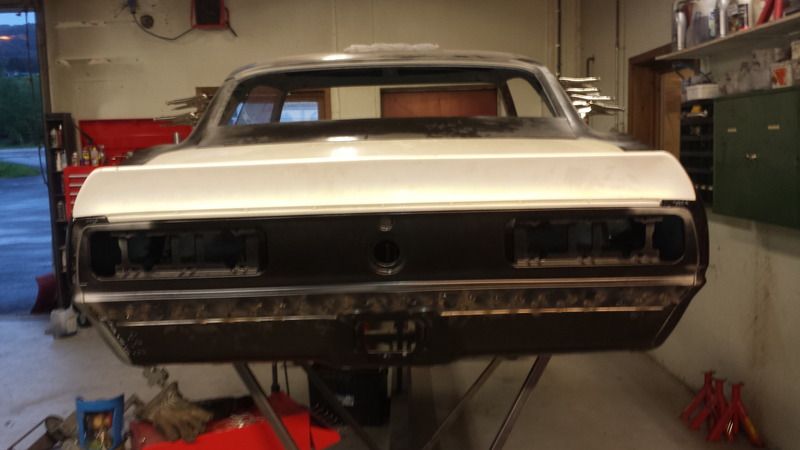

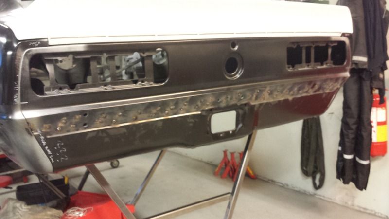

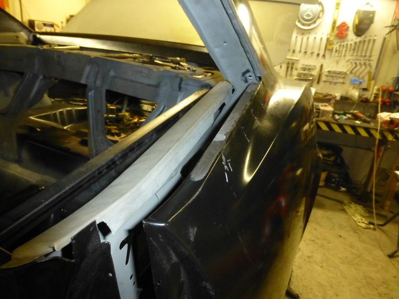

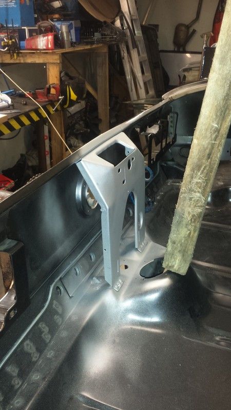

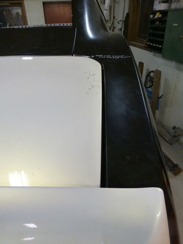

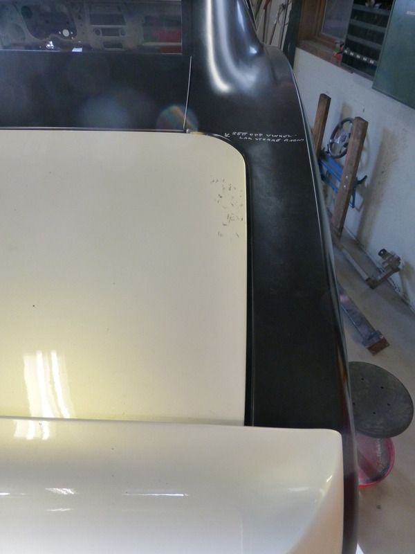

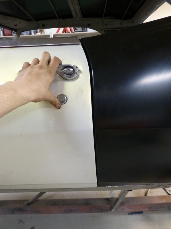

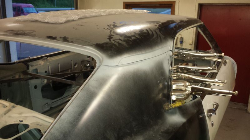

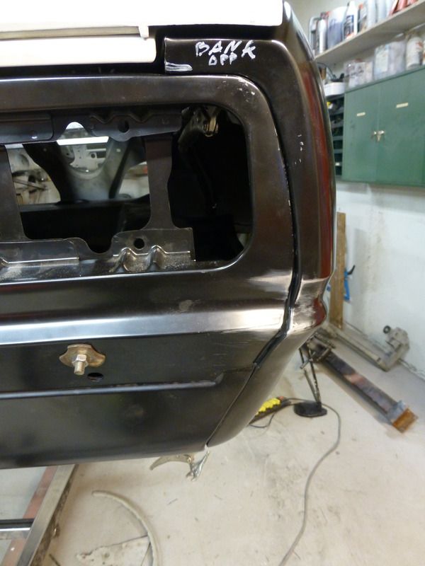

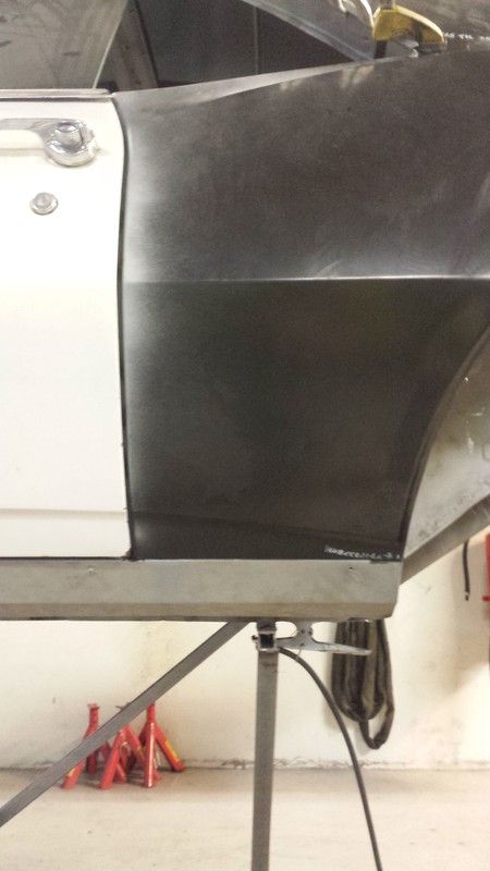

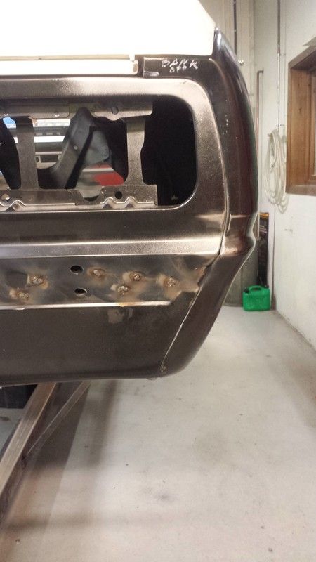

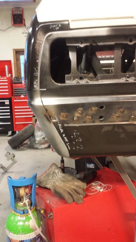

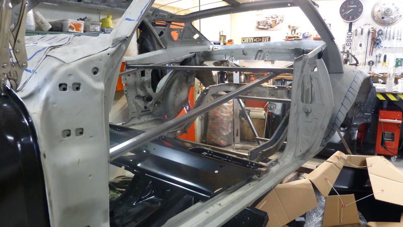

Working around the clock these days! Got a lot of thing done. But need your help :confused:

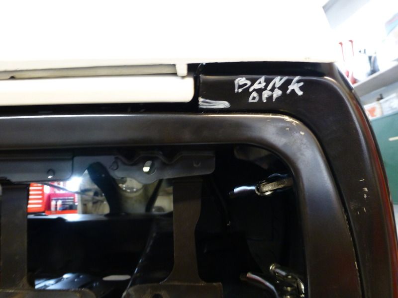

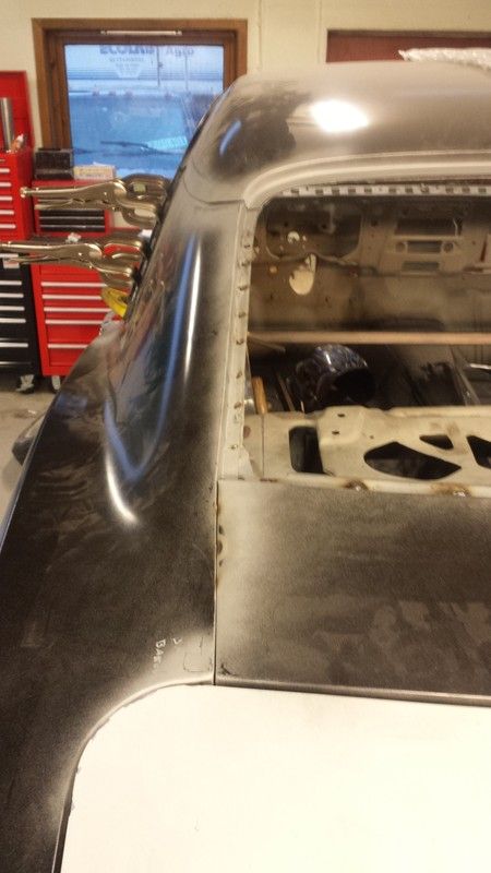

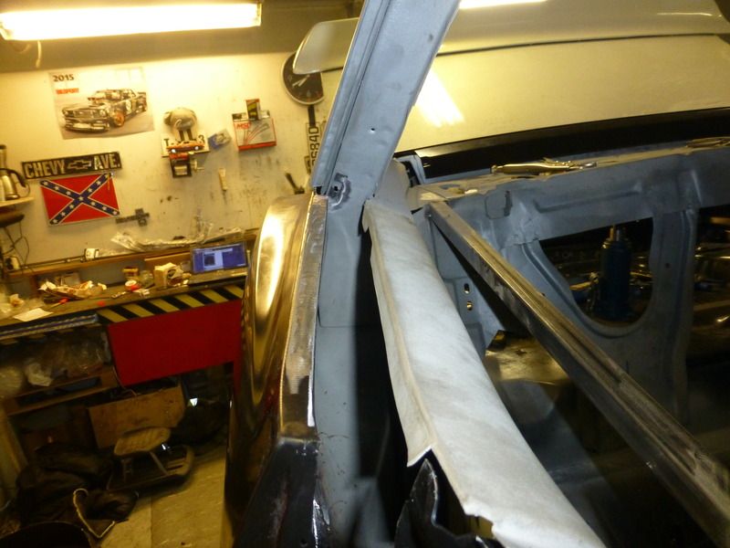

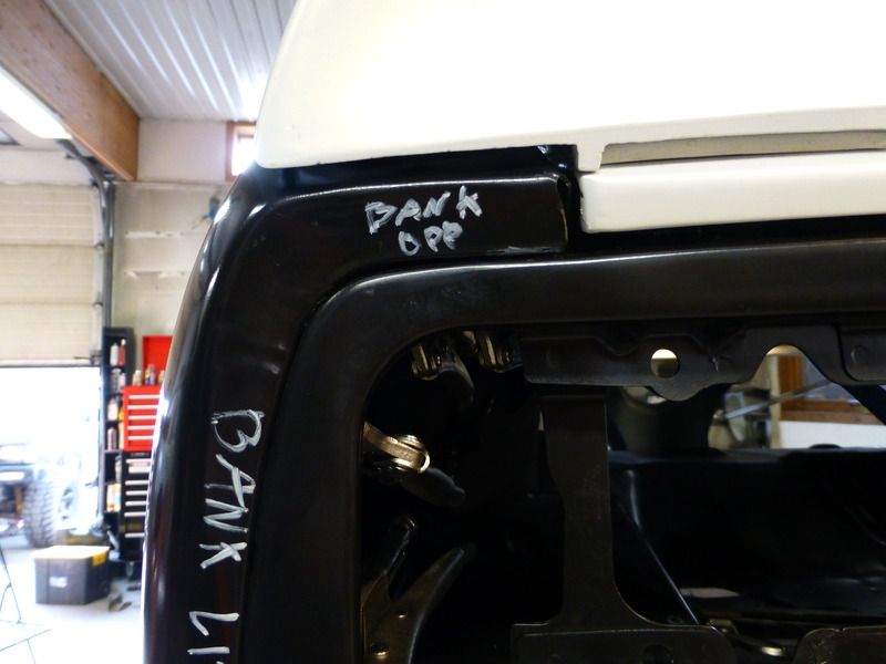

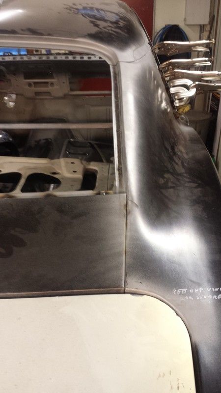

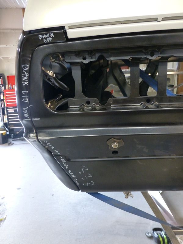

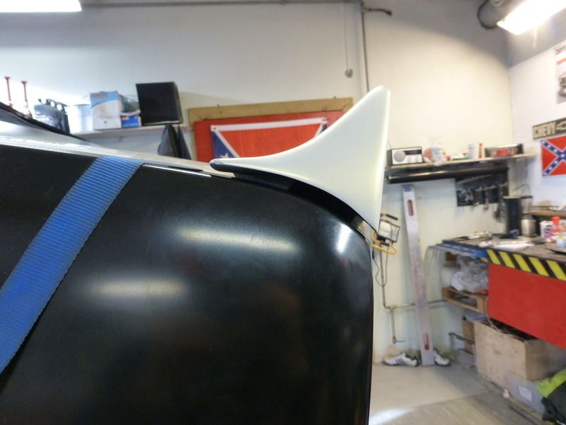

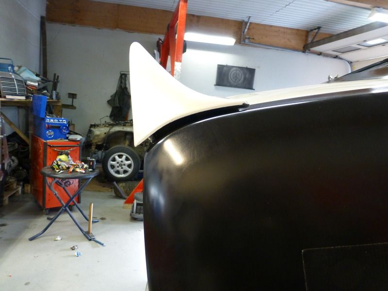

Hung the quarters, tailpanel, deck filler panel, trunk lid and roof! Really happy about the gaps and fit so far. Actually pretty impressed. Of course I have some issues to fix. Need your advice and tips on some things. As my signature says...I'm a neewbie :D

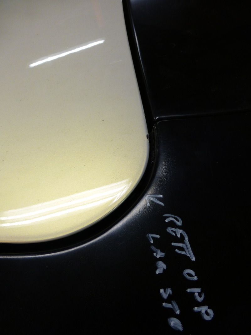

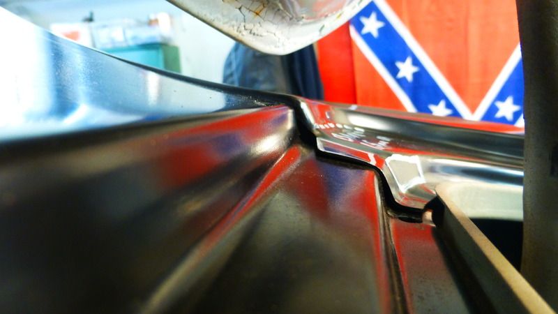

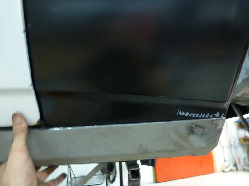

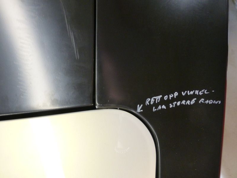

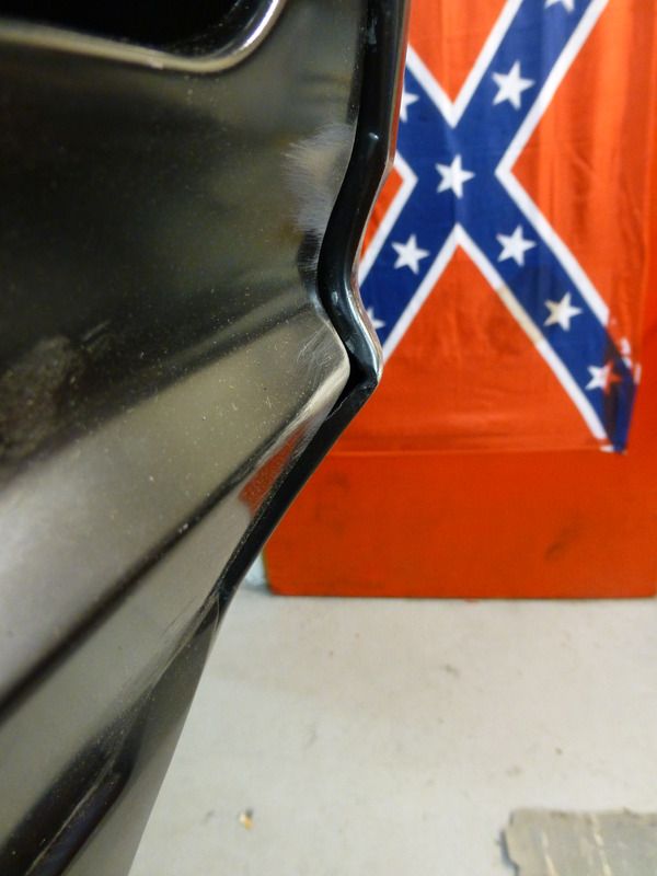

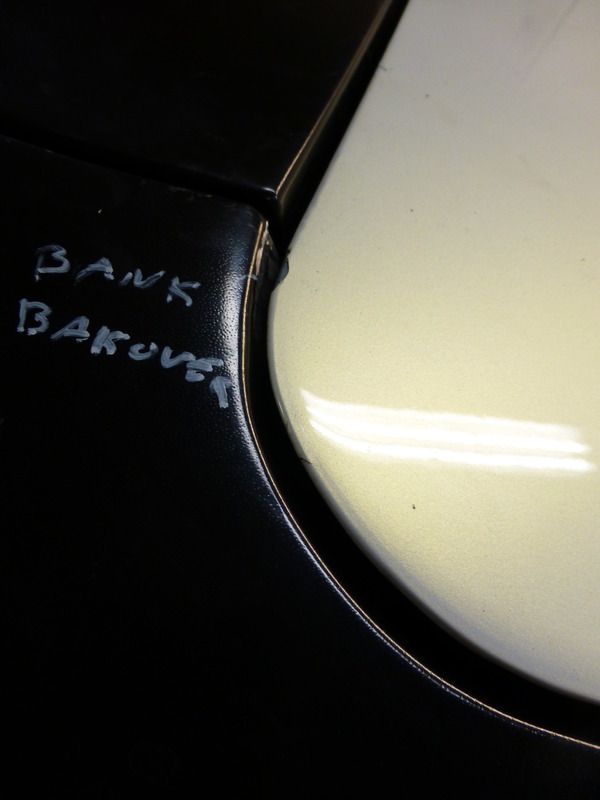

Tight trunk lid corner: Just hammer the quarter until it has the same angle as the deck filler panel? And maybe a relief cut and add some metal?
Quarter to tailpanel: Cut the whole "trunk lid bumper piece" and move it so is flush to the tailpanel, or just increase the radius on the inside?

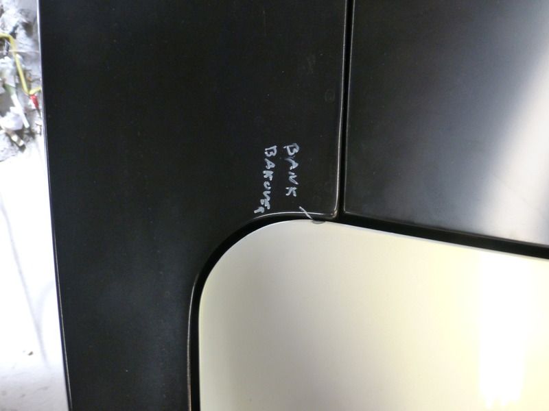

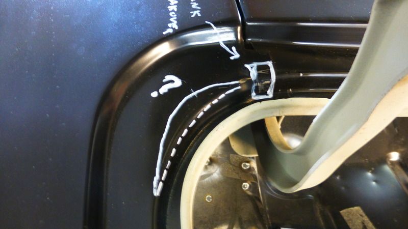

Tailpanel to trunk floor gap: 5-7mm gap. Not sure how to do this. Add a 5mm strip of steel between the two panels, or just force it in place with vise-grips? That may push/force the tailpanel to far forward at the quarter to tailpanel seam. What to do?
My bumper holes don't line up perfectly, is that really important? Or should I focus on lining up the panels, and drill out the holes later if that is necessary?

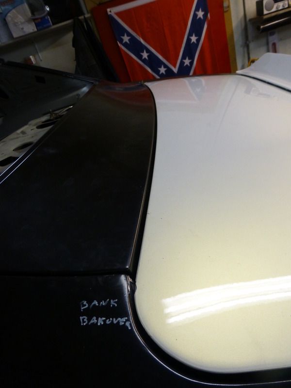

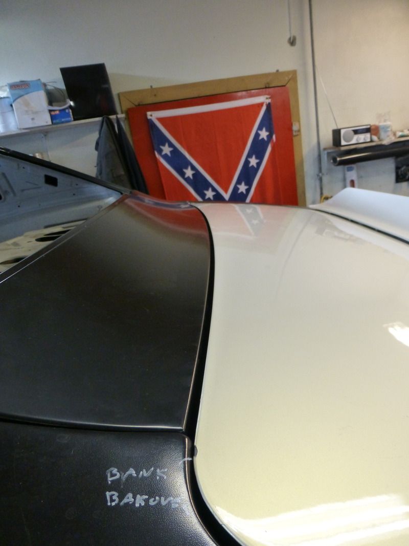

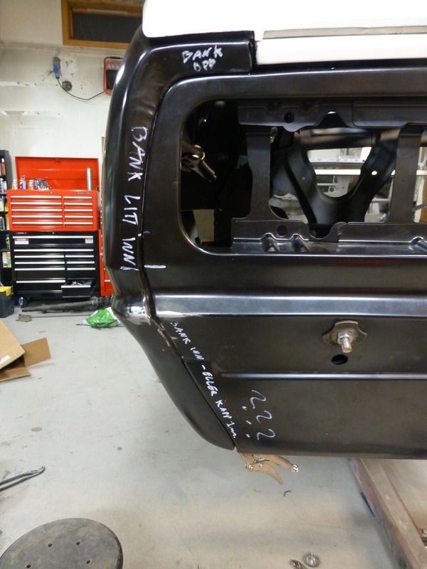

#14 ·

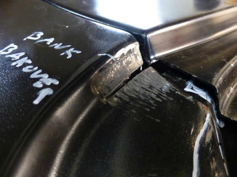

Okay...a few hours later, and lot less hair (pulled most of it out)
Made a cut in the quarter up by the deck filler panel, to align it better with the trunk lid. It got better, but still not quite there. Also made a steeper angle on the flange that welds to the rocker so the quarter sits pretty good at that spot.
BUT. There's a lot of those buts..:D

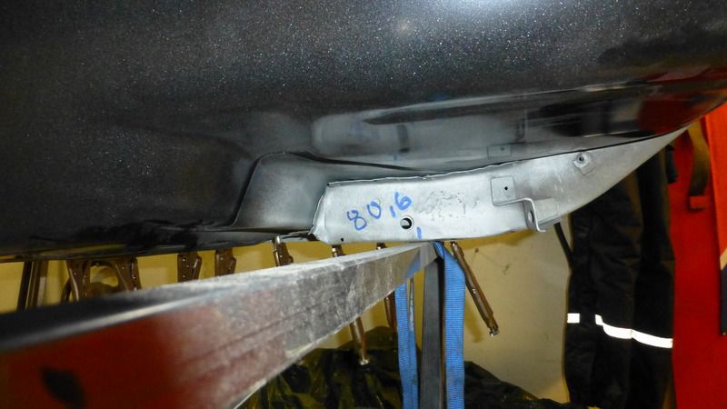

I pulled all of it back off. Now I've fitted the tailpanel flush to the trunk floor before sliding the quarters over it. I got acceptable gaps all around the tailpanel I think. But the tailpanel is waaay to far forward in the middle. I see no other solution than adding a spacer between the floor and tailpanel??? I for sure can't tweak my quarters that much without destroying the whole thing.
Did I weld the floors in the wrong position? They seem to fit pretty damn good everywhere else. Looks spotless if you ask me.

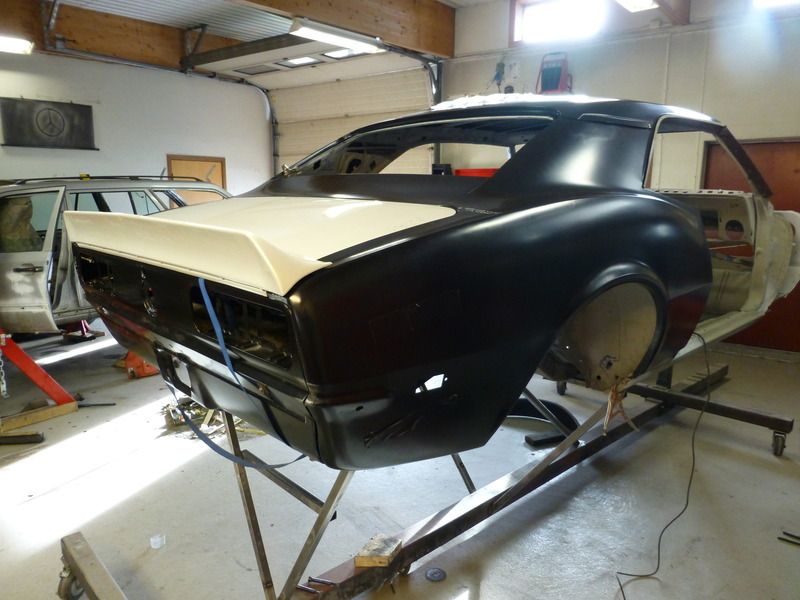

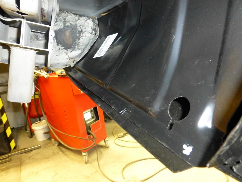

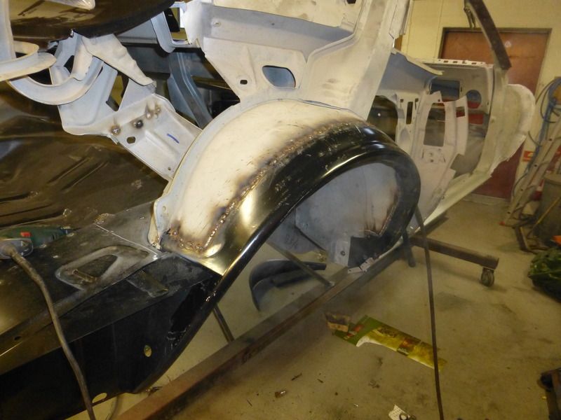

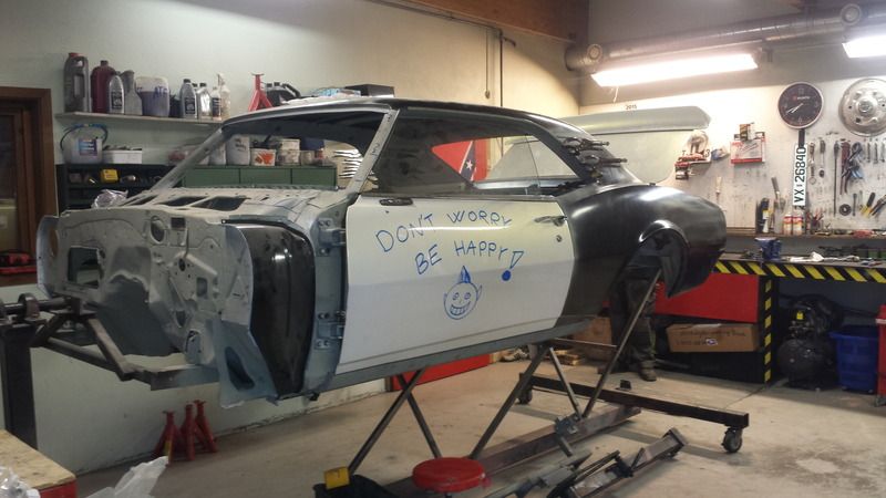

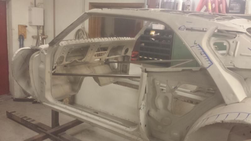

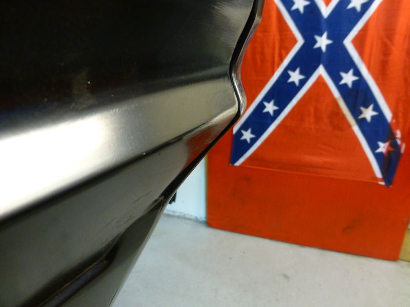

Things are moving along, slowly...but progress is progress! :) This is a part of the project where things get time consuming.

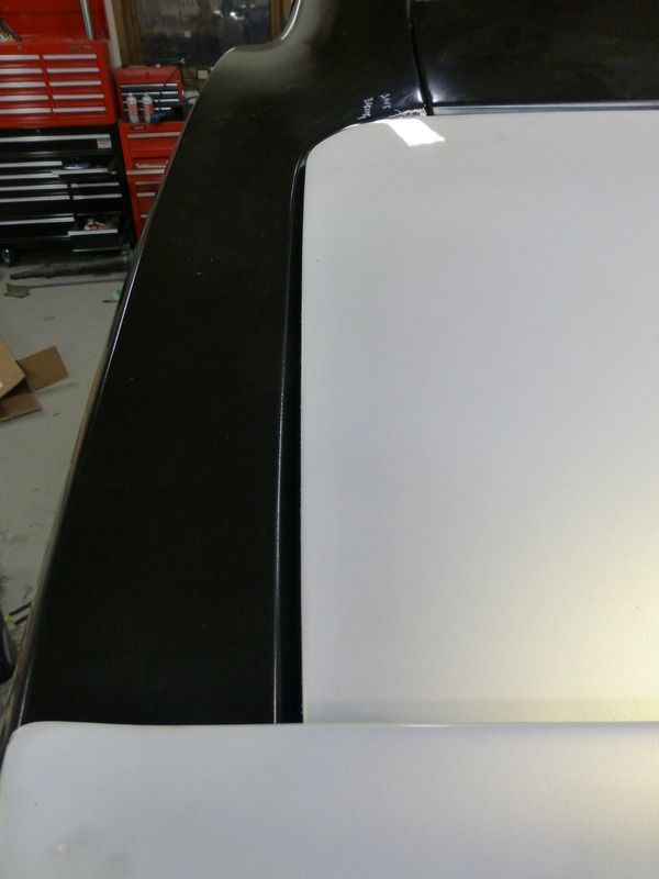

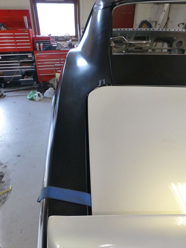

All the panels are now lined up, the EDP primer has been grinded off at every weld-point. Just about ready to weld.
Since the last update I have made up a spacer between the trunk floor and tailpanel to move it 5mm backwards in the middle to line up with the quarters and beeing able to properly weld it. Came out pretty nice, and worked like a charm. Won't be seen after I put some kind of adhesive/seam sealer in there.

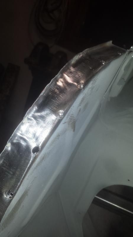

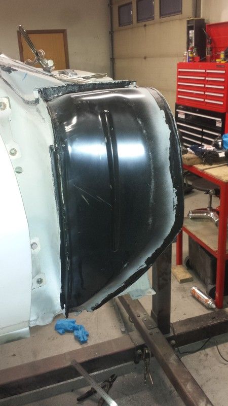

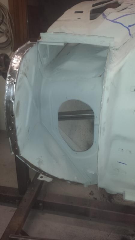

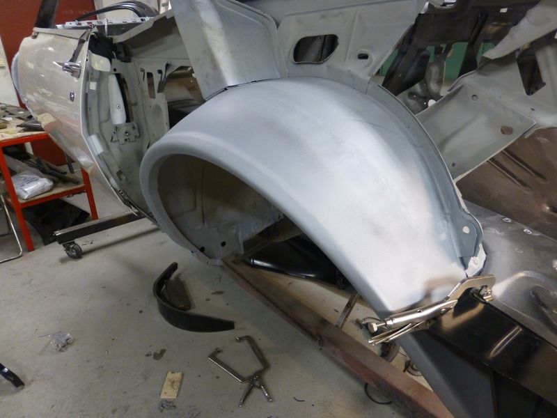

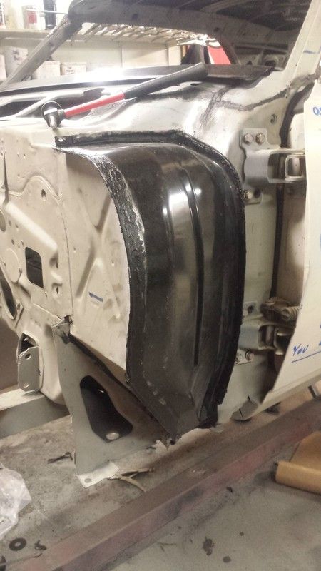

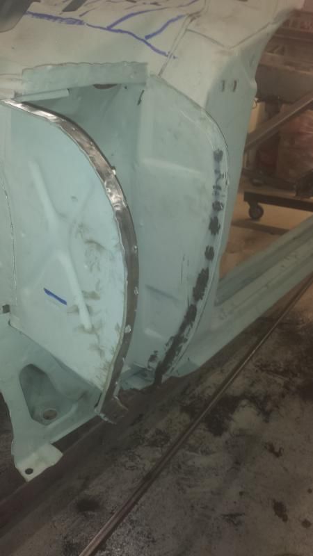

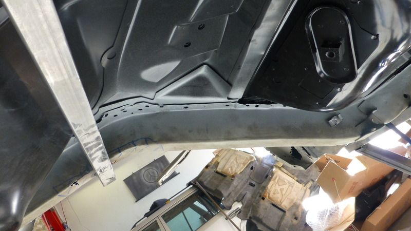

Also cut out a bad spot on the passenger side inner wheelwell, sandblasted the area and inside of the rocker as far as I could reach. Painted it with weld through primer and welded in the patch. Then came the outer wheelwell. The driver side came out really good, the passenger not so much but good enough since it won't be seen. The trunk area will eventually be covered with some kind of plywood that will be covered in fabric.
Then I had to extend the trunk drop-offs a little bit to meet with the bottom of the quarters. A walk in the park compared to everything else so far! Couldn't find pictures after I fixed them.
Also had to fix the radius on the quarter that meets with the deck filler panel to get a acceptable gap around the trunk lid. Had a really hard time getting myself to make a cut in to the new quarter, but it had to be done.

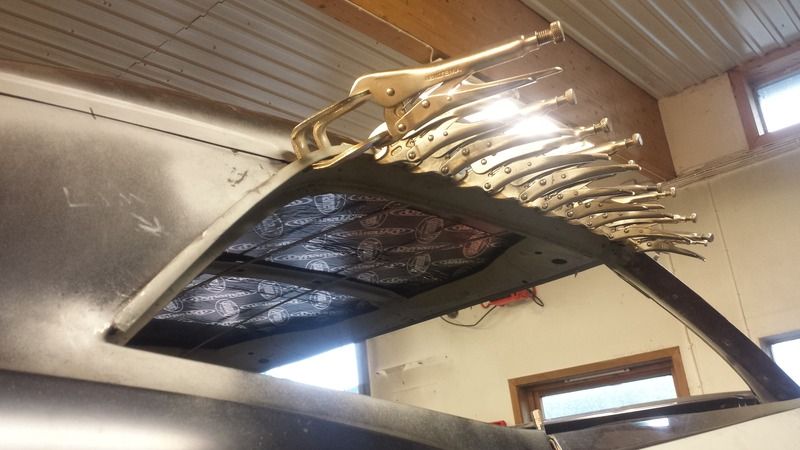

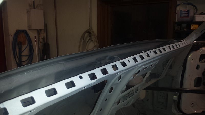

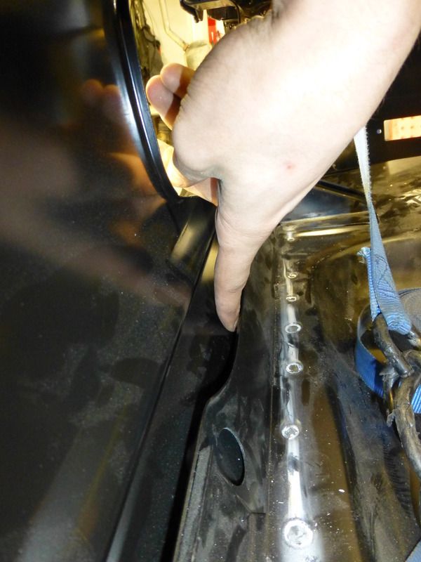

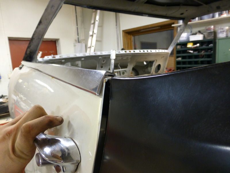

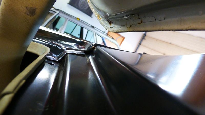

When I pre-fit the quarter window reinforcement I couldn't get it to fit. The quarter just wouldn't go far enough towards the inside of the car. Scratched my head for hours, and couldn't figure it out. Then I went ahead and pulled out a part of the old quarter that I luckily cut out before tossing it.
Then it got pretty obvious that it was the window channel in the quarter that was to narrow, placing the reinforcement to far out. Jumped right to it, and cut the window channel. Took a lot of measurements of the old part, and bent the channel to the same width as the original piece and welded it back up after making a wedge to insert. Sorry, no pictures of the process :( Got so focused that I forgot about it.
Tomorrow I will make sure every spot that needs to be welded are perfect, and pre-fit all the panels and make it completely ready for welding :hurray: Hopefully next weekend. Tomorrow is my last day of vacation :sad:

It's been a long time since my last update...And I have been doing absolutely nothing! I was doing way to much in my last vacation and felt sick every time I looked at the car. So I had to take a break. But now I'm feeling motivated again, so back to work :thumbsup:
Yesterday I glued the reinforcements on the inside of the quarters to make it all ready for welding today.
Got a lot done today. Both quarters, and tailpanel is all welded. I have about 10 more spot welds to do before I'm all done, but they are finally on there :hurray:
I'm really happy about the results, the gaps are more than good enough for me.
I'm hoping I will be able to glue and weld the roof on tomorrow. Not sure if I have enough time before I have to go to work. Someone has to deliver the things you need, right? :hurray:

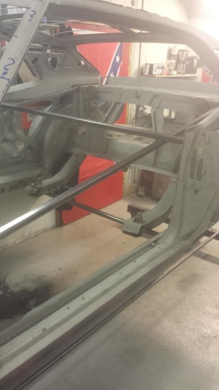

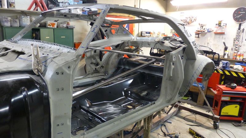

Long story short,
Quarters fully welded.
Trunk lock bracket is back in there.

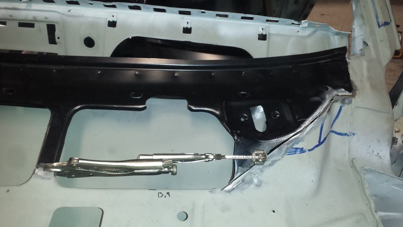

Upper cowl repaired.
Outer Cowl's welded.
Seat mounts welded.
Conv.braces welded.

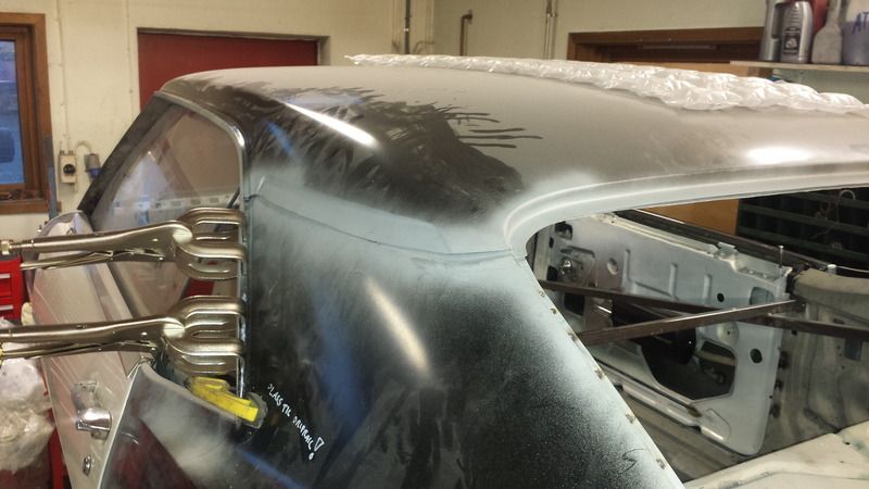

Roof glued in place.

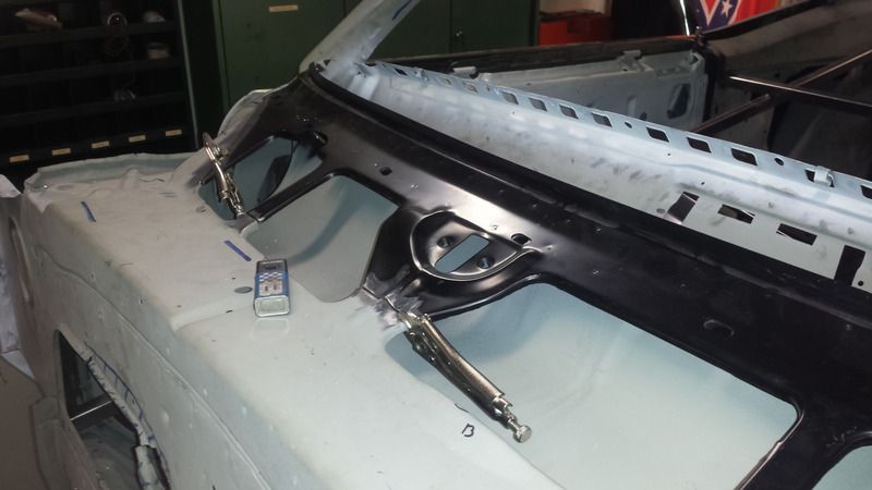

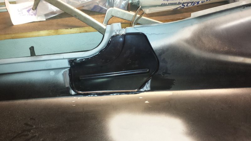

Decided to repair the upper cowl, rather than replacing the whole thing since most of it was in good shape. Why remove original steel right? Came out pretty good, considering nobody will ever see it anyways.
Seam sealed the inside of it, and got the outer cowls welded on and seam sealed.
Glued the roof to the drip rails using WĂĽrth Powebond. Going to spot weld the window openings tomorrow.
Only thing left on the body now, is to get the dash panel welded. And grind down every spot weld on the entire body. Have been pushing that job away for some time..:eek:
Not really sure what to do next...Is it time to get the subframe and suspension mounted, and get it back on wheels? Make mounts for the fuel lines, brake lines and exhaust so I can remove everything again and paint the underside?? I'm confused. So. Much. To. Think. About :confused: How do you recommend to mount the fuel/brake lines? I really don't want to run screws through the new floors. Weld on nuts, or brackets or something?
