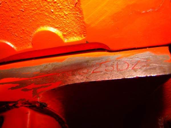

To me it looks like the stamp reads V0525DZ (May 25th) or maybe it's a 03/25 (March 25th) but hard to tell, maybe someone can chime in and suggest if this is an original stamping. The partial vin will be located on the oil filter boss as noted in the above link by John. Looks like you are trying to confirm if this was the original engine for the car and if that is an 05/25 with a build date of 03E there might be a disconnect. It's not uncommon for these cars to run a second or third engine, most folks don't even look at these dates...just get something close to the build date and sell the car as a "period" correct engine.

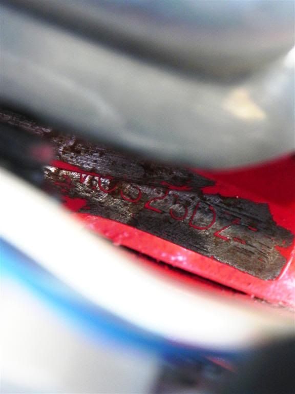

We are going to need a better picture of the engine code stamp. Try using some lacquer thinner on a rag and use a scotch brite pad. Do NOT use anything abrasive.
Yes, I am trying to determine if this is the original engine. If the Engine Code is V0325-DZ it would match the Protecto Plate. I would like to find the engine build date as I have heard the engine codes are sometimes re-stamped.
Here is another picture of the engine code. Unfortunately, it has a scratch through it.

The engine build date is part of the stamping on the pad as pictured..

I would really like to see that stamping cleaned up, thinner or something. It looks like the block was decked, and they stopped as they were hitting the numbers,. the 10-12
inch circle looks like it was being decked?
