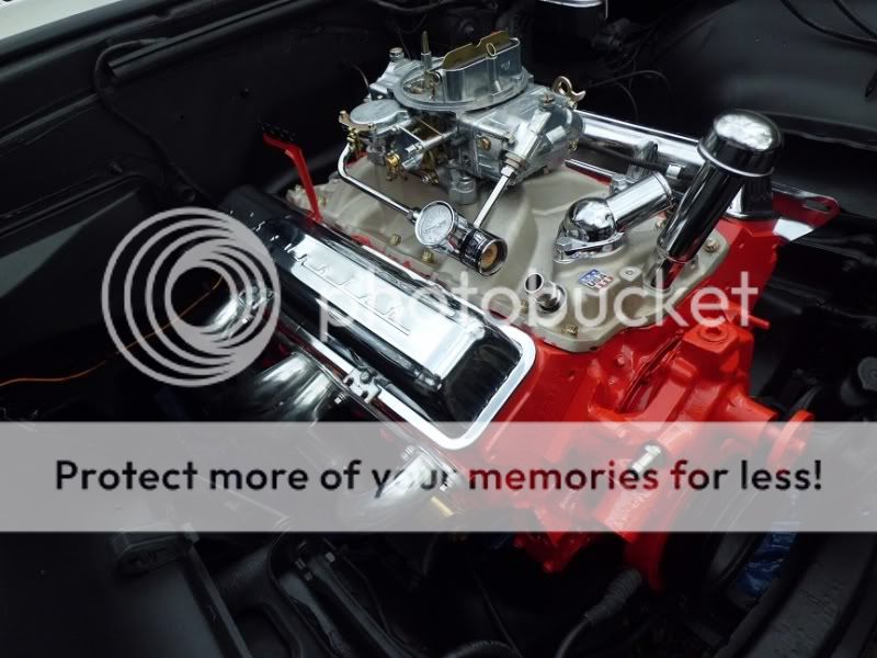

took right at 3 weeks to do the work my girlfriend helped a lot too , here is what I ended up with , the orginal 327 bored 0.40 speedpro .125 dome forged pistons L79 cam new richmond gear super T10 with 2.88 1st gear , new flowmaster american thunder exhaust with 40's holley dual feed single pump 750 got the energy suspension motor mounts and transmission mount the red polyurethane ,,,,,,,,,,,,,,,,,, took a bunch of pics !
