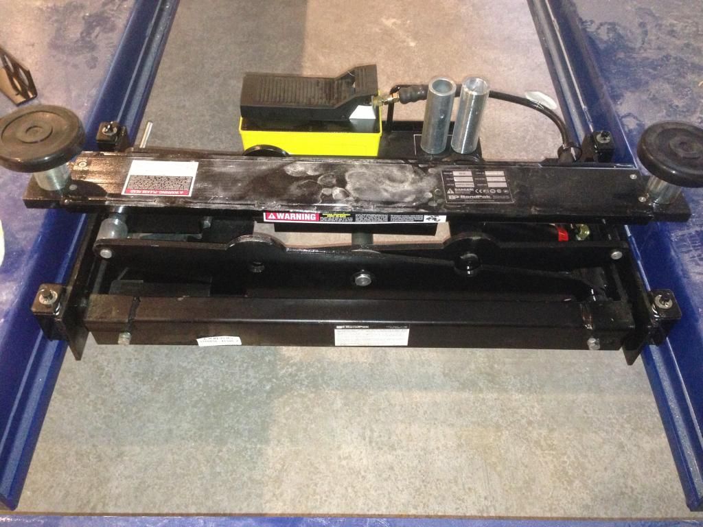

OP said storage and small job....so i would highly recommend a 4 post lift with a sliding scissor jack. I just put in a 4 post Bendpak HD-9 with a rj-45 rolling jack and have been very pleased with it. Just changed out a set of motor mounts this weekend in the 69 camaro. Now if it was mostly for maintenance work i would have looked at a 2 post as others have stated.

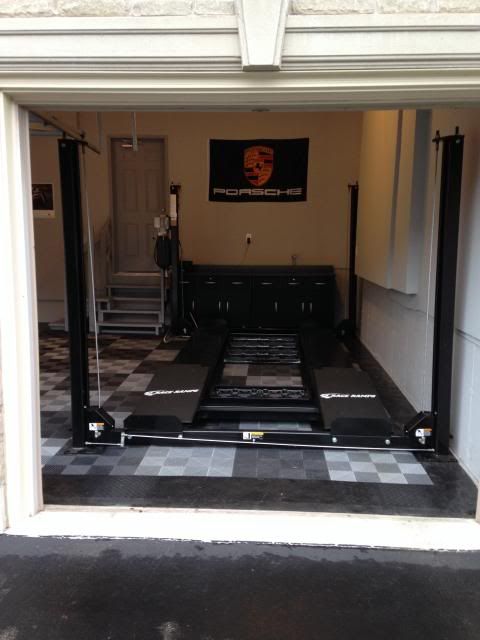

I went with the Direct Lift - less than $2K in the US and about $2,200 in Canada. Great lift so far. Comes with casters, jacking bridge and steel ramps. I bought a set of Race Ramp brand ramps because the steel ones are HEAVY!!! Forgive the Porsche banner...I am redecorating soon :)

I've been warned by sellers and installers of 4 post lifts that the casters, while convenient, don't offer nearly as much safety for you or security for your vehicles as bolting the lift to the floor.
YMMV, but my 4 post is solidly bolted to the floor of my shop.
