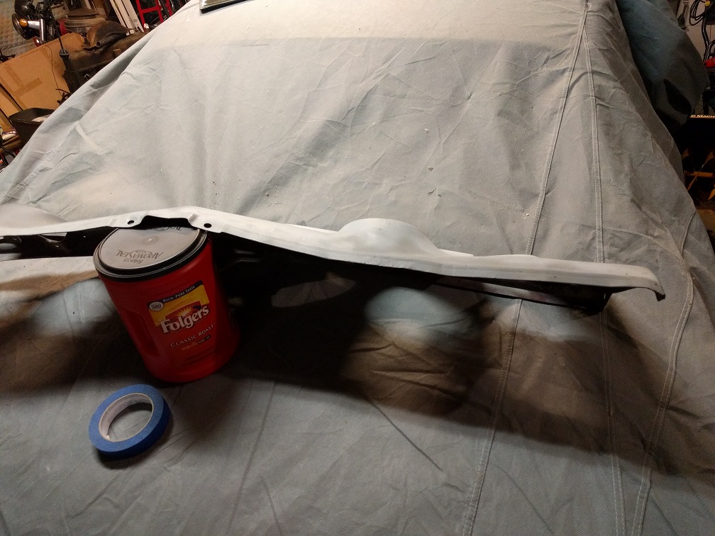

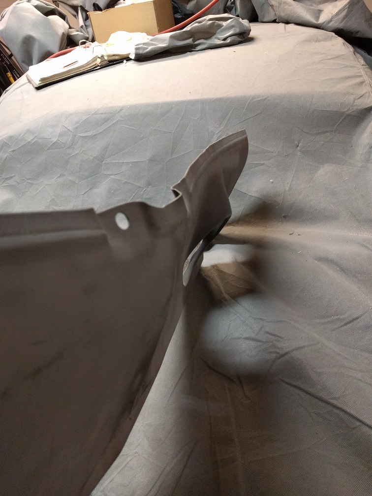

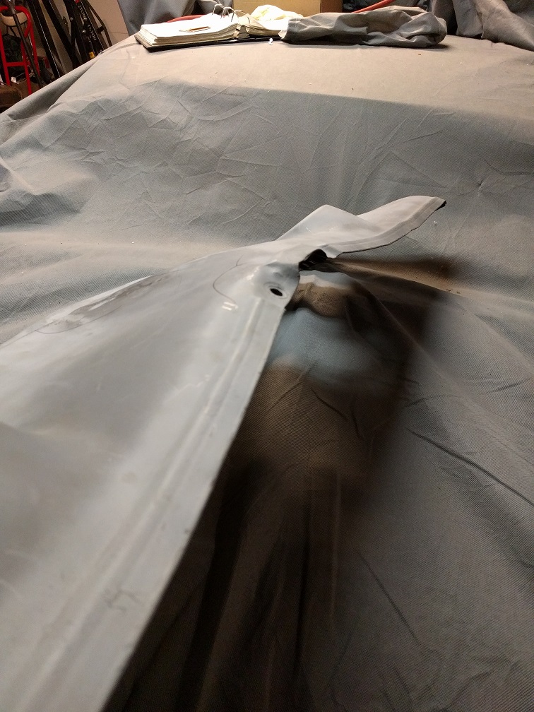

Good evening all,
After a nice break I'm back to fighting front end assembly on my 69. Please see the pics in the links, they are from my valance panel. The lower/bottom end is curved, I tried to capture it on the pictures. Is this normal? The top is straight and stiff but the bottom has a curvy bend to it.
I'm thinking that curve might be introducing a flex in the valance, which is decreasing the width between the fender extensions, which in turn is not "pushing up" on the fenders to the full extent that it's meant to, which may be contributing to the "droopy" fender.
Does anyone have a pic handy of the bottom of their 69 valance that I can compare with?
Any and all advice is appreciated.

Apologies- yes, it's a photobucket thing, apparently. Can you try these links?
http://littlebeginningschildcare.com/news/val1.jpg
http://littlebeginningschildcare.com/news/val2.jpg
http://littlebeginningschildcare.com/news/val3.jpg
Meanwhile, I kept searching and found an image on Ebay for a valance for sale, and the bottom looked straight (although it's hard to tell from the angle of the photo). I'll wait for some of you experts to weigh in, and I'm thinking of ways to straighten it if need be.

I think your valance has too much of a curve
Here is a few pics of mine. They arent direct shots but they kind of give u an idea

I am coming to agreement about the curve, it's not right. I wonder how it happened, as I'm not seeing any obvious accident damage. I suppose a few "kisses" with a curb or something might do it, who knows.
What I'm thinking about is to clamp that edge on a straight board (like a 2X4) and slowly bend it into shape, using the top edge angle as a reference. I can visualize getting it close, maybe not perfect.

The bottom of the valence should have the same contour as the front chin spoiler.
Its pretty much straight
I would get another valence panel it looks like it might be just a little too much work to straighten yours out
It may mess up other areas on it
I appreciate the feedback, replacing that valance (and the header panel) has been on my mind, being repro parts are more readily available. On the other hand, there's a ton of advice on fixing your old parts as they fit better than repro. Since I've gone through a chore of fitting a repro fender, I know exactly what they mean. That being said, maybe a repro valance & header are worth a shot? If I need to bend and chop something up, I'd rather it be a repro part.

it really doesnt hurt to try an aftermarket part some are better than others def.
the way your valence bows, i feel if you try straightening it it may mess up the parking light bucket curves then you will be in real trouble.
ive learned over the years that mixing original metal with aftermarket metal you end up having more fitment problems than if it were all original, all aftermarket.
