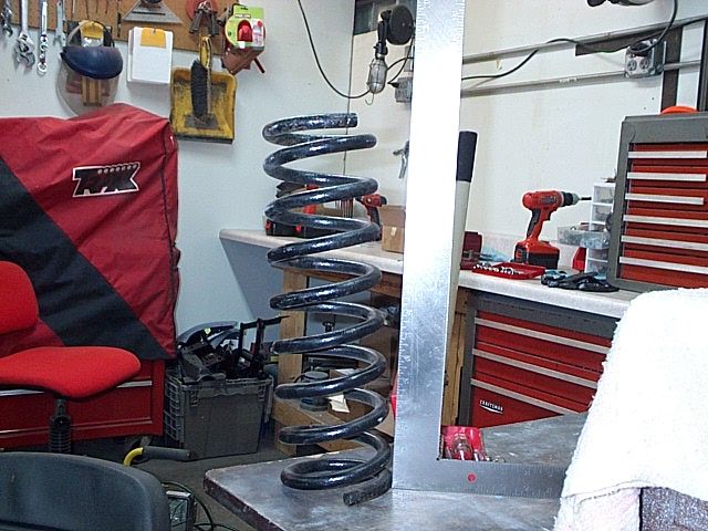

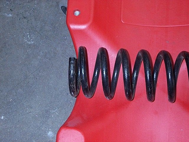

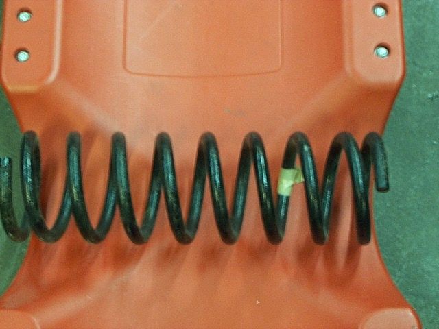

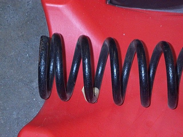

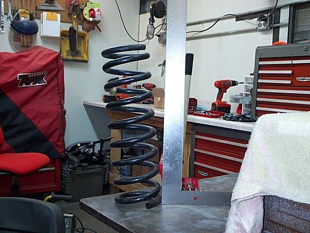

Trying to make this a bit more clear for anyone reading this thread as this subject seems to come up often. I dug out one of my old front springs and took some pics. Both ends of this spring are tangential. As you can see the spring will stand up, but not straight. There is no appreciable difference between the ends. Hopefully someone finds this info helpful.
Al, Thank you again for pictures and explanation. This is EXACTLY what my springs look like. I had hesitated even posting this topic again because I had done the searches and found that this question has been asked many times, but never explained in this detail. I've found this info very helpful.

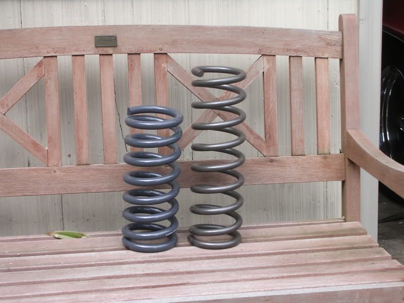

The same question has frequently been asked regarding the Hotchkis drop springs, and the answer seems to be install them so that "the Hotchkis lettering is right side up". Even Hotchkis responded that way as I recall. The truth is - on the Hotchkis springs I got - both ends are identical.
Here's a picture of a spring I removed (possibly stock but unknown) side by side with the Hotchkis spring.
