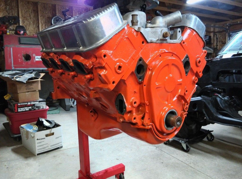

Sorry to hear that Kevin. Can you go over it with the Seymour? This is how it comes out. I did mine this past Sunday night.

Update on painting the engine. I ended up using PPG DP red epoxy primer and Omni Single Stage Urethane Paint. Since I was painting in my garage I mixed the paints and sprayed them with a Preval Bottle Sprayer instead of my Paint gun. I was very pleased with the result. The color I used was Hugger Orange and it is a very close match to the Seymore Orange Paint so It can probably be used for touch up later on. Hopefully this process will be worth the effort. Thanks for all the suggestions.
