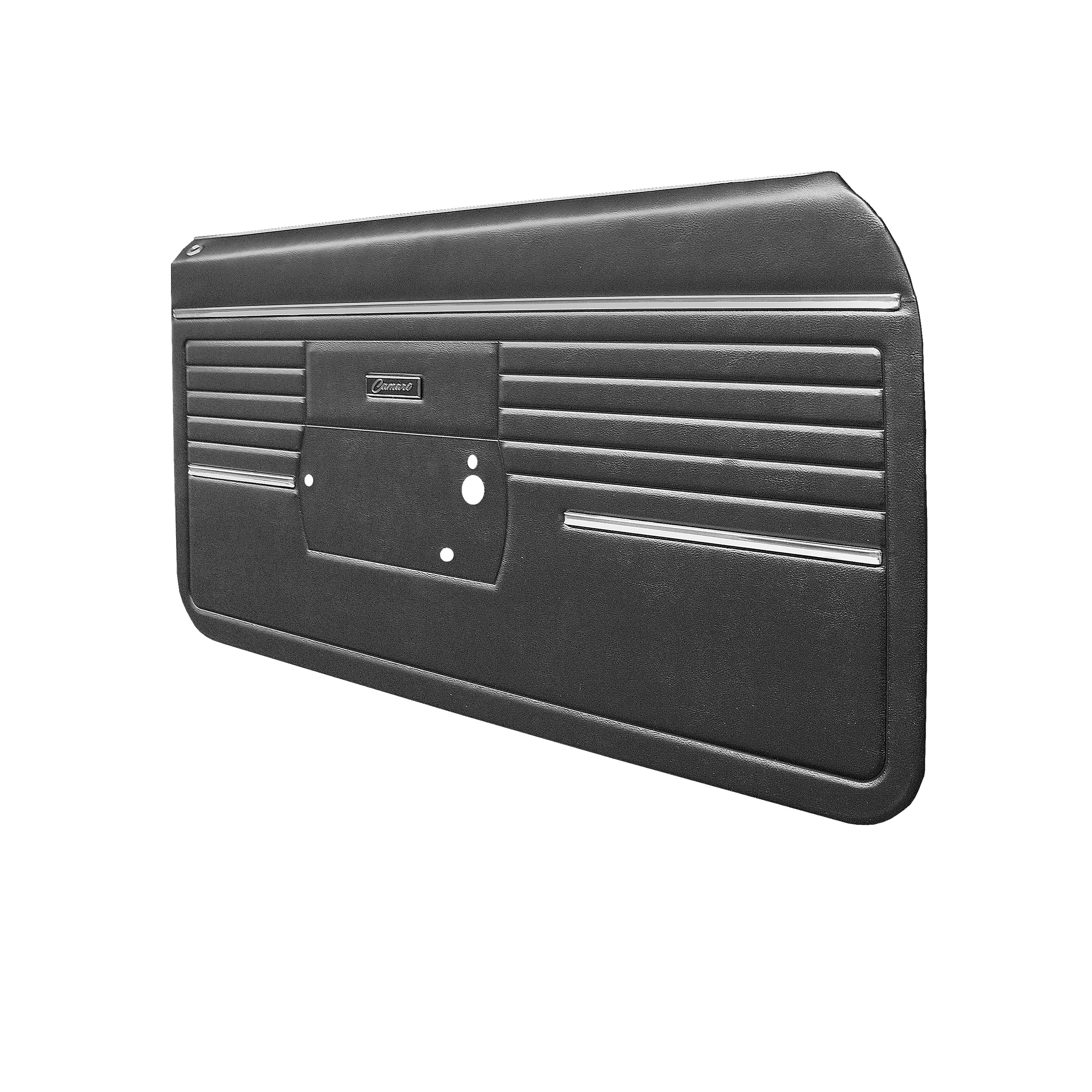

OP has a standard interior door opening handle.
So OP just needs to buy correct 69 standard door panels and install. :) The armrest and inside door are fine, but the window crank is a 68. The 69 cranks have a clear knob.

1969 had a unique one year only molded vinyl design, the OP's panel appears to be 68 standard vinyl. Why someone would go to this trouble, maybe they used what they had to create a usable door panel?
