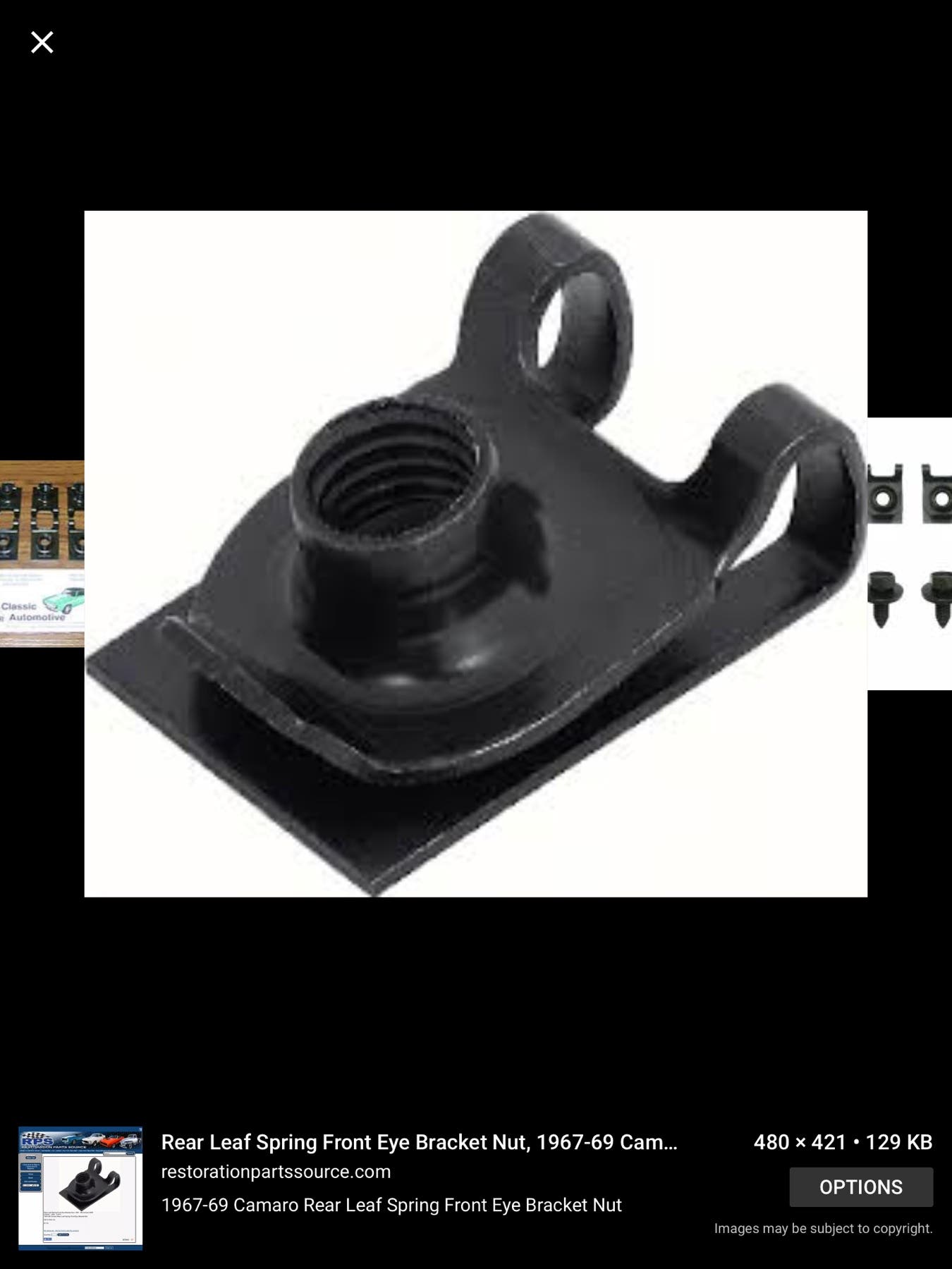

I'm about to install new rear leaf springs on my '69. I have the old ones off but the nuts were so rusted out they didn't tell me much. I wanted to confirm the orientation of the new nuts / clips when reinstalling. The nuts I have are like the ones pictured (hopefully that turned out). I see the 3 slots alongside each of the bolt holes for the front pocket. Do I slide the nut into each slot with the cone shape part inside the frame pointing up? That would put the bottom of the clip (with just the non-grooves hole) on the outside of the frame. Is that right? How does the clip stay in place when I start to tighten the bolt? Does the pocket / bracket push up against the exposed part of the clip to hold it in place? Just want to make sure I have the alignment right before trying to assemble. Thanks!

When you install the first clip you will understand what keeps them from turning as you tighten them. IMO these replacements are a better design than the originals as the original had a square nut in a clip. It didn't take much for the clip to break and the nut to spin.

My originals weren't the style with the attached nuts. Here's a couple pics of an original and the GM new replacements. Apparently they aren't all created equal.
Also, Here's a pic of them installed. Ugh... Hate remembering what that floor used to look like.

Those nuts are still available from GM. There was some discussion here on TC about some of the repro's being inferior.
The ones I posted a pic of with the GM bag and p/n are the ones that are still available. I bought them from a local GM dealer. From personal experience, they're the "good ones."
