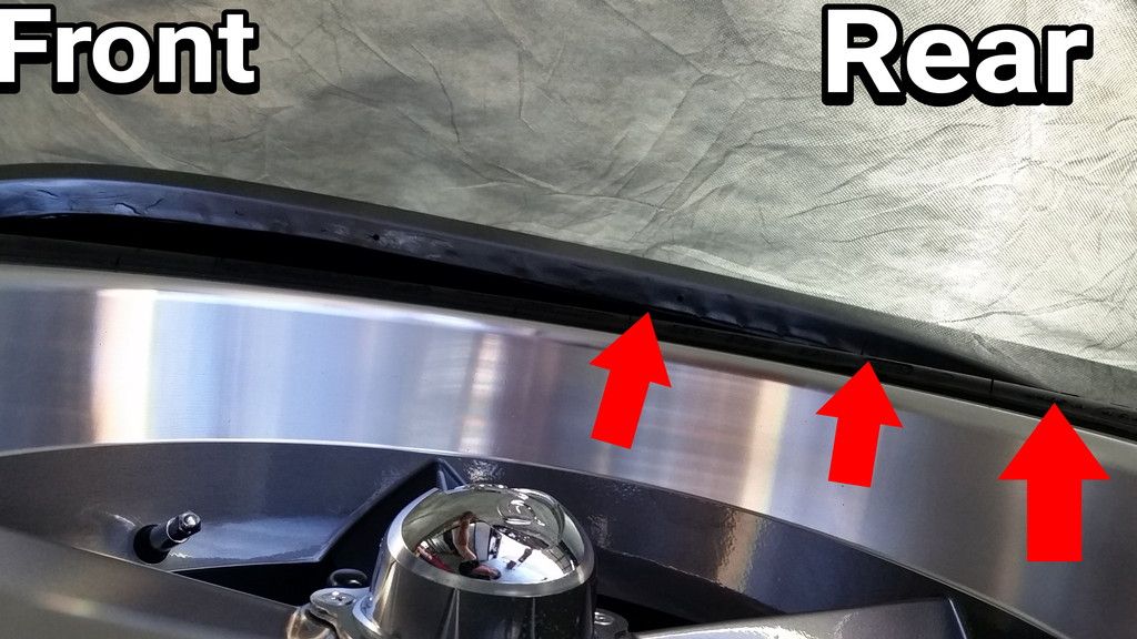

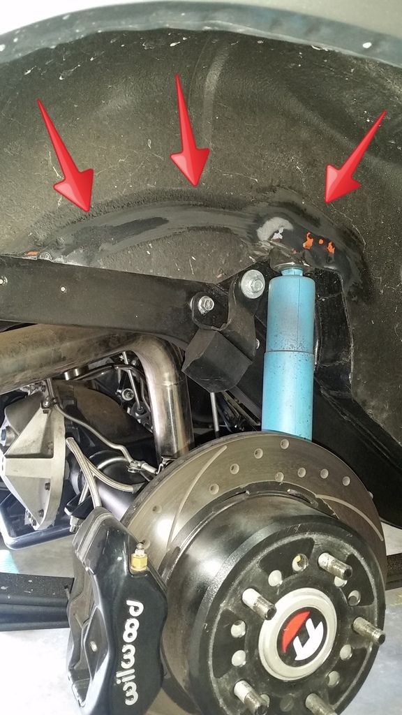

And looking up from below the tire, it looks as if only the rear of the fender needs to be trimmed. See photo arrows. Not sure about what you guys mean about trimming the 10 o'clock position.
* 2 o'clock looks like it's only giving me trouble since that's where the fender starts to taper back toward the rear end. (unless I'm reading the clock wrong.)

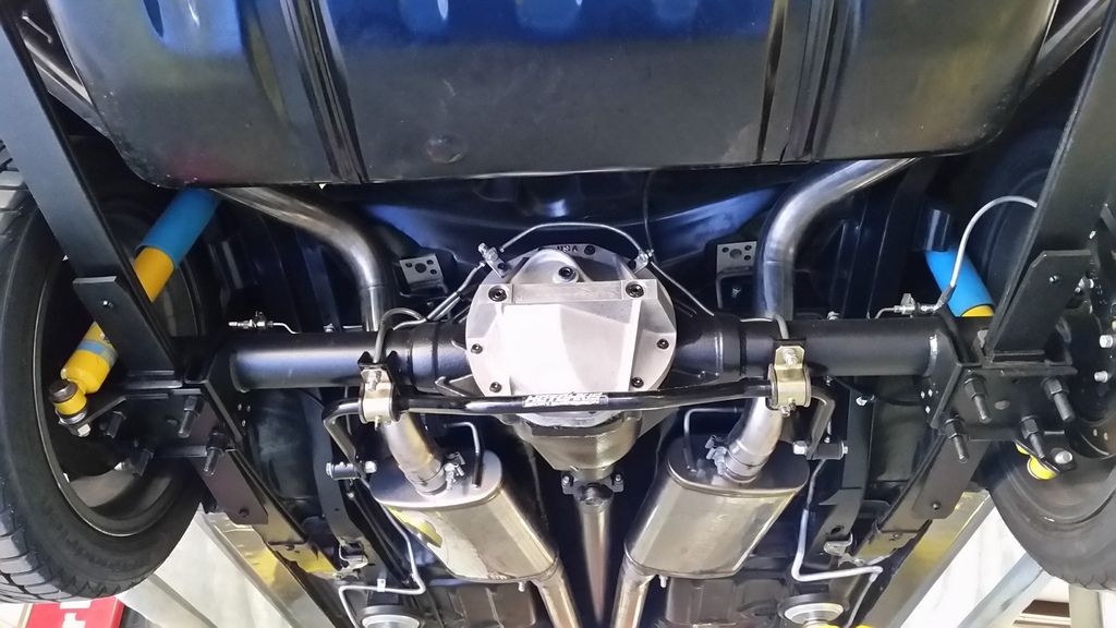

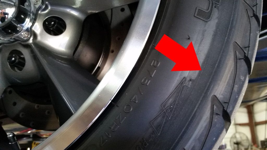

The fender scraped the tire a bit but some of the rub mark can be removed.
after posting that picture of the rear end we noticed a missing nut on the right side shock. went back out to the car and not only was it missing but the left side was almost about to remove itself as well. no idea how these came loose with a lock washer on both(?) we are now using locking nuts AND blue lock . Maybe just maybe that is why we had the rubbing issue ;^) we'll take it out for a test drive and let you know later

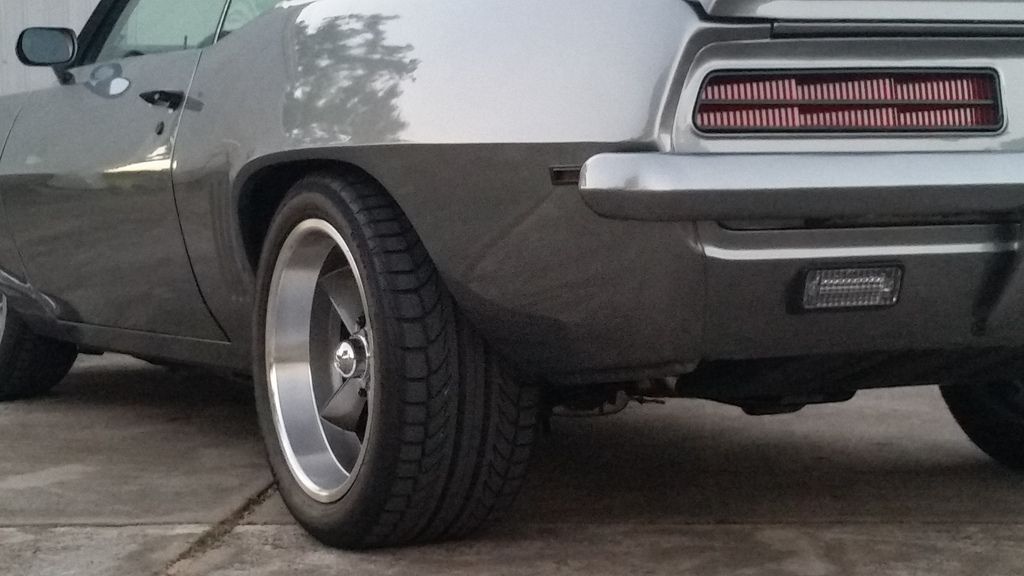

we got out the grinder and removed about .25'' of the fender lip. that took it to the edge of the spot welds leaving the welds intact. that's all we needed on the outboard side of the tire, no more rubbing issue. Now, the real problem is the inboard side of the tire rubbing against the tub. (see pic) . this only occurs when going up or down a steep driveway no matter how drastic of an angle we approach at. we may look into an 18x9 in the rear, unless there are other suggestions.:frown2:

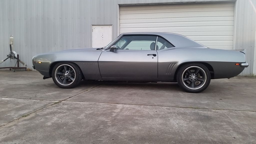

Could you post a pic of the ride height?
Try approaching the driveway straight on so both wheels move up the same distance at the same time.

its 3 years later and i forgot to mention how i fixed this problem for good... i stretched the metal at the inner fender well with a rivet gun and a flat 1-1/2'' rivet set. I merely massaged the problem area and then resprayed the undercoating! Works perfect now. only needed about 1/4'' more room and gave it about 1/2'' more room. looks perfect and I don't have to grit my teeth and close my eyes every time we go up/down a steep driveway . I have since put about 2000 miles on the car with no issues.
