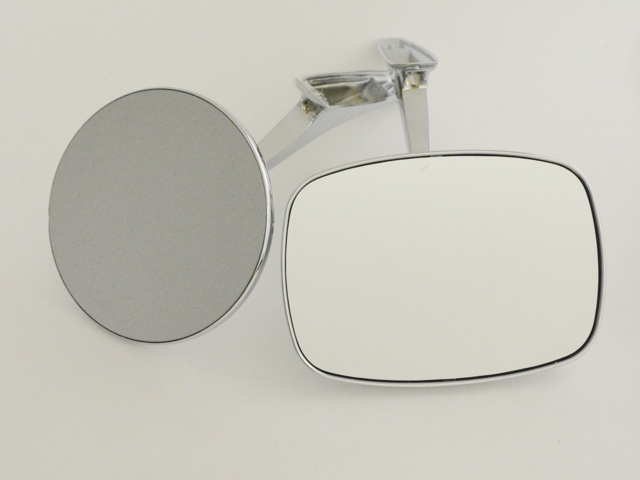

Has anyone installed Billy's Clear Shot V2 Rectangular mirrors on a '68 that has the "ledge reveal molding" on doors? I'm emailing w/Billy & Sarah now, and they said I'll need additional spacers to make it work. I'm just looking for photos of this setup so I can see what it does to the installation & appearance. Only thing I can envision is "double-stacked" spacers raising mirror base off the paint & showing a "gap" with whatever the spacer material is.
Appreciate feedback from anyone who has them like this.
Thanks
I’ve been on phone with Billy a few times today working out an “as found condition” with my car. Long story short, base plate of current mirrors on my car is longer/wider & existing holes in door can’t be covered by Clear Shot standard base or with the spacer. So Billy is having a machinist custom fabricate a base/spacer that will allow me to install Clear Shot mirrors AND cover the extra holes left behind from old mirrors. Great guy to work with for sure! You won’t get that kinda service from a “parts house” type vendor.
I don’t think he’ll mind, below are the photos they sent me of the spacer for use with reveal moldings; and a Clear Shot mirror installed with one.
When I get my custom installation complete; I’ll post up a thread so all can see photos.
Mirrors that came on car were useless; couldn’t see anything. Billy’s Clear Shot mirror eliminates common blind spot. He’s a 1st generation Camaro owner & designs products to solve issues with his.

It's nice that you did a one off peice to solve a customer's problem. I was under the impression that this spacer was to gain clearance between the mirror and door reveal molding. Do you also have one for this also and what does that spacer look like?

The UHMW spacer is only needed on the 68 Camaro with reveal molding.Sometimes customers need the Patented UHMW black spacer so the mirror will adjust inward enough to see the lane beside them because the inside of the mirror hits the reveal molding.On all other GM cars you just use the stock gasket.We also own a stamping die set that makes the door bracket almost the same as a GM stock one except our bracket is thicker and has slots in it.
