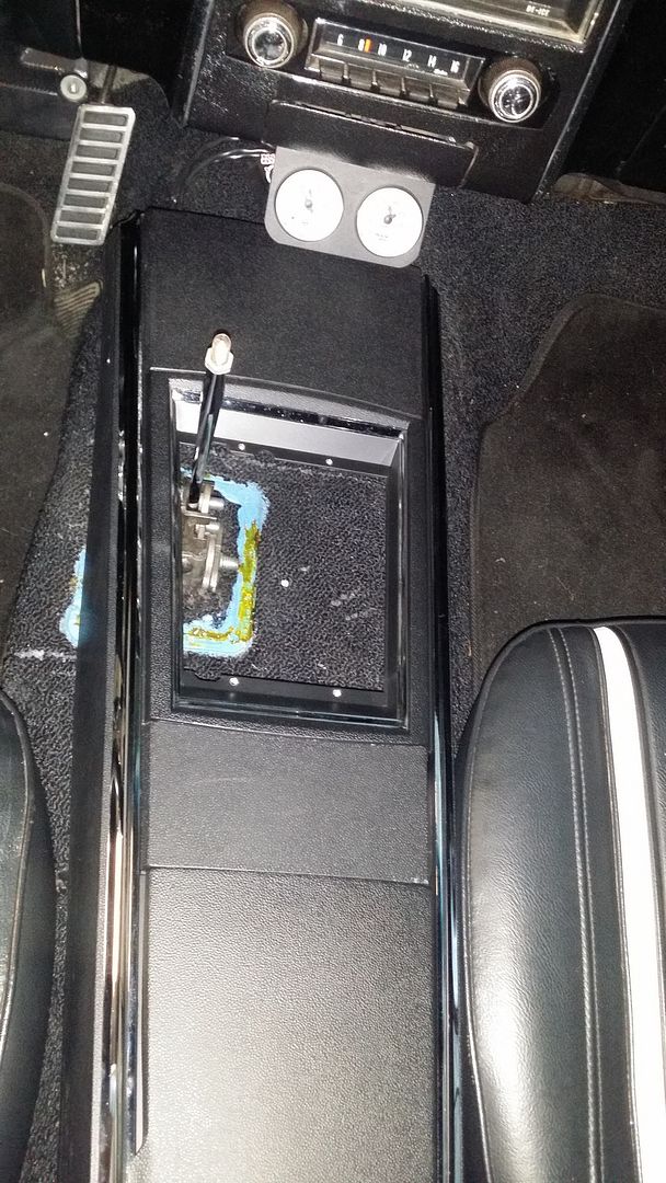

I can't tell if its the picture angle but that driver's seat looks out of place, is it stock? It looks like the seat position is preventing the console to be centered over the transmission tunnel. Can you provide a picture looking down the tunnel from the back seat. The cutout should be almost centered between the front seats, but closer to the dash, almost at knee position. Cheers, fred
It's and new seat cover and cushion I believe, on the original seat frame that was reconditioned.
The cutout definitely is NOT centered on the tunnel. It is to the left side...
The center of the shifter boot is 2.5" to the left of center of the tunnel for some reason.

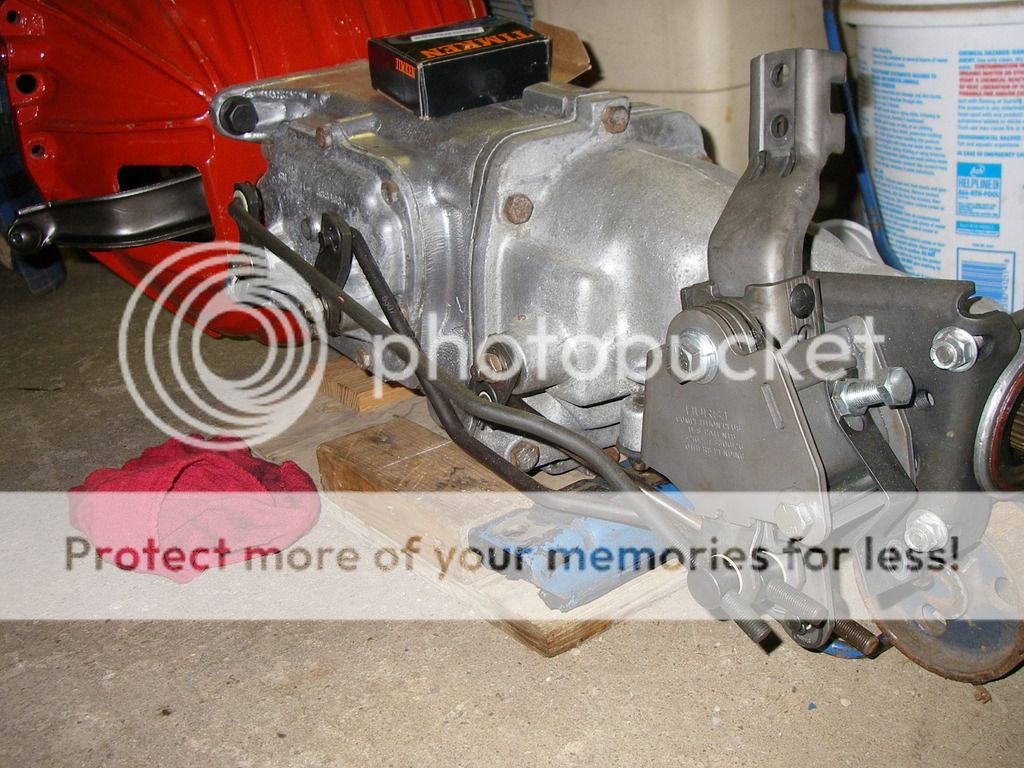

You say you have a 4 speed transmission is it a Muncie or a Saginaw? It doesn't matter because a Muncie shifter was used on both. If you have a Hurst shifter then that means it has been changed. This is the reason you didn't have a console already installed. If you decoded the tag on the firewall did the car come with a console? How about a picture of your shifter mounted to your transmission? So you need to Identify the type of transmission you have. Then get the correct Hurst shifter to fit the console.

The hole seems to be too far left along with the shifter. That's why the console looks crooked in the pic. It fits between the seats fine.
Why would the restorer buy the incorrect shifter and have to move the shifter hole to the left, when he could have bought the right shifter and not touched the hole? Seems like a bad choice.
Does anyone know if Hurst makes the correct shifter (part #?) that would fall in the middle of the tunnel? Then I can have the hole opened more towards the center and use the console.
