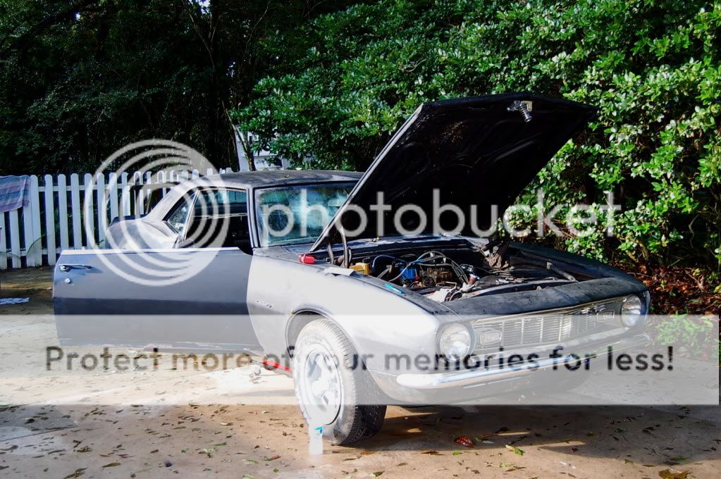

Build update, after 2 years and 3 months she is 99% done. We did everything in our garage, except for the media blast, which was a waste of time and money. Couple things are left, like 3 inch lowering springs for the back, change the gearing and a few odds and ends. But it is road ready the way it is. This was our first attempt at doing anything remotely like this. Couple things I would do differently if I had it to do over. Every thing custom we did to her came from reading about it here on the forum such as, smoothing everything we could, door handles, locks, firewall, front fender ends, front valance, cowl, molding in the rear spoiler, placing the windshield wiper motor behind the firewall, etc.etc. The forum offered incredible information. Anything we thought of some one else had already done it and written about it. The only thing we did by our own design was the front grill. We used metal screen and molded it into the old grill after cutting out the center piece. We wanted a deep black hole effect to look like nothing is there. Couple things I learned along the way: what smoothing meant, how to weld, how to paint, how to block sand, 12 new cuss words, reproduction pieces don't fit, a good paint gun is worth the money, there is always a bigger hammer when it doesn't fit right. Thanks for the wealth of information you guys have contributed over the years for novices like ourselves to learn from.
