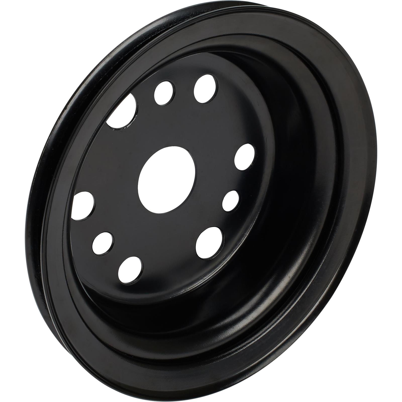

I have a 327 SB Chevy Camaro Convertible. Belt pulleys don't look like they will align.
I have the Short Water pump. The PS bracket bracket has 3 engine mount bolt holes. Is the bracket correct?
I ordered 2 pulleys that were for this car, but they don't line up with the Power Steering pump pully by about a half inch. Did get the wrong crank and water pump pulleys?
Both the pulleys I have are doubles.
The power steering pump mounting bracket is installed under the engine mount as designed. I think the Water Pump pulley should be a single type based on the Camaro assembly manual in UPC 6 A. What pulleys do I need and what parts book has them?

Looks like you don't have the 3rd groove add on power steering pulley on front of your crank pulley. I can provide a part # later. You need to know if you have deep groove or standard pulley because the add on pulley is different between DG & standard.

OP, my 327 came with triple pully for crank and single for WP. I used the same pulleys for my BPE motor, short WP. The middle groove on crank pully is not used. I assume it was for either AC or Air Pump, IDK as I have neither. Front groove is for PS mounted as yours is.

Crank 3rd add on pulley standard depth groove is GM # 38744161. Deep groove 3rd add on pulley is GM # 3916385. They are not interchangeable even though they will mount up, if you use the wrong one they slightly hit each other. You also need slightly longer bolts to mount this inside & in front of your 2 groove crank pulley into the 3 holes in your balancer. This is the deep groove set up & utilizes a cast deep groove PS pulley. The standard groove uses a stamped steel PS pulley. It also shows the HP Z28 PS pump saddle bracket that uses the 2 holes next to balancer and the seperate rear PS pump bracket that attachs to engine mount.

Mine is not deep groove. The Add on Pulley is $173 at National Parts Depot. Is there another place that would have it cheaper? Is is at National Parts Depot part #C-0659-10 for $173.03? Thanks.

Where would I get this pulley? Is that pulley you have really two pulleys? I looked in several popular Camaro Parts catalogs for it and cant locate a duel pulley with that space in the middle.
#16 ·
3751232 and 19355268 interchange. 3751232 is available all over, for around 30 dollars.

OP, my 327 had, now on my BPE 355, the stock 1 piece 3 groove pully. car was shipped to CA originally so I believe it "may" of had a smog pump, IDK. However it also did have what appears to have been dealer installed AC as there are 2 holes, now plugged, in firewall where a under dash AC unit lines were run.
My point is GM did make a 1 piece 3 groove crank pully. Currently my center groove is not used. I have PS using the front groove and Alt/WP using the back one.
hard to see, but this is pic of my 3-groove pully
