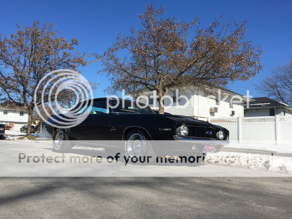

through the years........
'69's always look awesome in black! :cool: Love the white interior too... Definitely keep it that way. :yes: Good to see another Long Islander on here. I grew up out in Farmingville...:beers: Have fun with it and welcome to the site.
No she was a light blue with a blue interior I'm the third owner I believe, so the original owner must have painted it , he also put 327 badges on it and when I ran the numbers it's a 307 which is harder to sell around here, basically giving the motor away ( selling everything that's not nailed down to finance my tranny build up) he did put a real steel cowl hood on it though so that's good

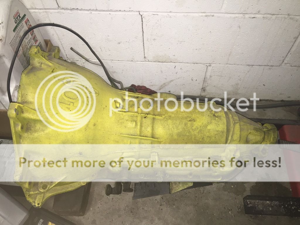

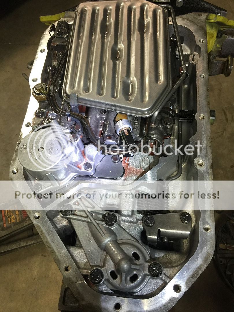

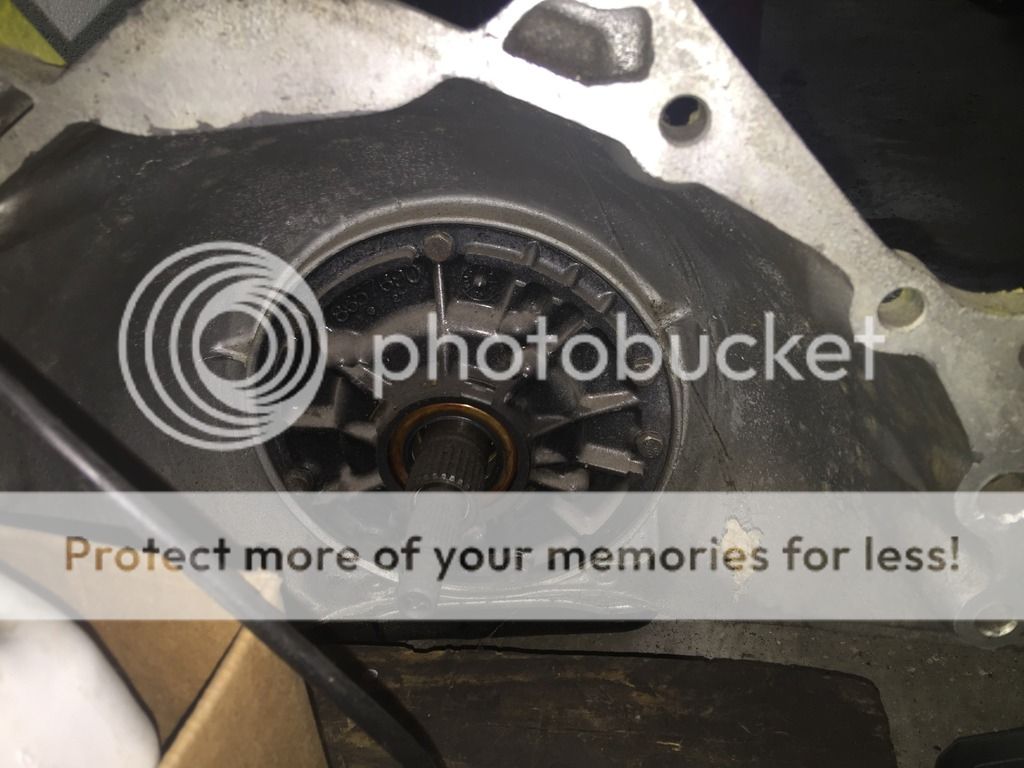

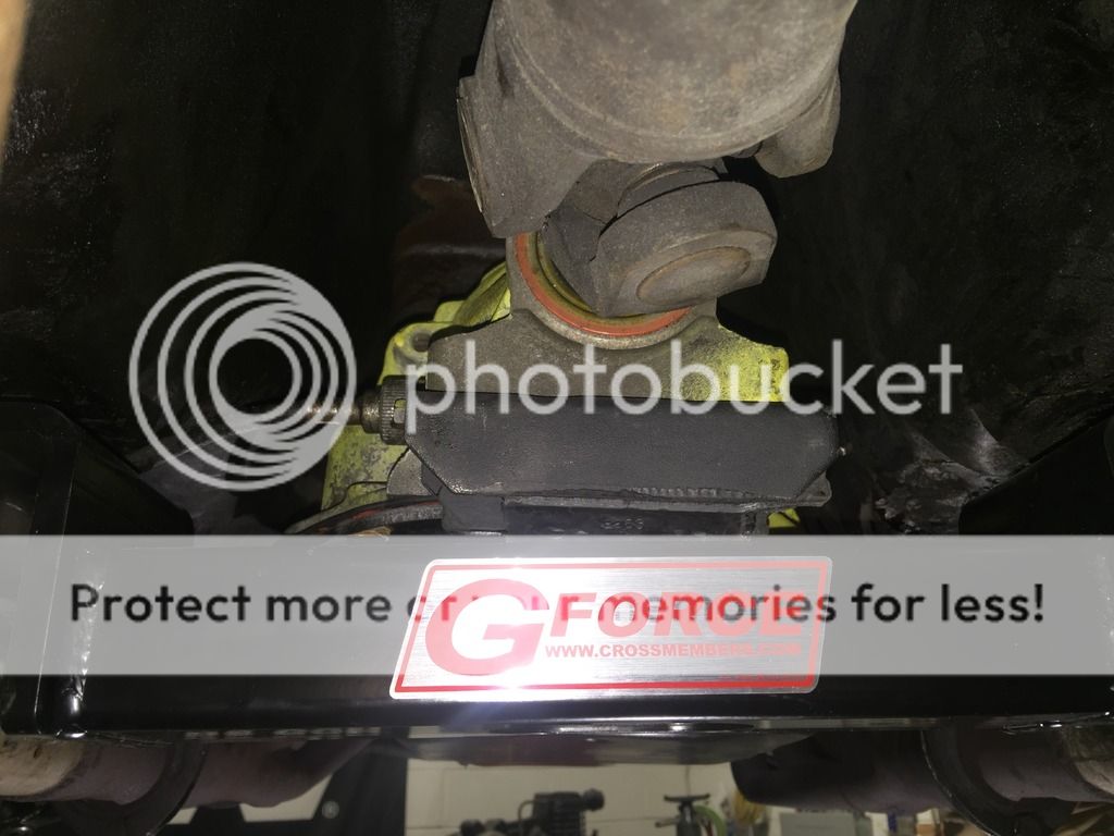

Been getting lots of great info on here lately. Just wanted to update my build thread

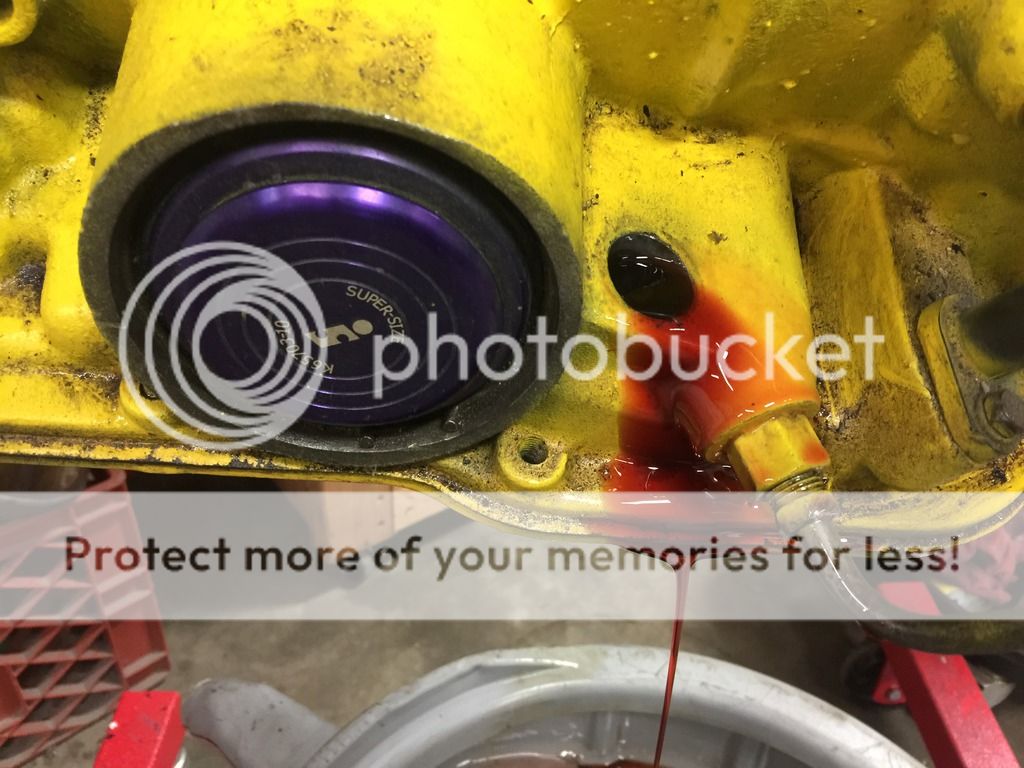

decided to go with a 200r4 that I found through a good friend
the servo is a sonax super hold with heavy duty clutch packs

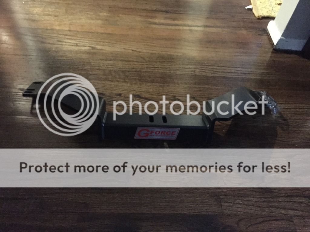

went with the g force cross member

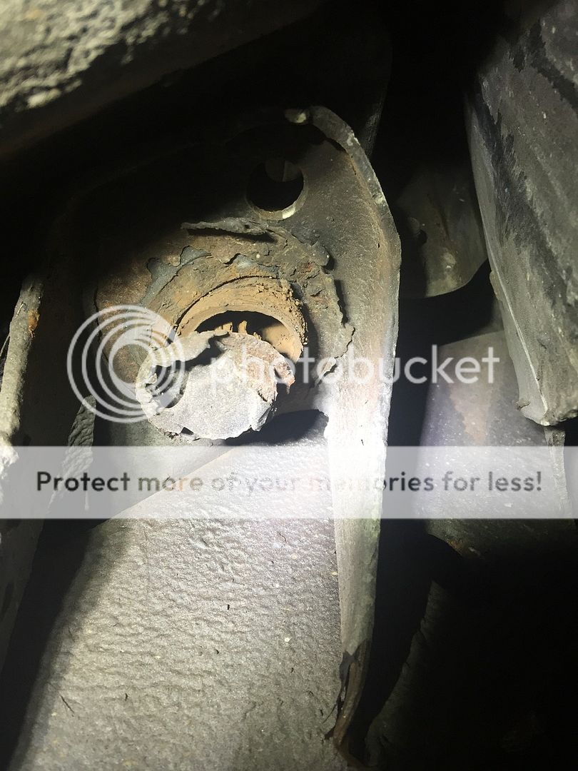

once the car was on the lift we realized the bushings,well some of them weren't there any longer and the others were shot.
went with energy suspension body bushings
http://www.summitracing.com/parts/e...arts/ens-3-4142r/applications/year/1969/make/chevrolet/model/camaro?prefilter=1
ordered my tv cable, lock up wiring dip stick inspection cover and 2400 stall from bowtie overdrives. Shift conversion I bought a few years ago from shiftworks
Cant wait to get the car back together. Might look to do the fi tech fuel injection by the spring too

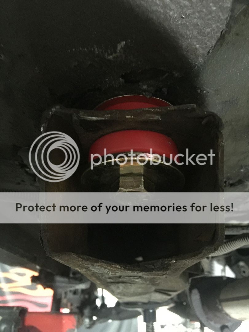

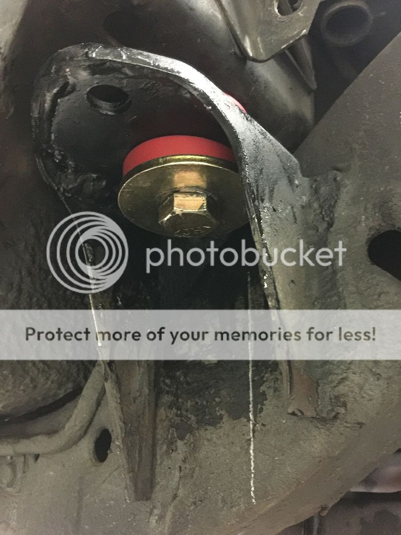

Found rot where the holes for the bushings are purchased the plates to repair it and new cage nuts as two were totally wasted from Muscle car headquarters here in Long Island.
Also going through the parts we realized an important part missing in the tv system kit. The vendor is shipped it so were waiting. A few setbacks but hope to have the car back next week.
#20 ·
Cars all together just waiting on fine tuning the tv system and making sure the car is shifting at the right pressures. Should have it back next few days can't wait

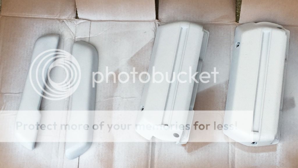

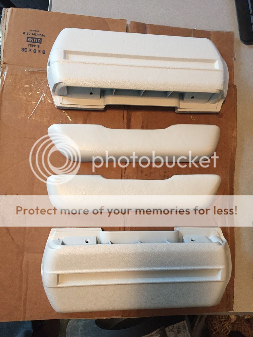

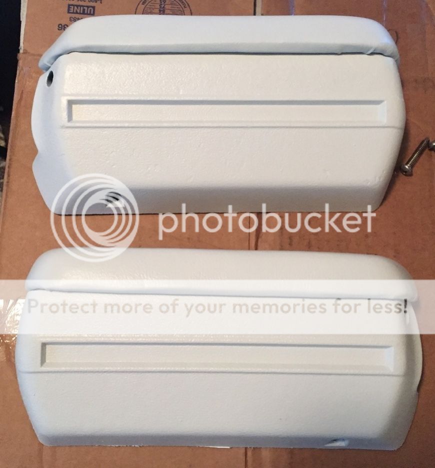

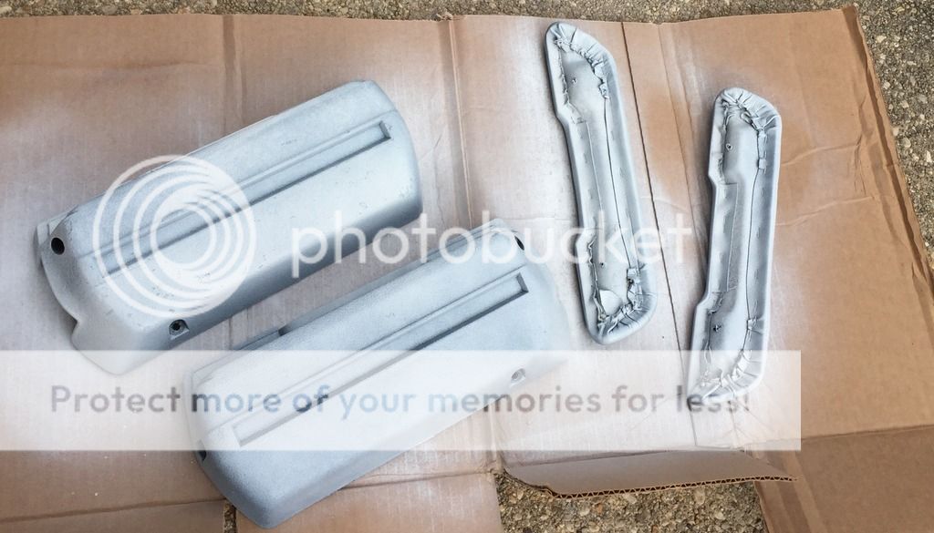

Had this set of armrests laying around NOS with nice pads for the last 10 years. Put them on ebay figuring ill use the money to put toward buying repros. After getting no bids and seeing the prices of repros I decided to take a shot at restoring these and changing the colors
Took them apart and cleaned it thoroughly with alcohol. I didn't use adhesion promoter
sprayed the bottoms and edges first
let them dry good between coats
looking foward to getting them on the car. Should have her back tomorrow night.

Went to pick up the car not ready yet. Tv system adjustments still needed. We changed the oil pan gasket and she was pissing oil all over the place. After dropping the pan we realized the 1 piece rubber gasket was defective. Replaced it with a new one and the leak is gone. Should have her back later today.

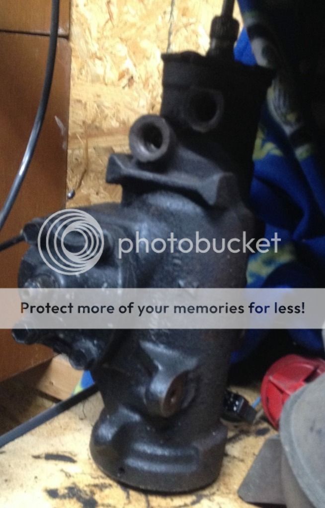

Starting to gather the parts for my next project ( after the oil leak is fixed ) 1987 Iroc quick ratio steering box bought with money's got from selling my old th350 crossmember. My car is a factory power steering car.
Trying to get a parts list together
So far:
Rag joint MotorMite Part #31011
Trying find the fittings now that Lee manufacturing is gone.
Not 100% sure I need a new pitman arm
So much to read on the topic.
