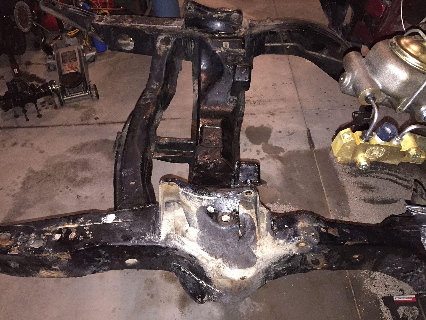

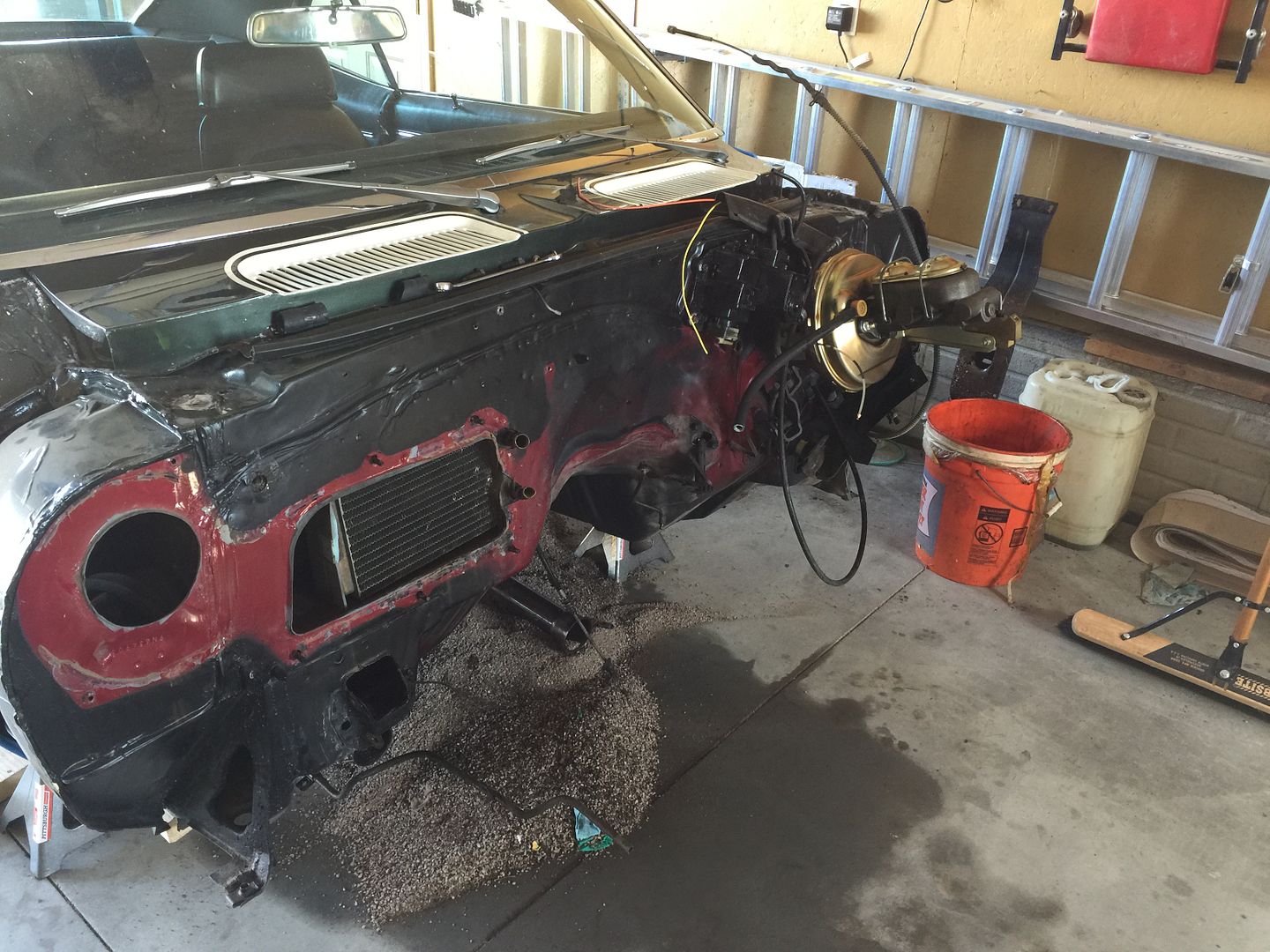

More tear down last night. Subframe is ready to come out.
A quick question for those of you that have pulled a subframe out before. I was thinking of just putting a 2x10 under my jack stands and setting it up against the floor. I think that will be fine. Thoughts?

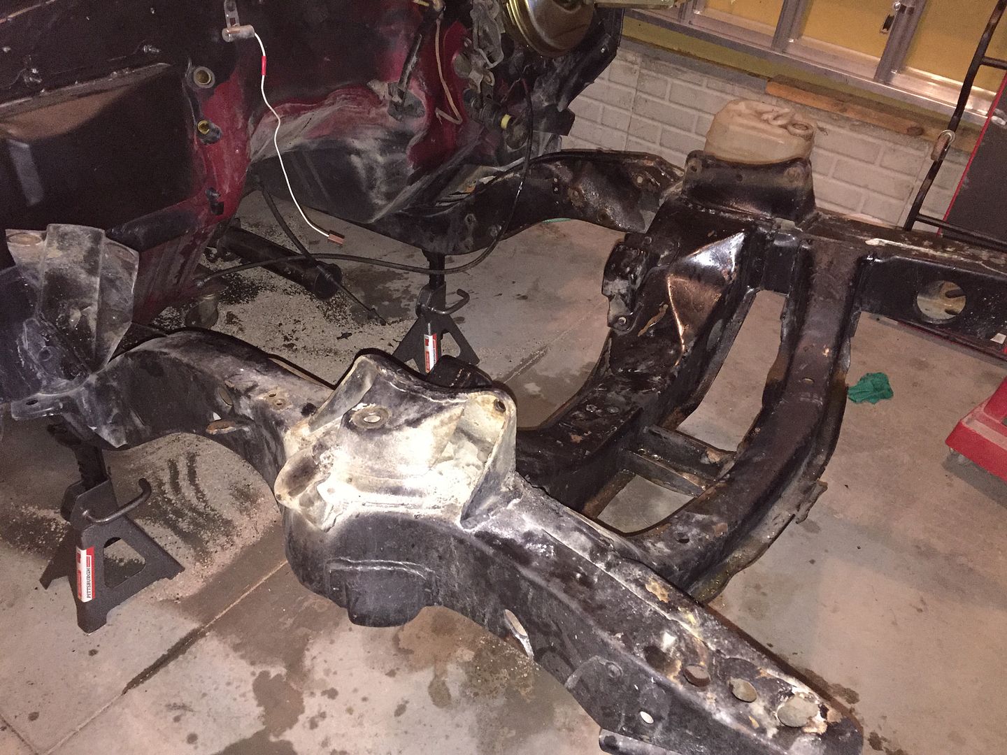

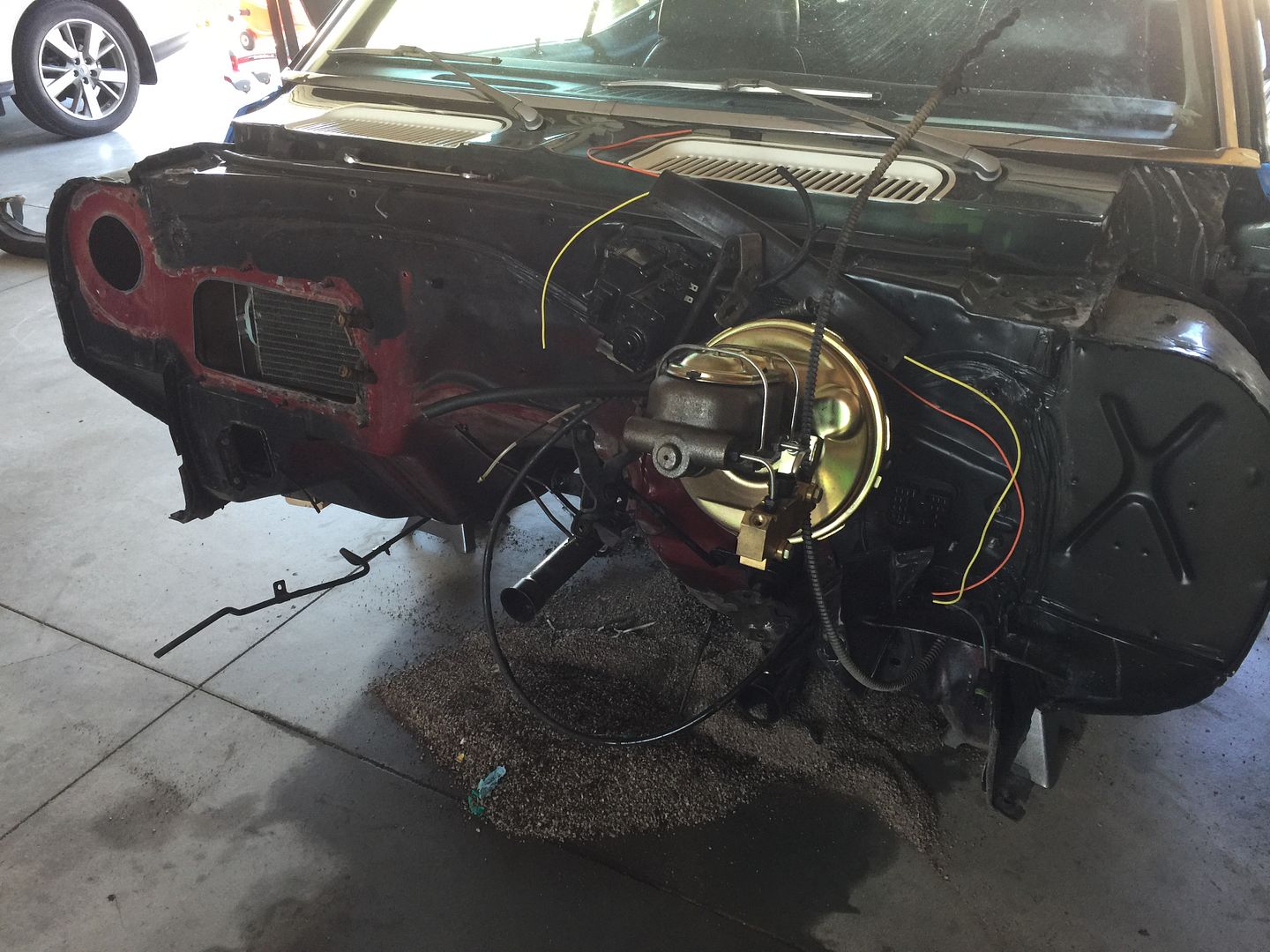

Made some more progress today. Drilled my new A-Arm mounting holes for the Guldstrand Mod. Then I pulled the subframe all the way out. I also was able to sell my old 355 which cleared up some garage space and will help me be able to do a couple things that I wasn't sure were in the budget.

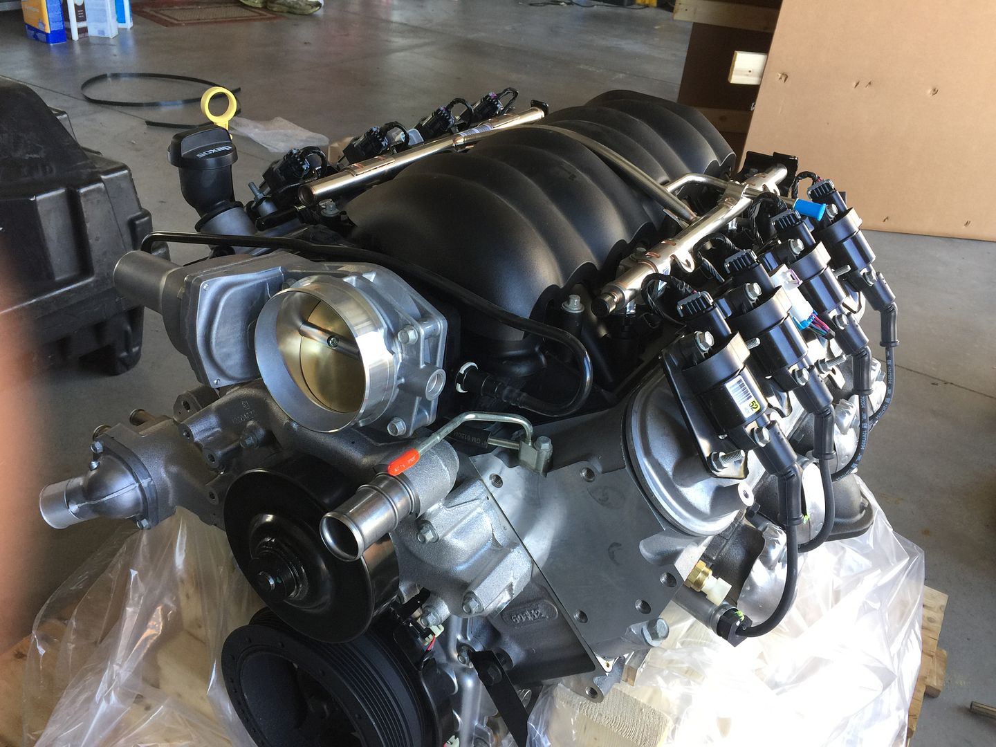

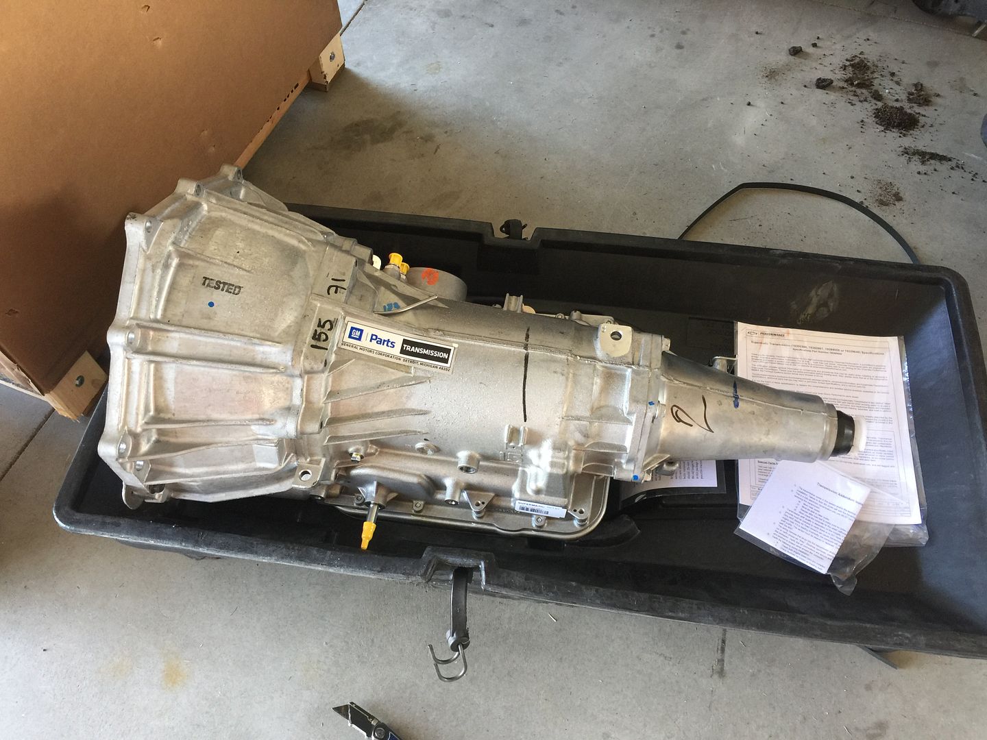

So today was Christmas in September. Got a bunch of stuff in today.
LS3 480
4l70E
Transmission controller and harness
Engine harness

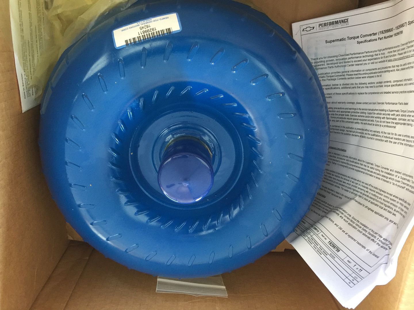

Torque converter. I need to call in this because the part number on the converter doesn't match the part number on the box. Box says 19299803 which is correct but the converter says 19299811.

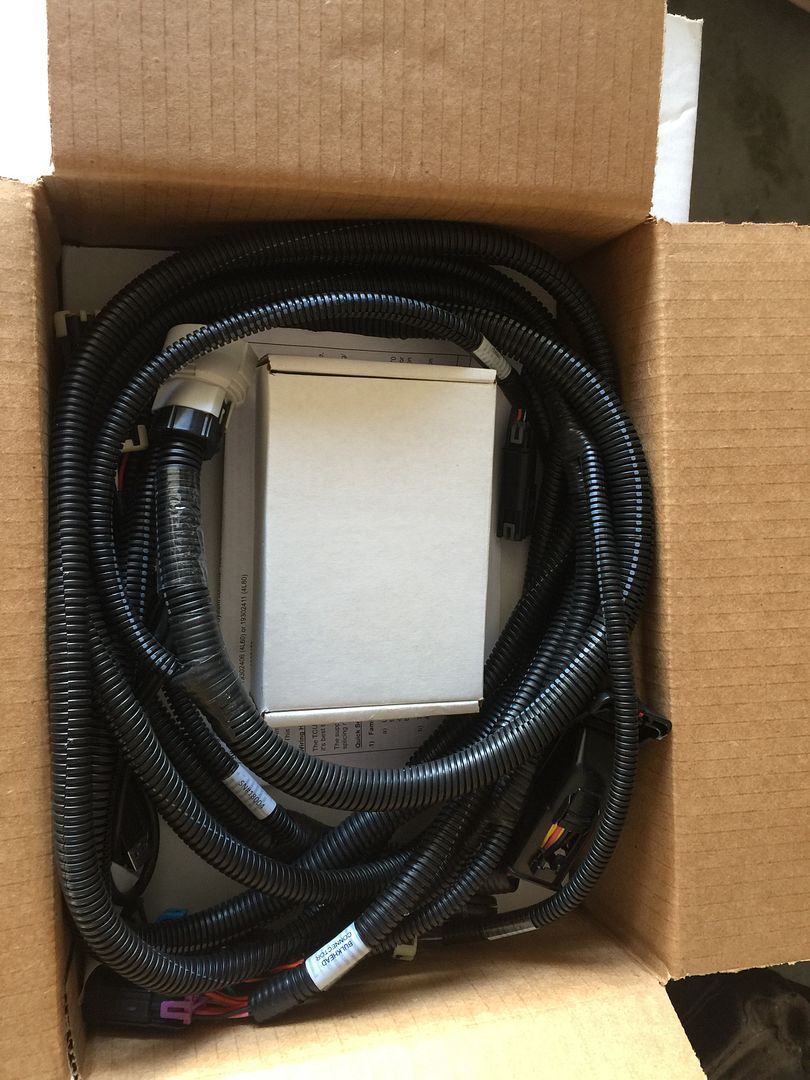

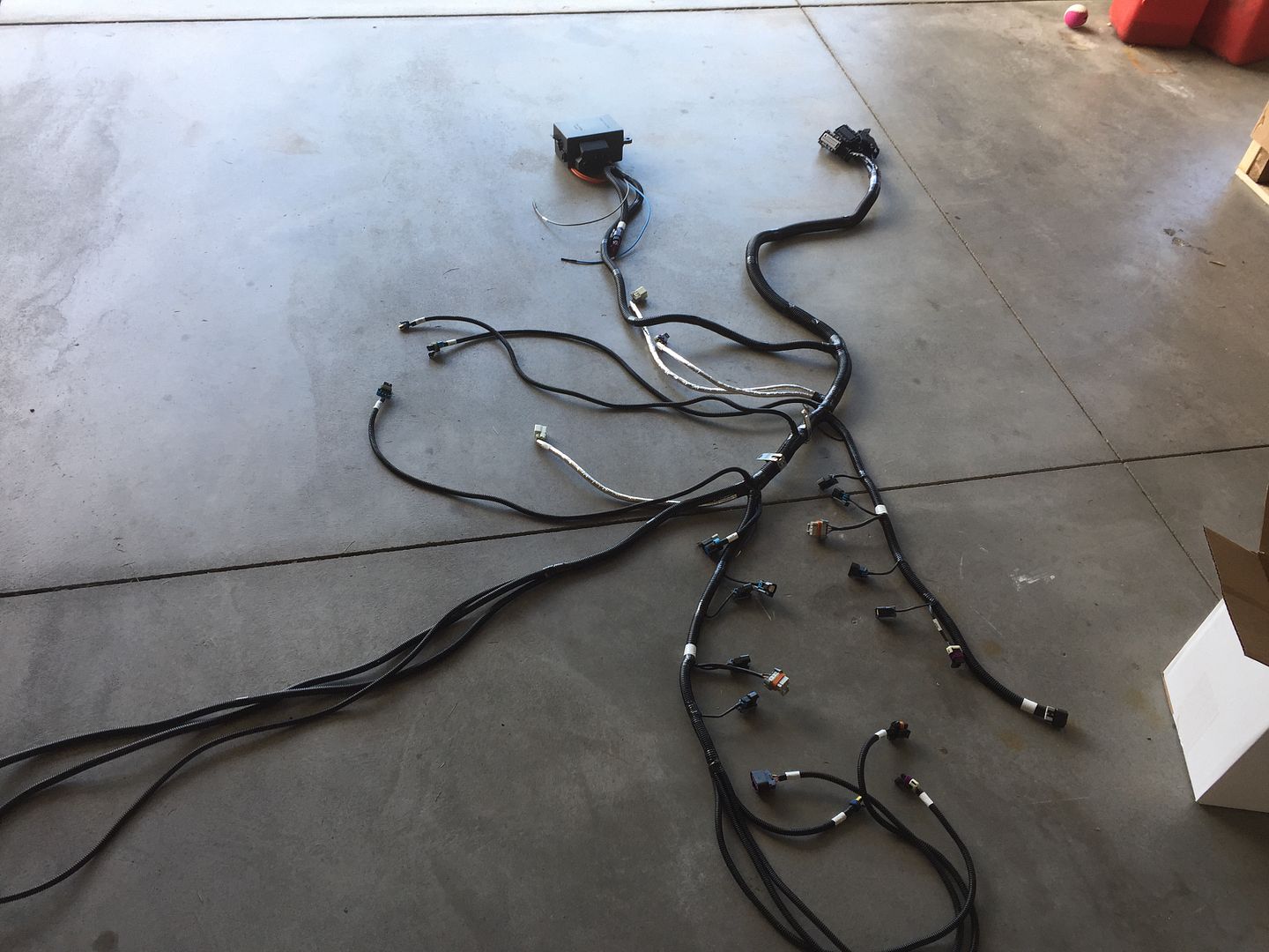

Just wanted to add that I am pretty damn impressed with the harness and how everything is labeled. Very few connections to hook up and good instructions with it. Hopefully by the end of next week I am ready to paint my firewall and have my subframe powder coated and some stuff can start going together. I am still waiting on my vintage air as well. Lots of work ahead but I am hoping to have the front suspension together with the subframe back in with the engine and transmission mounted before it starts getting too cold because I know when that happens I won't be working in the garage quite as much.
#38 ·
I have the GMPP harness. I'm sure the PSI one is nice as well, Vegas would know. The GM one is very well laid out and everything is neatly labeled. I think one advantage of using an aftermarket type harness would be that you could have them make the computer mount wherever you wanted. The GM one you are limited to a certain extent.

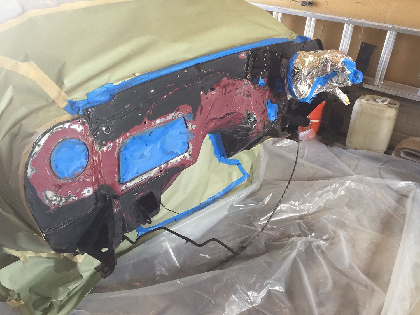

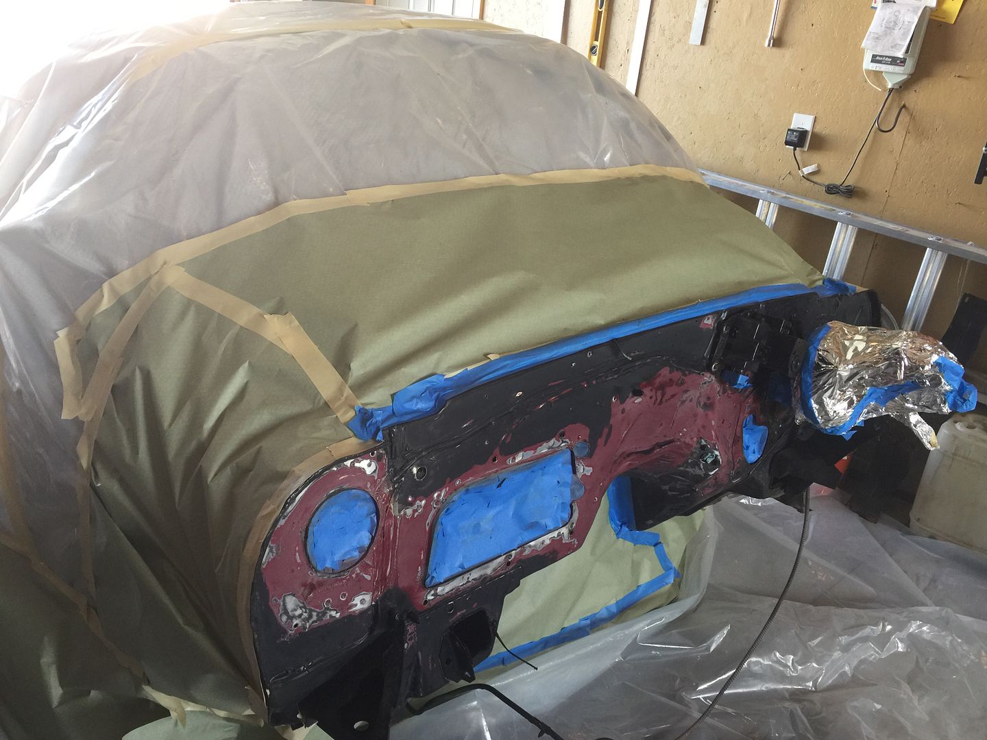

I took my subframe over to get blasted and powder coated on Friday. They are backlogged so it may be up to 2 weeks before I get it back. I also spent a couple hours getting my firewall all prepped for a fresh coat of black on it. I will shoot that today after work.
After getting the firewall painted I am almost at a stand still until I get my vintage air or my subframe back. I probably will put a fresh coat of black on my inner fenders while I have them out even though they look like I just painted them. As I was told from the time I was little. Do it once, do it right.
